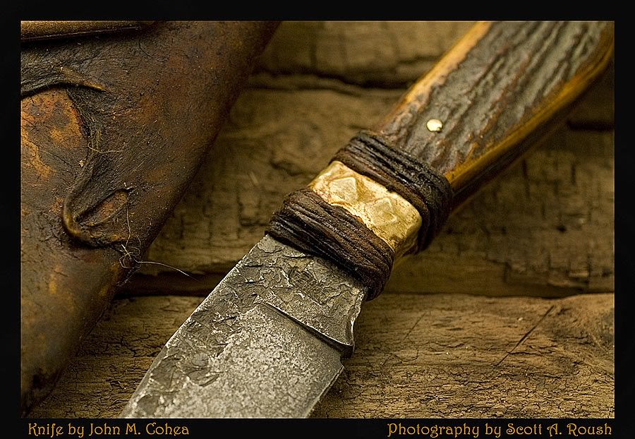

Here's one with a combination of bleach/ferric etch and forge texture.The texture is done with a special made hammer so that it resembles rasp texture.
Here's a damascus piece with the same rasp like forge texture.

Whatever you do,DO NOT mix ferric chloride and bleach together, it will create VERY deadly gases!!!I hang my blade in a container of ferric and soak it for say 10 minutes or so, then hang it in a container of bleach.It is the same thing as using cold blue, the ferric acts as an activator for the bleach.I usually let it work in the bleach for 15 or 20 minutes, take it out and clean it, then repeat for 2 or 3 more cycles until I get the finish I'm after.

YES... John is right. The blue/bleach creates poisonous gasses as well. Make sure you let the blue dry completely before dipping into the bleach or it will just wash off in the soak. I keep a bucket of water a few meters away from my bleach tube. The blade comes out of the soak and into the water, where I wipe it down under the surface. This dilutes the reaction so you aren't breathing in the gasses as you clean it. Never in an enclosed room!
