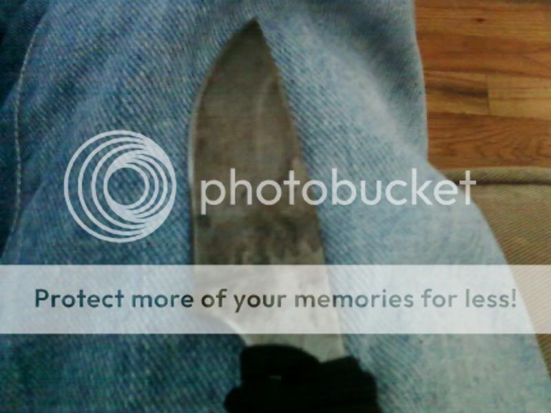

It's easy guys. Just start drinking a lot of Corona. Cut the limes with the knife you want to patina. Don't wipe the blade til you finish the first beer. Then wipe it and cut another slice for the next beer. Repeat. I got some nice color on my RAT Cutlery Izula prototype this way. It's 1095 not D2, so ymmv.

Ok, here's some pics of the Corona lime patina on my Izula prototype.
