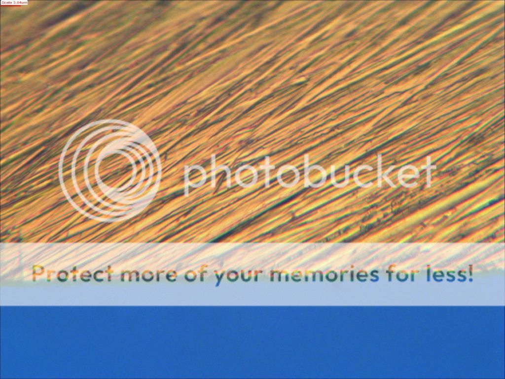

Nice HH. I find that if they are lit correctly, shots of the bevel can still be useful, but they need to be lit in such a way that good contrast is maintained or increased. Here are a few examples.
Edge finished on a Japanese Natural water stone:
HSS edge - attempted finish on slurried coticule - extreme carbide tear-out evident:
Another HSS edge finished on Suehiro Gokumyo 20k, again massive carbide exposure due to the abrasive being unable to cut the carbides - perfect demonstration of why HSS should really be sharpened with diamond or CBN:
