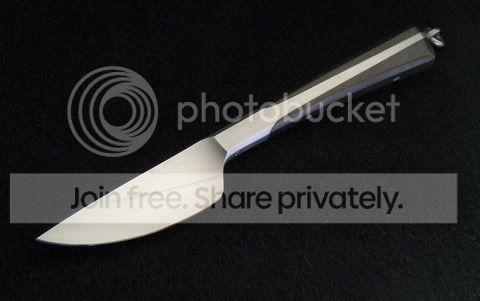

It’s about 9 inches OAL forged from ¾ inch round W2. I used “Godzilla” to start the shoulders on either side of the bolster area, and then finished them up freehand. Godzilla was made by Ray Richard, and is a nice alternative to forging the shoulders freehand or using a guillotine. I usually start the shoulders freehand, but liked using Godzilla too. It is a bit easier to master than the freehand method, and a little easier to make than a guillotine.
Godzilla chews on steel!
I did use a bench grinder, just a little bit, as part of the overall forging process (during the forging process), to grind out any “ears” and to sharpen up the profile towards the end of the forging process.
Here it is in less than 1 hour of freehand filing. I generally spend more time forging than filing on something like this. However, the more accurate the forging the less time needed on stock reduction. So, in the long run the forging saves me a lot of time… and steel.

How thick is the steel used in Godzilla, I think I'd like to make one. Great job on the forging, cool looking blade. Folks like yourself, with supreme forging skills, can get away with using files. They made grinders and 40 grit ceramic belts for guys like me. :)
Mike,
I haven't taken any measurements on Godzilla,... maybe Ray will chime in with more of the specifics.

This is a real simple tool to make. The tool was made out of 2" X 5/8" 1065. The horizontal pieces should be at least 8" long.

EDIT: how did you heat treat it? I've never made any forging tools other than tongs so I don't really know what the best metal to use would be. 1018 is damn cheap but I guess it would probably be too squishy.

The Godzilla that Tai has I did heat treat the top piece of the tool. The new one I'm using now I didn't heat treat and so far it seems to be holding fine. I made the one Tai is using in 2006 and it saw a lot of heavy hammering. I did have to replace the top bolt once. The first one I made was out of a heavy truck leaf spring. I still use it every once in awhile.
