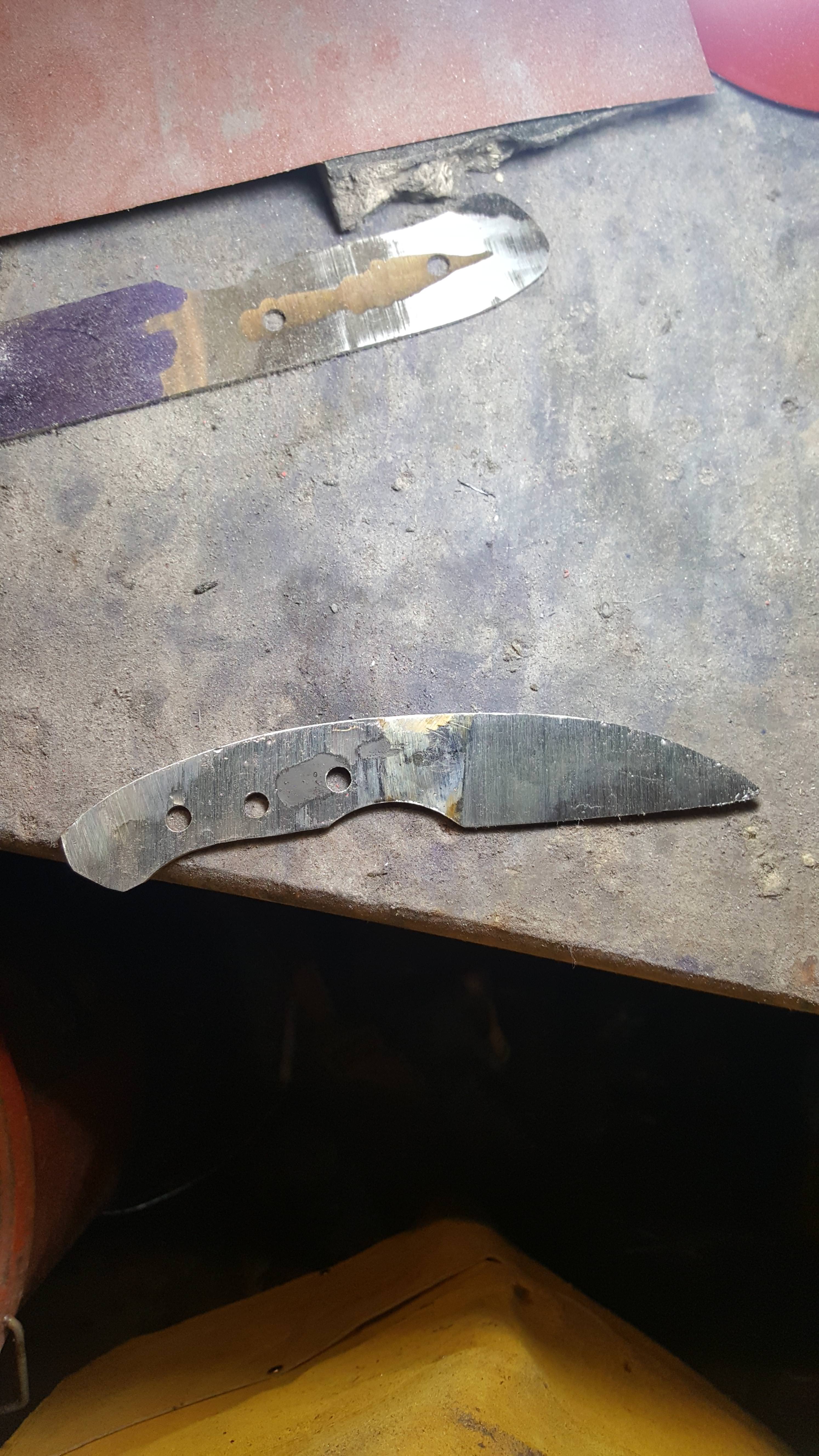

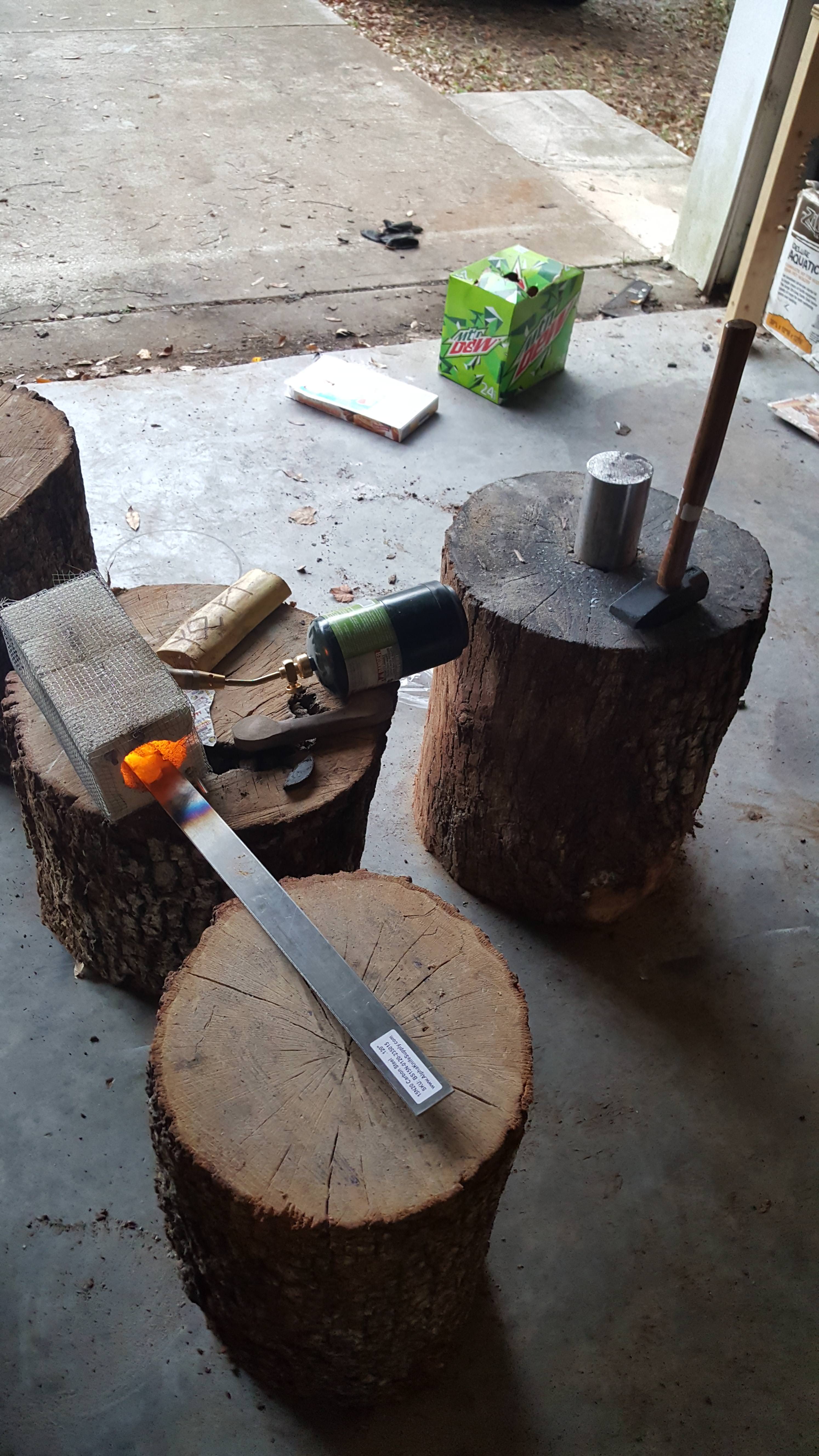

Well I tried to. Gotta pick up a prppa e tank tomorrow so I can test the atlas burner. And I'm about 2 seconds from spending 150 on a 66lb anvil.
But man am I hooked. Now I just need to decide if I want cruforge V or 1084 both are pretty cheap.

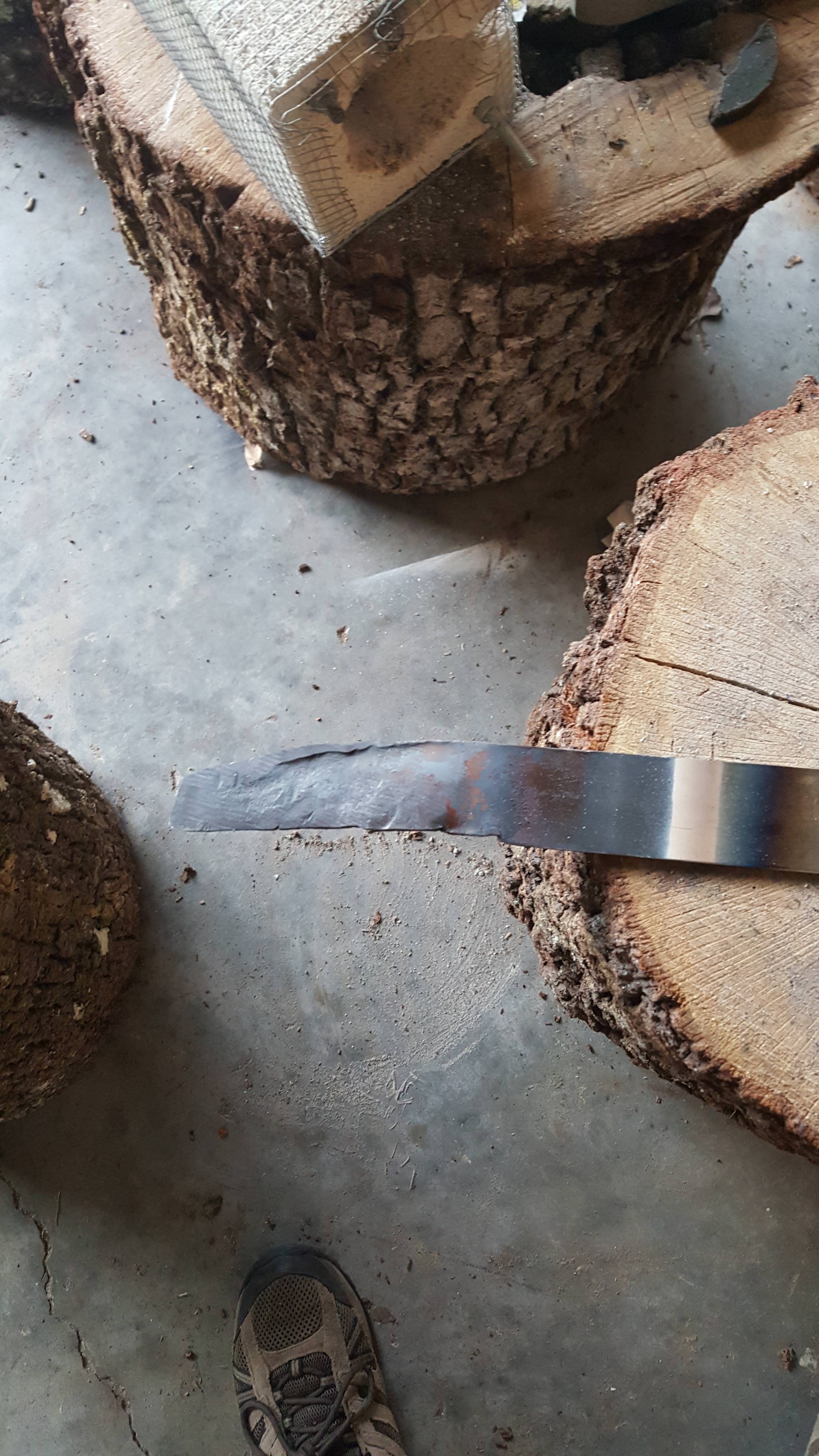

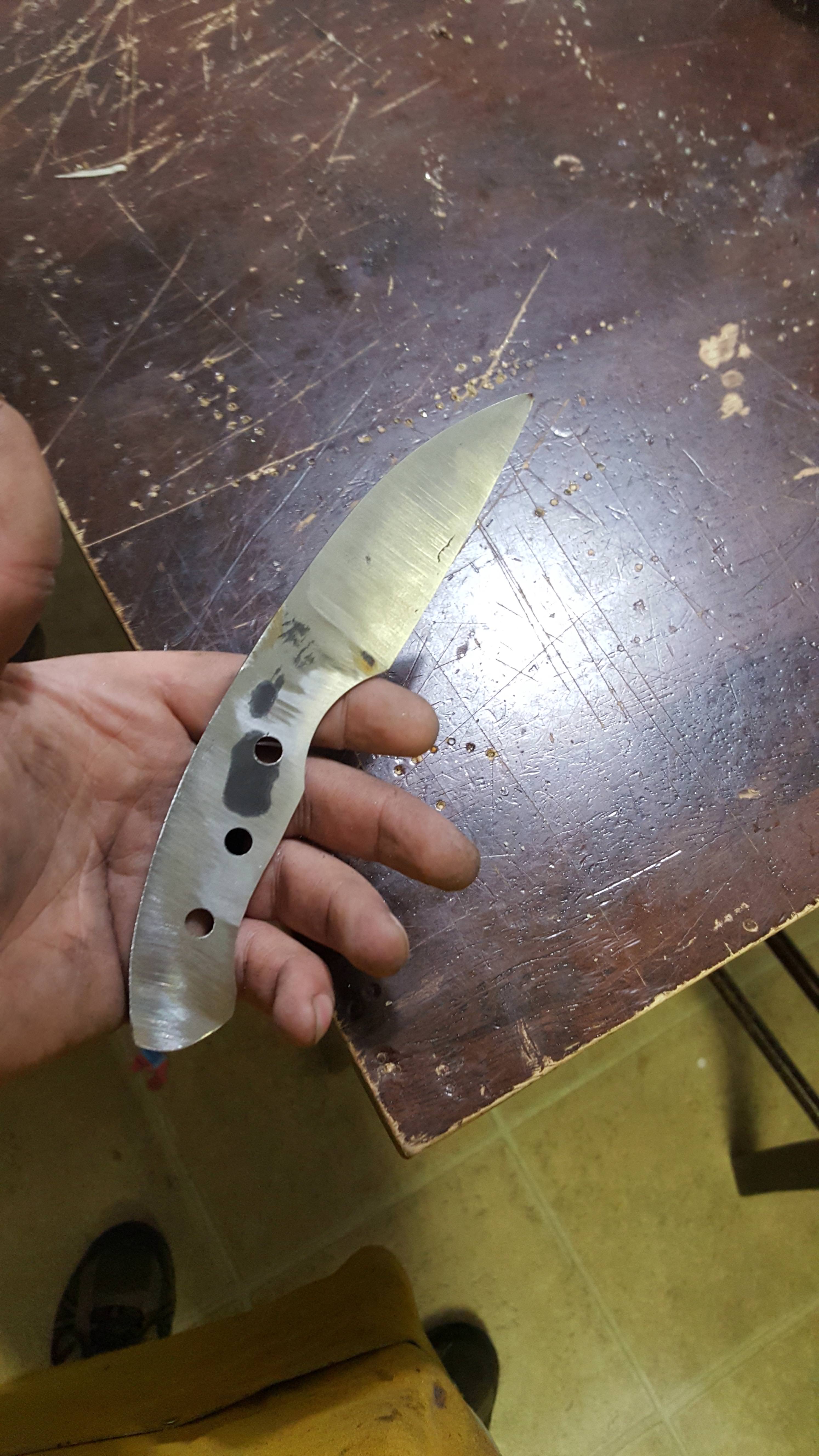

Yeah I'm pretty sure that's a crack in that last pick. This was .110 15n20 so not the best stuff to use.
Not too shabby. Ya gotta start hitting something. I would now with 1084 initially, although you might want to buy some CFV for later. It's still around but there is a finite supply of the stuff left.
That looks like a cold shut more than a crack. Basically the edge mushroomed up when you were narrowing the bar then when you flattened it things folded up on themselves. Working the metal hotter helps prevent that.
I’ve not used 1084, but 1080 is easier under the hammer and MUCH easier under the sand paper than CruForgeV. There’s no arguing that CruForgeV makes a mighty fine blade though, so do get yourself some to try. Once you’ve gone through the effort with it you’re glad you did. I’m still messing around trying different things to find what I like best personally.
I gotta get me a better anvil, this 4140 round bar just ain't gonna cut it lol. Was thinking maybe 1/4x1 of CFV and maybe 3/16x 1 1/14 1084? If you ever wanna come up to the ocala area and show me a thing or to I'd buy the beer ;)
V,
I think that anvil by itself is a bit small but the promising thing is that it is hardened steel. If you set that anvil in a concrete base to add mass you would probably have a pretty decent set up.
Yea I think it's only 3 or 3.5 in diam. It cause problems when trying to straighten out the blade. And my 3lb hammer is about the same size haha.
Technically your anvil face need only be as big as your hammer face. In actual practice, when I stepped up in anvil size the bigger face made life a lot easier. Having some flexibility in how you work sometimes moving the piece sometimes moving the hammer depending on what you are trying to do is nice.
