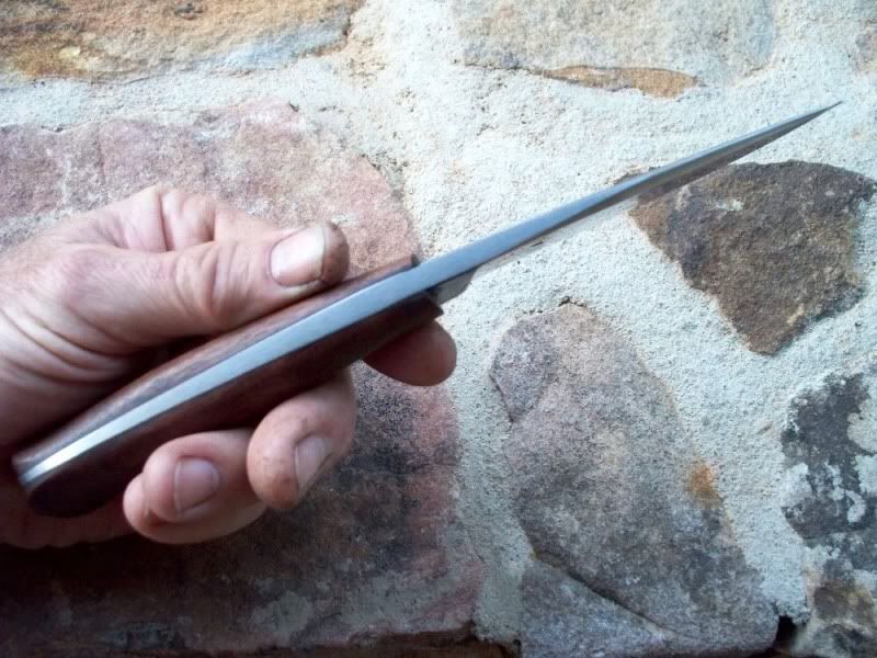

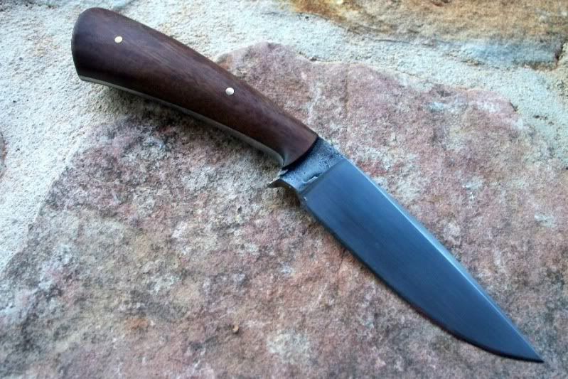

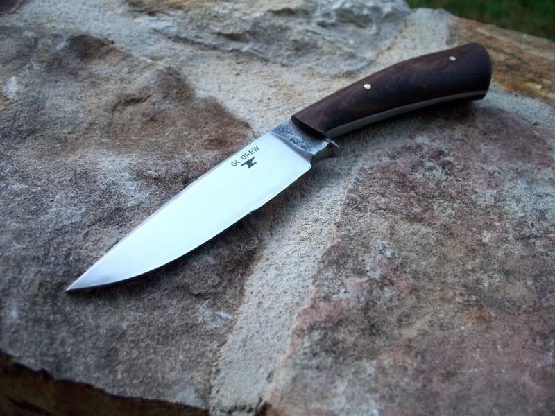

This is about the size knife I carry on a white tail hunt. A handy size that works well for field dressing and skinning.
Forged from 1/4 inch 5160
Flat grind
Tapered tang and blade
Hand sanded to 400 grit on the grind
Forge finish on the flats at the choil area
Walnut handle
Overall length: 9 1/8 inches
Blade: 4 1/2 inches

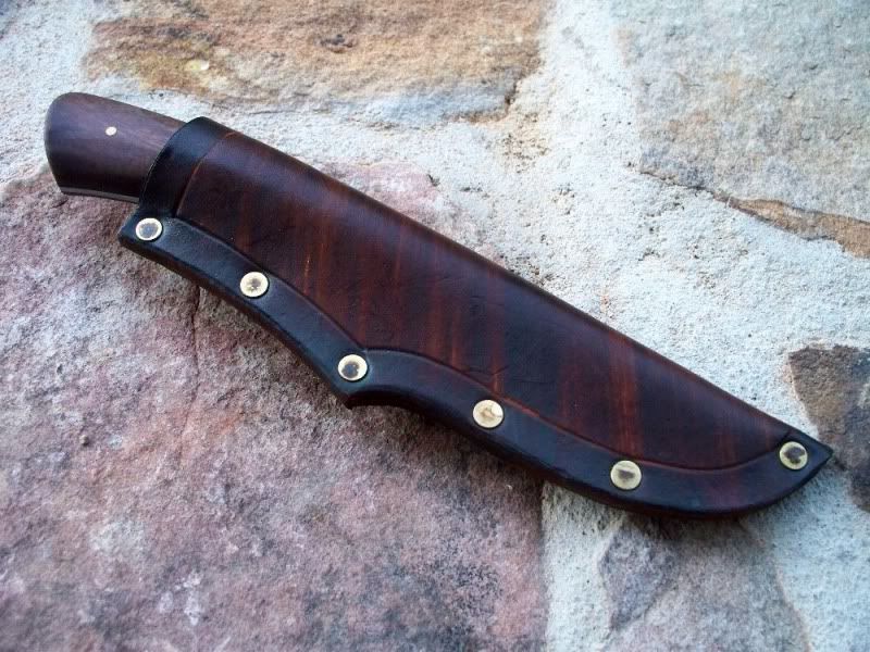

Riveted leather scabbard

Nice job, I really like that style. Looks like that was a bugger to fit the scales to. Sweet set.
Another nice knife, I like the top down picture of the tapering of the spine :thumbup:
