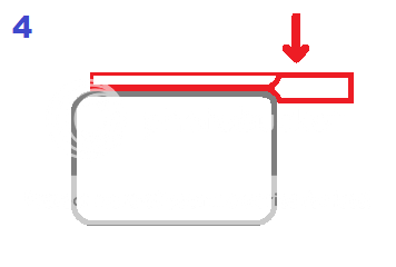

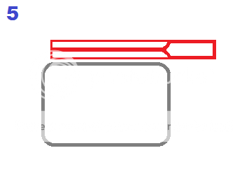

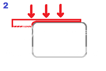

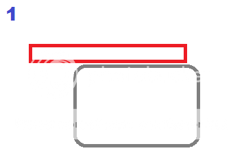

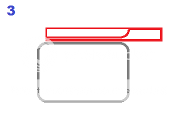

I may get my hand slapped for this by the veteran smiths, but I accept the risk... lol.(I say this because I don't see this technique discussed, anywhere.:unsure
On knives whith geometry that suits this technique(mostly full flat from edge to spine and no damascus), I will hammer the majority of the bevels from one side, only flipping to straighten. At this point, it resembles a chisel grind. Afterwards, I turn the blade over, line up the opposite side to the plunge and give the ricasso a solid flat blow, essentially twisting the tang and ricasso(or blade, depending on your point of view) to be inline and centered with eachother. I find it works well but you have to make sure to normalize at least twice... you may get warp during the quench if you don't. I have not ran into any issues, yet. Like I said, it doesn't fit all blade types but it sure is a handy technique for the bladesmithing toolbox.
Here are a series of poorly drawn pics to better illustrate...
Hammer from one side, setting a deep onesided plunge.
Turn over, line up the plunge and strike the ricasso squarely.
