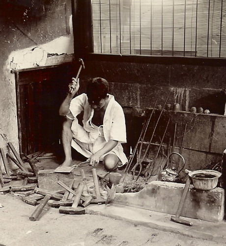

I have been browsing the interwebz lately regarding smithing. (American, European, Eastern, etc...) The Japanese along with many "primitive" smiths are often seen in seated/kneeling positions. The Eastern cilture in particular seem to do everything in a seated manner... from forging, grinding sharpening to fitting. This really hit home for me.
I am currently apprenticing with a primitive living and wilderness survival instructor and his teachings follow this principle, too. Whenever you can afford to do a task sitting, take advantage of it. I had a problem at first and complained that it was harder to maintain a seated position and still have the leverage to accomplish certain tasks. My mentor told me not to give up on the concept and try to adjust my technique. He said once you learn the correct posturing, the advantage of not having your legs working so hard to keep your body up makes a huge difference in endurance and longterm comfort. Also, the reason why it seems so difficult at first, is because our legs allow us to cheat and over-reach our effiecient working zone, so to speak. This inadvertently puts us at risk should we lax in our technique and expose ourselves to undue strain.
I see these "jungle" smiths poounding on car springs while sitting on a log and think "How can they do that?" but these guys aren't limited to sitting... they prefer it! and most are in far better shape than I.... even the dried up old guys are rocking the seated/kneeling position. The ancient Japanese have a long standing reputation in striving for perfection in everything they did from crafting a sword to making tea.
I can't help but think there is validity to this, after seeing how many half-crippled western smiths are hobbling around their shops. This may be a skewed position due to the fact that I am much more immersed in Western smithing than Eastern and admittedly, I am a bit caught up in romance of the Japanese culture.
I try to set up as ergonomic as I can (and space will allow) but am seriously considering this Eastern approach. What are your thoughts and how are you currently set up.

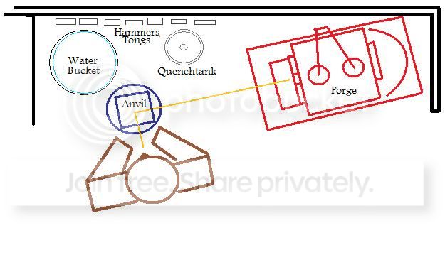

Here is mine...
Mine is pretty similar to your set up with the exception of having a "normal" anvil behind me. My primary anvil is a Japanese style anvil and I do use the horn and hardy tools with my other anvil.
In my travels it seems that the non-caucasian races use squatting positions to rest or work if possible. Not sure why this is but just what I've observed. I know Tim Lively used to forge sitting, I think he had a hole dug in the ground next to his in-ground forge. I've had multiple knee surgeries and an ankle rebuilt (thank you US Army) so I'm not going to squat or kneel unless I have to. You would have to exert more energy standing because you have to keep your entire body stabilized while standing.
Thanks Will... I have seen Tim's set up. He does have a hole he sits his legs in.... as do many Japanese.

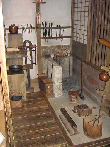

here are a few examples of some of the setups I have seen...
here is a mix...

Andy, I totally agree... when you are seated, you really learn which are your "go to tools" and how often you travel to get them. It forces you to become very organized and plan out your work process even more. It also begs for more workstations which, if it translates to less fatigue, I would consider.
