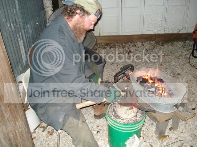

This is how I forge (when I have time to forge!).

Hmmm.... I have very little interest in forging sitting down. I'm with Ray---- on the occasion you drop something, and you always will--- I wouldn't want to be sitting by the anvil. I don't care for the body mechanics of it either.

I see an awful lot of guys, especially forgers, half-bent over while they're working, and I can only imagine what that's doing to their lower backs. I would think that has more to do with being half-crippled by age forty, than standing vs. sitting.
I do have a bar-stool in the shop and use it often. But I still try to keep my back reasonably straight. If I were to squat and lean over my work like some of the pictures I'm seeing, I'd probably never get back up again! :eek:

Stacy - From your photos it looks like you are perched on a fairly high stool which forces you into a hunched over in a rather awkward/uncomfortable position. My back would not allow that position for more than a minute! It obviously works for you though.
Thanks for all the input folks. Great info.
The camera angle makes it look worse than it is. I was probably leaning farther in than normal for the photo,too.
