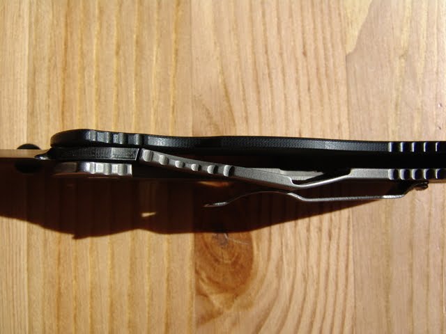

Are the cut outs for making the knife easier to push aside and close the knife. To me the cut out weakens the lockup to that of a liner lock. Also does titanium need a cut out for it to spring closed, stainless steel liner locks don't seem to need it. I figure the machining process of cutting the lock would cause the spring affect in both liner and frame locks. Just seems kind of counter productive in having such a beefy lock and weaken it by cutting a big junk out of it. Have a good weekend!
The cut outs make it physically possible to push the lock aside. Without those cut outs, you would be trying to bend that 1/8th" (or 3/16", or whatever) chunk of titanium or steel out of the way using only your thumb - not gonna happen.
So, yes, you do need those cut outs.

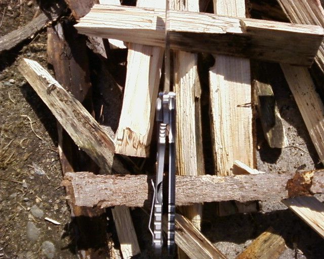

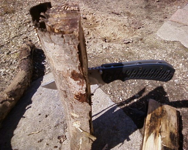

Like this one?
Dammmmnnnn Dorito, I hope that wasn't one of your knives.

The titanium that is left after the cut out, is still usually about as thick as a normal liner. Note on the picture above, the lock did not fail in the way that would cause harm. The blade still would not reach the users fingers.
Also, I would be willing to bet, no one could do that with their bare hands using a knife the way its supposed to be used for. Even if you spine wacked it as hard as you could, I doubt it would do that.
I do not know for sure, but I would say that was done by a machine slowly applying 800+ pounds of pressure.
That is a great picture! But as egally said it still would not cut you.....

Hate to disagree with Dorito but NO you don't need cut out's and their called relief cuts. I have a custom made STR (Steve Rice) Heman ti framelock no relief cut, at my request. My thumbs are not that strong and I can get it done no problem. I also have a few Mission MPF 3 which have a relief cut out of .0850 damn near a tenth of inch and I can handle those no problem.
Yes it does weaken the lock, try this. With the knife closed take your finger and put pressure on the top of the lock bar face essentially trying to push the lock bar down to the bottom part of the handle, where the line has been cut horizontal down the handle to allow the lock bar to slide over. If you can press it and get the bottom of the lock bar to touch the top of the bottom part of the handle, you ain't got much.
Lastly to the poster saying most liner locks are are as thick as the relief cuts, you haven't spent time with a digital caliper and handful of folders both liner lock and frame lock. Because while in some instances it may be close, most of the time I find the liner locks to be thicker than the relief cuts. Moreover steel is stronger than titanium, so the comparison of just thickness doesn't work as you would have to a much thicker titanium lock (relief cut) to be as strong as a thinner steel liner lock.
Look I like titanium frame locks, that is my preferred knife but I'm very picky about what I'll get because of relief cut thickness. There a lot of "hard use" folders out there that if someone sold me at that price with a relief cut that thin, I demand a refund. I've seen knives with relief cuts that are like 0.0200 of inch thick, or really should I say thin. One other thing titanium is a notch sensitive material so it responds better to long cuts as opposed to short ones, so relief cut thickness should be increased and also lengthened. I suspect their thin and short to save manf cost and to allow for the easiest opening and closing of the knife as possible.
