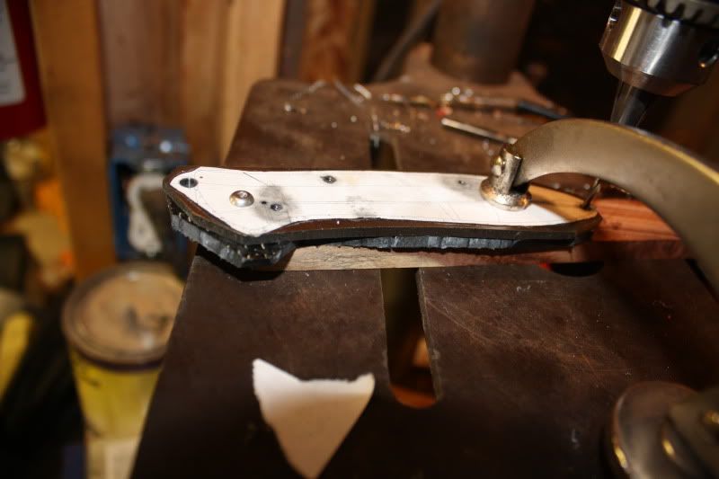

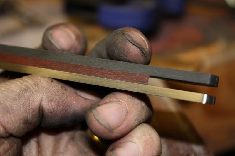

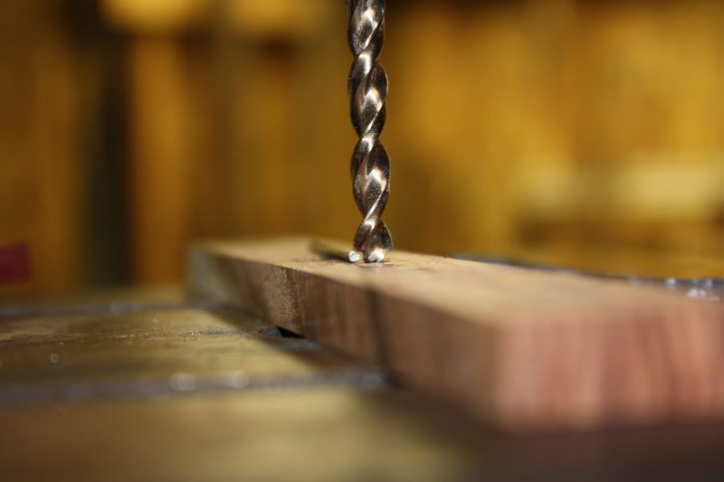

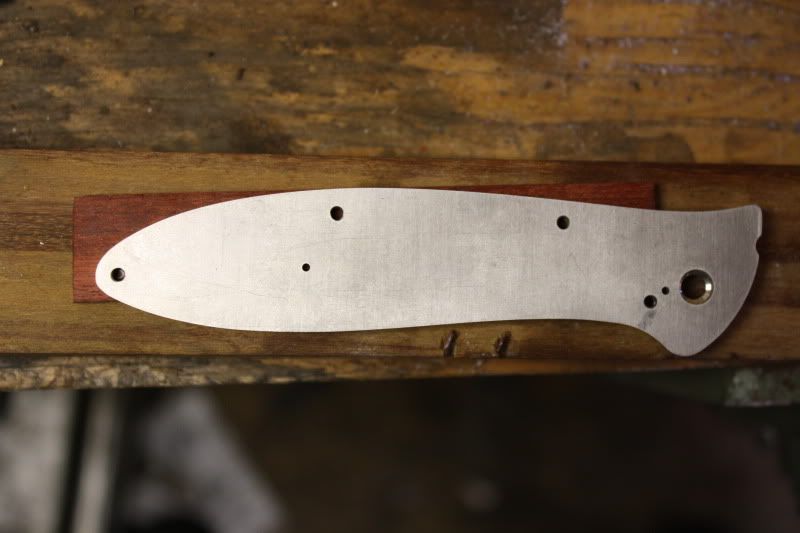

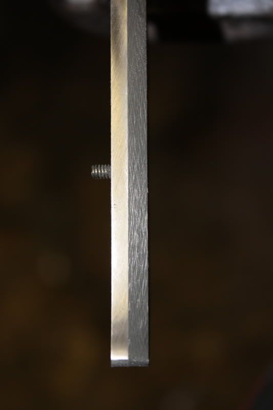

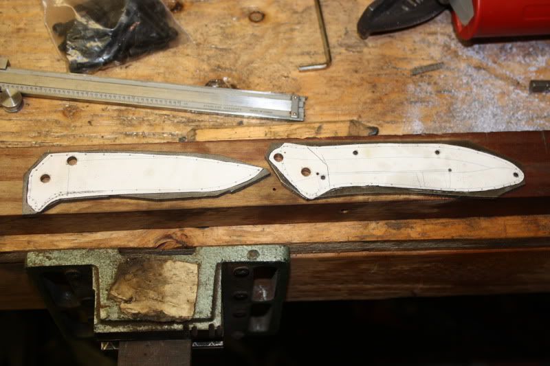

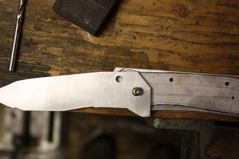

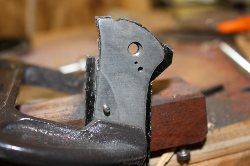

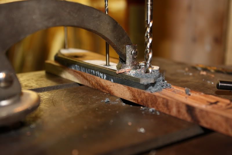

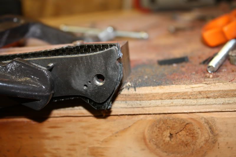

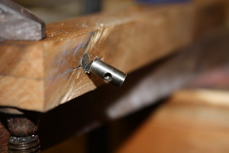

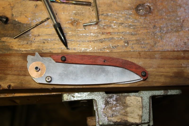

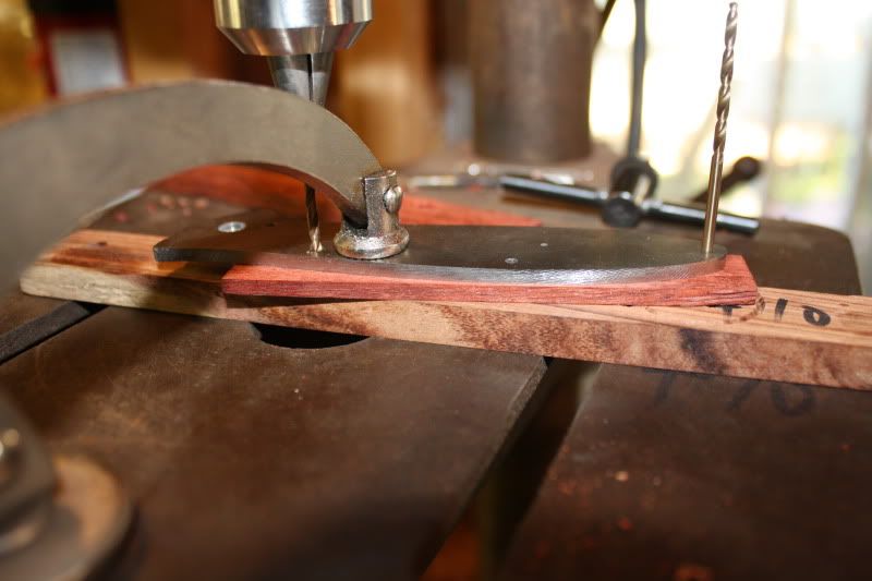

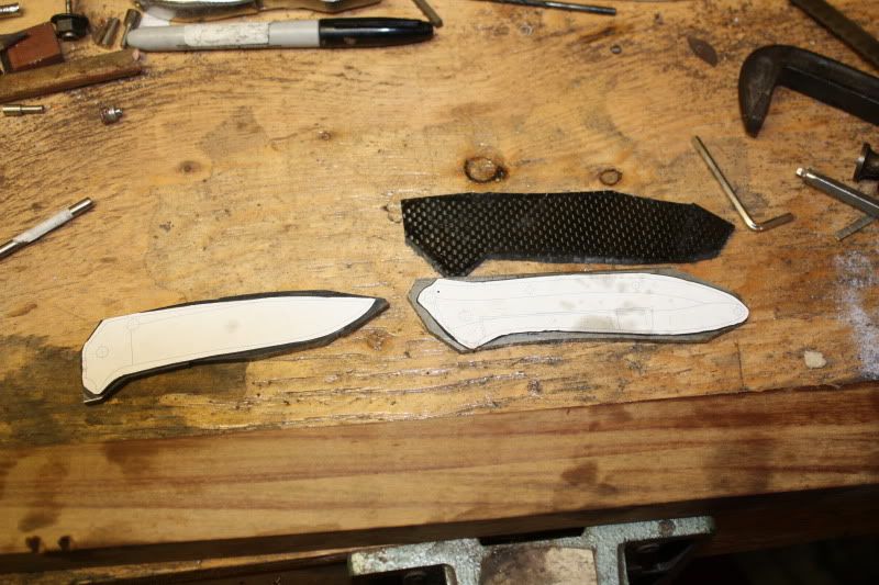

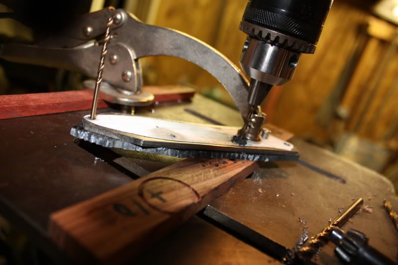

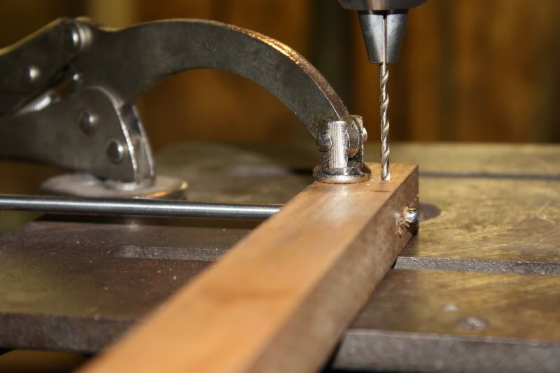

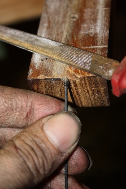

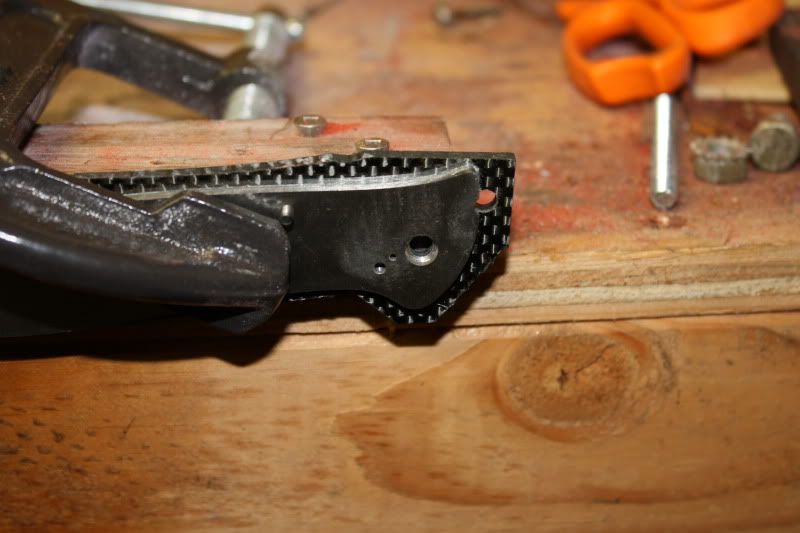

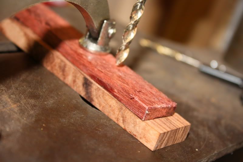

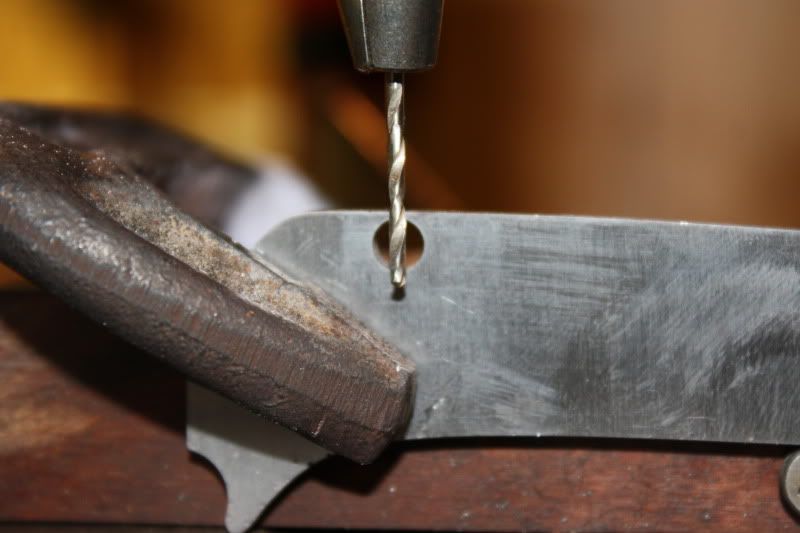

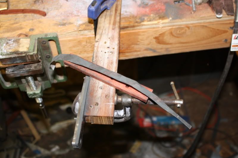

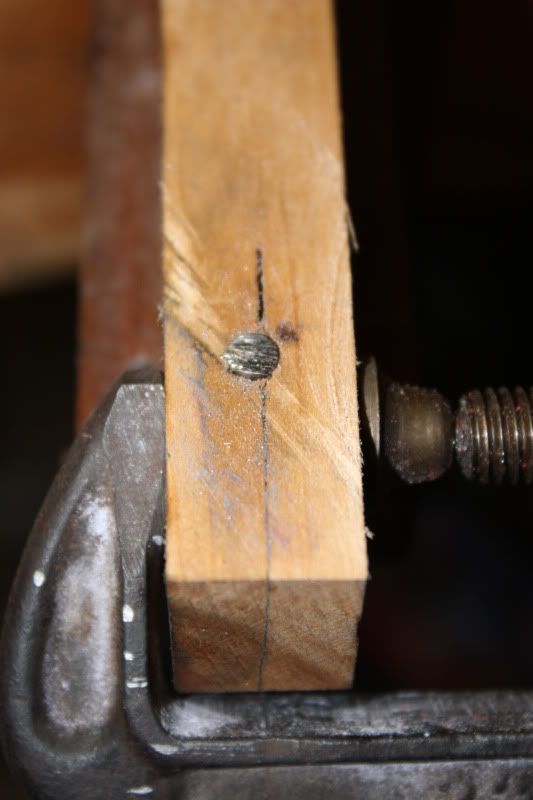

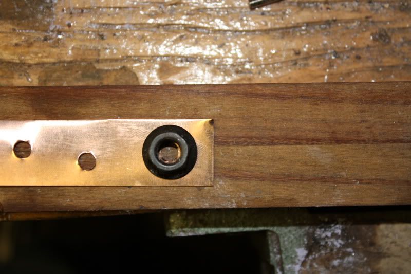

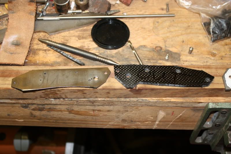

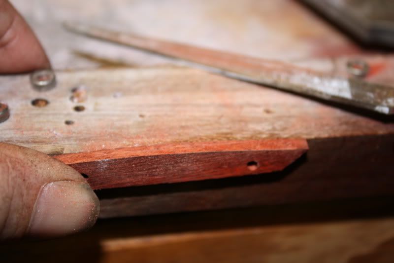

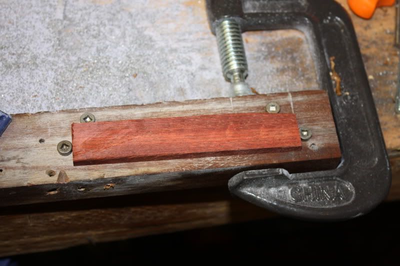

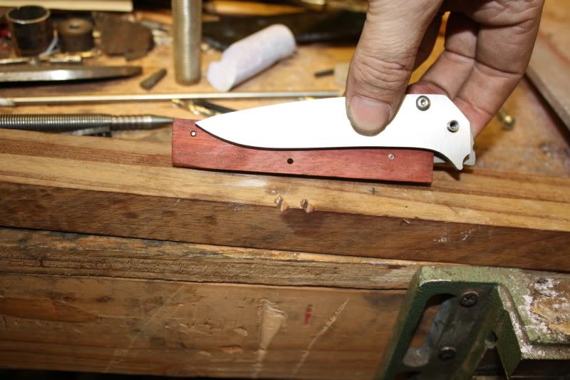

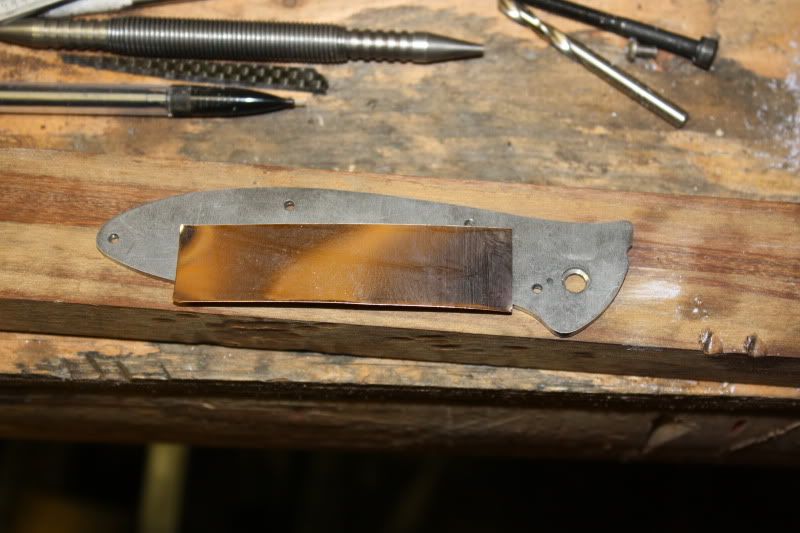

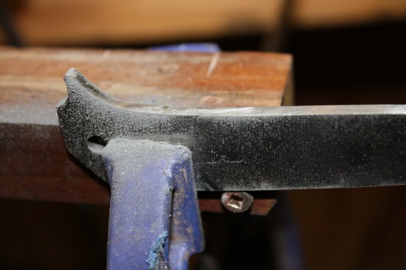

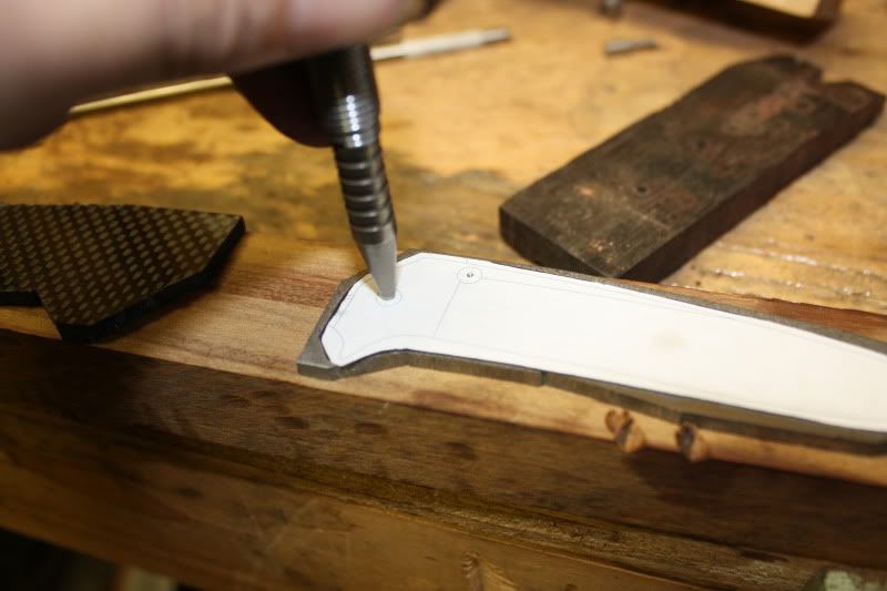

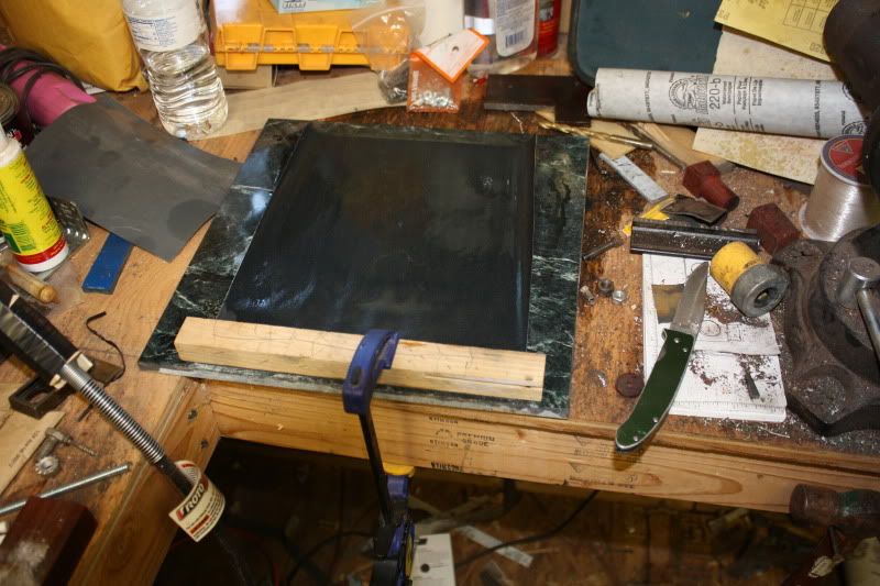

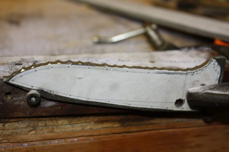

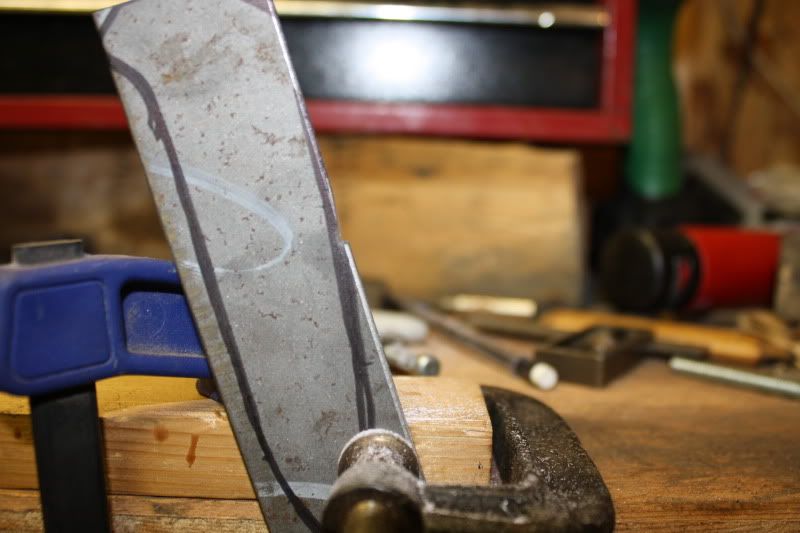

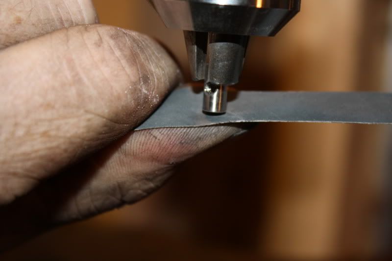

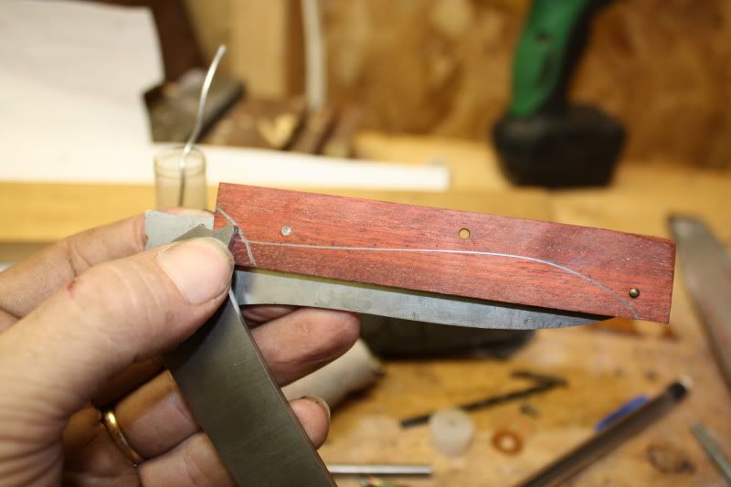

I had to write a 30 page manual for a technical writing class I took this summer. I thought I'd write about how to make a simple knife. Things somehow got a little out of control though, and I ended up writing about how to make a knife the hard way. No grinder of any kind, no milling machine, no surface grinder, no lathe, and for whatever reason (I still don't know why) no vise. Just a hacksaw, files, a couple of clamps, and a drill press. The idea was to show people just getting into this craft that given enough time, anything that can be done with machines can be done with hand tools. What better knife to demonstrate my file-fu on than a frame lock flipper?

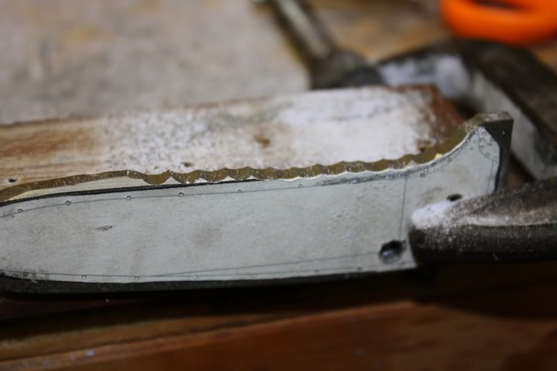

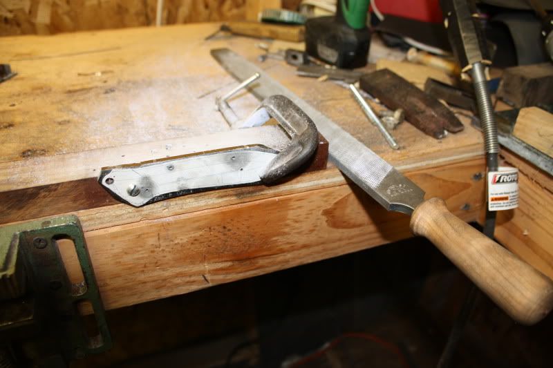

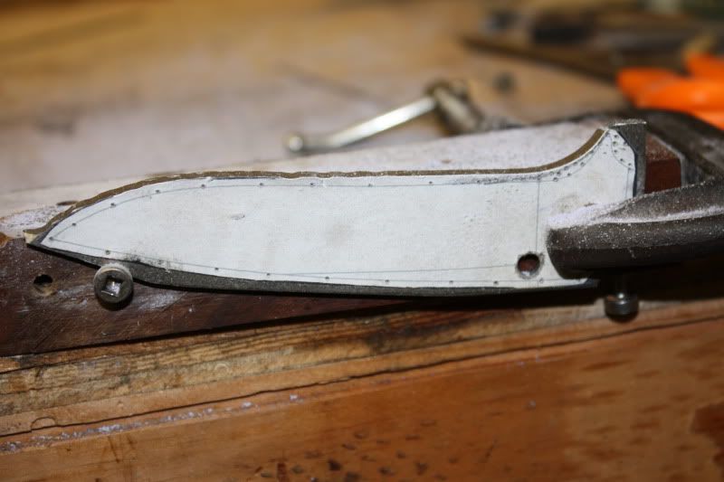

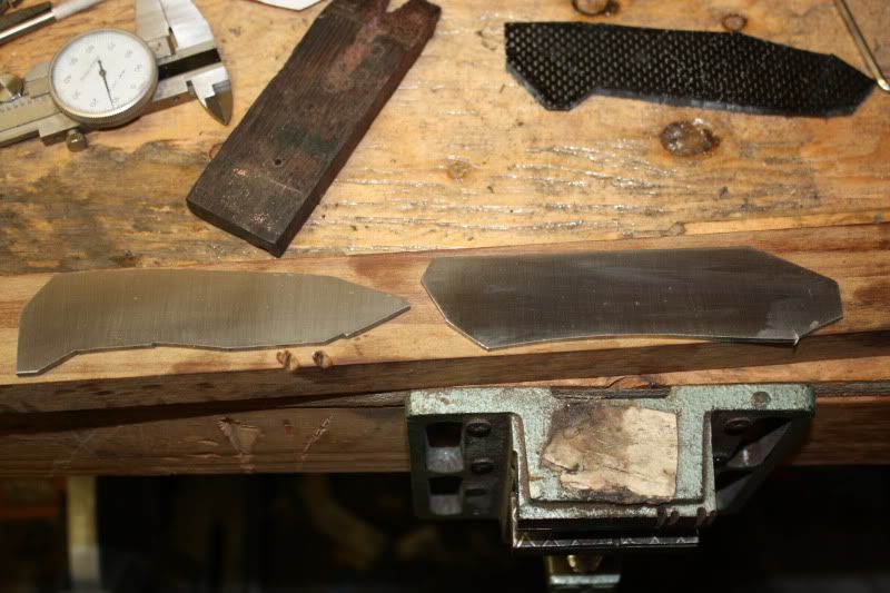

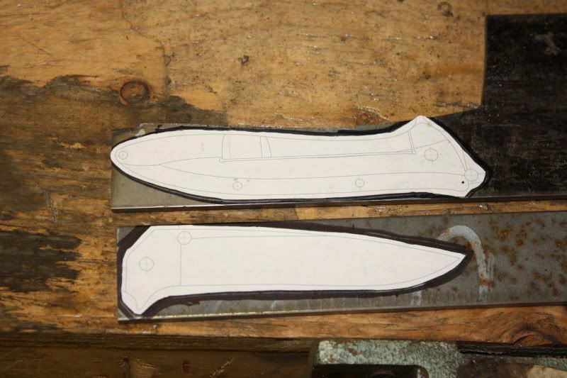

Making this knife took about three times as long as it would have if I had used all of my tools and hadn't stopped every five minutes to take pictures. Besides photos, the biggest waste of time by far was profiling. I was stupid and cut the parts out way oversized with the hacksaw so I had a ton of filing to bring them down to the right size. Luckily there are tons of super cheap tools that will make profiling much quicker and easier. Hopefully anyone that tries to follow my guide will be smart enough to at the very least buy a fifteen dollar angle grinder to profile parts.

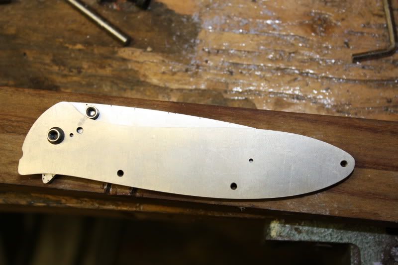

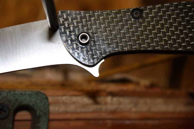

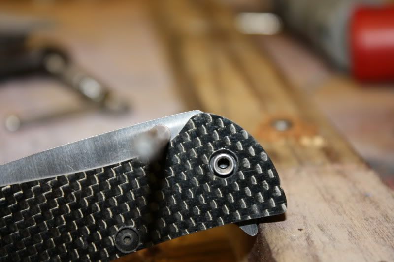

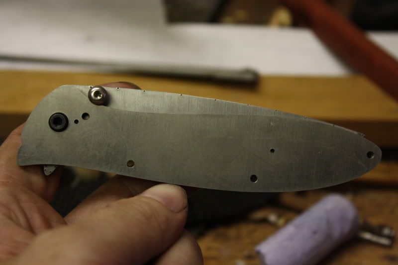

Here's the knife as it sits today. I still need to send the blade off to Paul Bos for heat treating and do some final sanding and edge softening on the handle.
If anyone has any questions or advice on any step don't hesitate to tell me. Even if all you want to say is "Wow! That has to be the dumbest way of doing that I've ever seen!" That's cool too.
