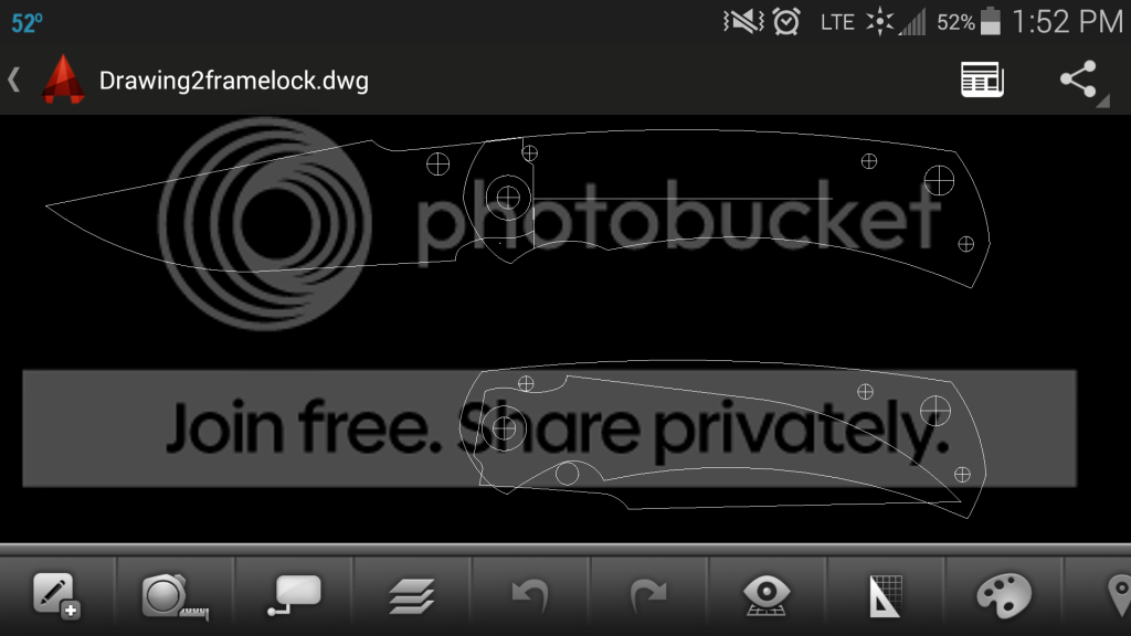

My work computer has Autocad I have never used it so I tried putting my design into it. Man that sure makes it easier!!
Let me know what you think and if I need to change anything. Did I leave enough on the back of the tang behind the pivot?
Justin
Looking good! I just replied to your email, big thanks and respect!
I'd try to add more lockup area below the pivot... you want the lockup as far away from the pivot and as close to "6 o'clock" as possible. (with the pivot as the center of the clock)
