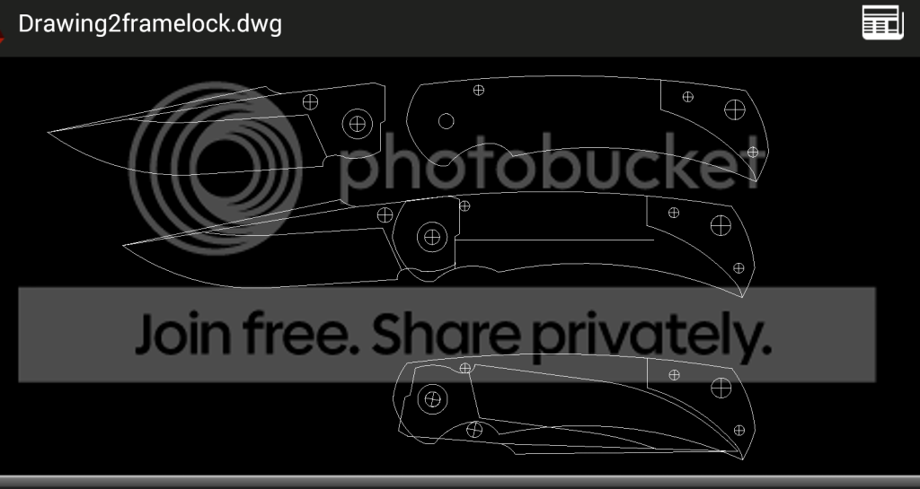

Framelock/liner lock design critique and construction advice
Looking good! I just replied to your email, big thanks and respect!
I'd try to add more lockup area below the pivot... you want the lockup as far away from the pivot and as close to "6 o'clock" as possible. (with the pivot as the center of the clock)
Thanks Daniel for the help!
I messed with it a bit more after work today and it about made me go crazy I kept tweaking it and moving this which made me have to adjust this and that...I had to walk away from it it about drove me crazy :)
That's a nice looking design. Please post a WIP if you can.
Thanks Lo/Rez. I have thought about doing a WIP if I do I will let you know. If nothing else I will take alot of pics. Hopefully I can get the design ironed out soon and then get my materials ordered.
Justin

I think im done designing it. I tried to make adjustments per recommendations and studying the drawings in Bob Terzuola's book. Any final thoughts? I'm going to cut it out on a template and see if it works. I know I have a little bit sticking out from the front of the scales but I'm just going to roll with it, shouldn't effect anything but the looks when it's closed.
Also for framelocks what thickness Ti is everyone using for scales? I have some .098 AEB-L I planed on using for the blade but might get thicker but not sure yet. Total length of the knife is about 7 3/4" opened. I'm kind of thinking .125 for the ti.

.125" will be nice... maybe on the thinner side compared to some framelocks but my latest one is thinner than that...

Thanks for the feedback Daniel. Yeah I though .125 would be on the thinner I just don't know how much of a bear ti is to work yet so I don't want to stretch myself. I have a 2x72 and a portaband saw with variable speed....how does it cut with a bandsaw?
I wouldn't recommend going thicker than .125 for a blade that's only .098. Ti is not too bad to cut at least compared to s110v. Keep your feed rate up and if it gives you a hard time just cut it to length and grind the rest. It does grind fairly easy at slow speed.

I used .190" stock for my first Framelocks and it was really tough to work with at first... even after hundreds of Ti knives! .125" will be great and plenty solid for a Framelock... plus I feel that will go better with your blade thickness. I'm working with .140" Ti on one model and .100" on another, both have 4.5" range handles.

That's what I'm thinking to Varga I don't want a over built handle on a thin blade. But I have to order the Ti so i can pick up some thicker steel at the same time if needed. They have some .138 or .130 AEB-L from alpha that's where I was thinking of getting the ti from unless some has a better source for ti.
