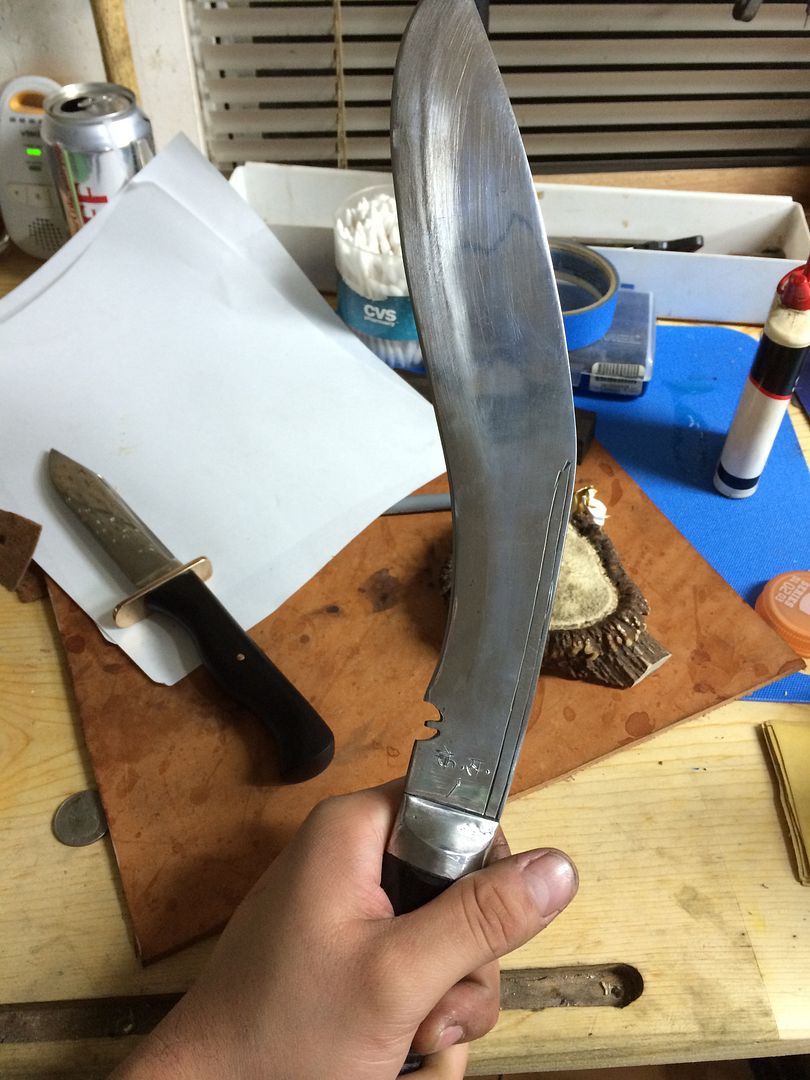

Just got back from quenching the scimitar, now to toss 'er in the oven for a few hours, then its off to the grinder! You can just see the quench line where I dipped the edge in the oil, leaving the spine flexible with a hardened edge. This allows the sword to be able to flex and bend, while retaining a sharp cutting edge.
Stay tuned! More to come tonight!!!
Done with the grind! This thing is insanely sharp, and held its edge after repeatedly chopping into a PT 4x4. I can't wait to see how it feels with a handle!!
What do you guys think?

Here she is with the handle. I decided to go with some bubinga for the handle with bronze hardware and a mosaic pin in the center. I gave the bronze a hammered finish to give it a more antique feel. All I have left is to add my mark. What do you guys think?
Obligatory "artsy" pic
That looks....intimidating. I don't know if I'd have a place for it in my collection, but if you were to come up alongside my boat holding that thing I'd definitely be nervous.
In all seriousness, it's an awesome looking blade. I think it's great that you're bringing such originality to your knives. You're doing things that are markedly different from what everybody else is doing. I think they refer to people like you as visionaries and true artists. Kudos to you for having the courage to go your own direction, and to be so good at it on top of it. It's a real treat to have the privilege to see your first creations as they are going through the process of becoming knives. Thanks for sharing.
I'm really liking that, Evan. A new build with a decidedly old-world look!
Thanks guys, I appreciate the compliments! I'm really happy with how this one turned out. I've definitely got the forging bug now...

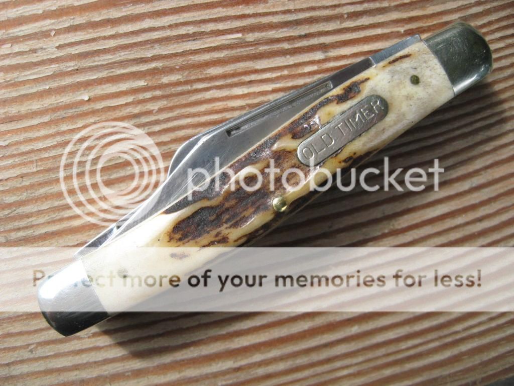

I'm carrying this one today; an esnyx modded Schrade USA 8OT with stag covers and modified sheepfoot blade. I love this knife! Thanks Evan!
