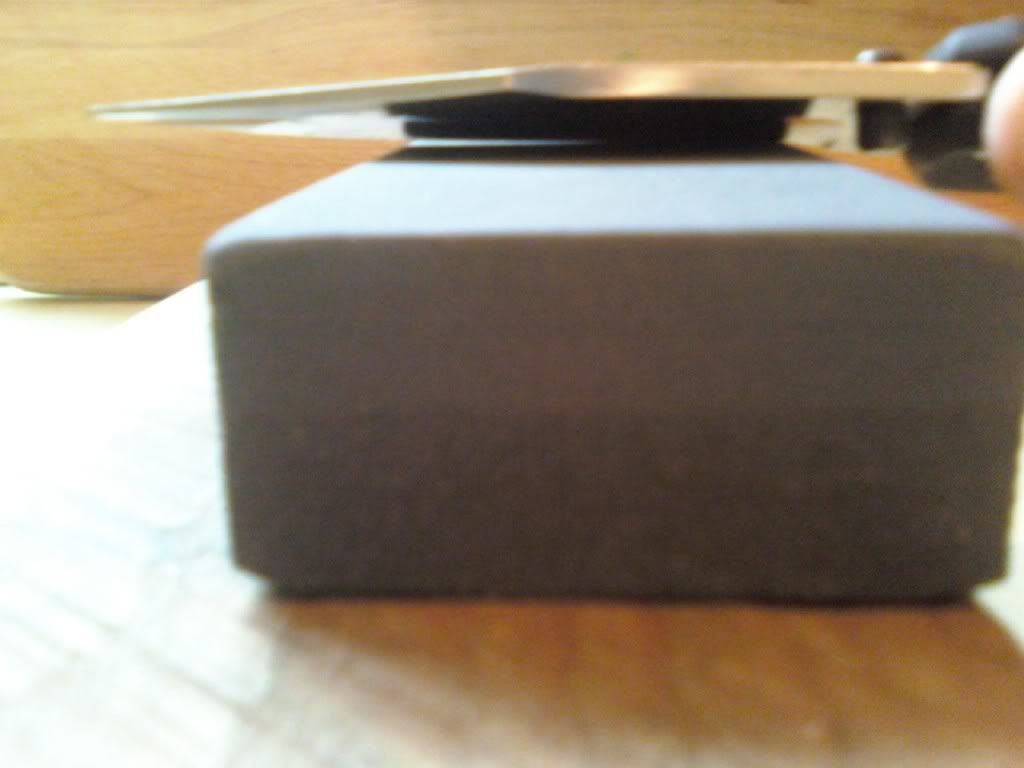

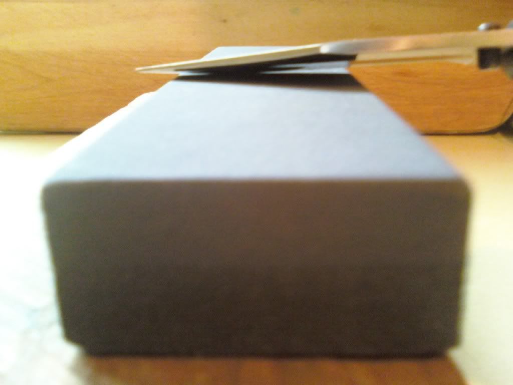

It is, but.....IMHO, it looks like your pictures show needing to raise the handle to keep the right angle on the point. Which was my original question.
The pizza cutter/plate analogy is perfect.

Don't lift enough = thinner angle of approach at tip
Lift too much = thicker angle of approach at tip
Stay in the same plane = same angle of approach at tip
Another way of envisioning it is that you have the knife resting on an angled table surface equal to the edge angle you want. In that scenario the handle may become more elevated when the knife is rotated against the plane of the table, but you aren't "lifting" it off the table at all. You're just rotating it on the table. The table is the plane of the angle you want. Your rotation during the stroke is just to bring the region of the edge you're working on into contact with your abrasive.
Focus your attention on the angle of the knife in HH's picture. Notice that as he lifts the handle, that angle doesn't change.

Yes, handle must be elevated. If you were to set the stone at your sharpening angle then you could just keep the blade parallel to the table. The action is exactly the same though, the handle must elevate relative to the plane of the stone surface.
Blades with a slight belly only a little bit, blades with more belly will require more elevation. Imagine a line running perpendicular to the edge, extending back through the spine.

Ok thanks, that was my most basic question and your pictures kind of confirmed what I was originally thinking (and doing) when sharpening folders that have a significant belly.
Trying to "merge" the input from you and 42, it appears that I do need to elevate a little, but I think I was simply overdoing it. I seem to have that tendency to overdo everything :cool:, whether too much pressure, too many strokes used which actually degrades the edge, or elevating to too much of an angle around the point. Not sure if my photos are good enough to show what was going on originally with that BM blade above, but I do think I must have elevated the handle too much.
