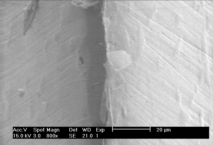

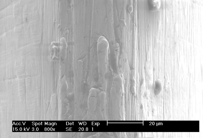

As an example of this, please look at the the following photos:
This is a scanning electron microscope image of a Talonite blade sharpened according to our test sharpening procedure. Notice that the final microbevel is approximately 20 microns wide (20 microns is about 0.0005 inches). You can see the presence of the carbides in the alloy, because they're slightly raised compared to the matrix. But the carbides have been ground to the edge geometry, and this blade is shaving sharp.
This is an SEM image of a Talonite blade after a CATRA ERT test. Note that the original sharp edge geometry is gone, and that the edge is rounded and has protruding carbides. This edge won't shave, and when handled feels dull. But because the carbides protrude from the edge, the blade continues to cut the CATRA media Results like this convinced us that the CATRA ERT test is not a good test for observing how long a knife stays sharp when used in cutting the kind of less-rigid materials that are usually used with hunting knives.

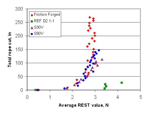

Here is the FFD2 and CPM S90V modeled :
There is no statistical proof that the FF blade has superior edge retention because the blunting factors are too uncertain because of a combination of three factors :
1) lack of data in the initial region where the rate of blunting is high
2) lack of data in the tail region of S90V
3) high uncertainty in the data

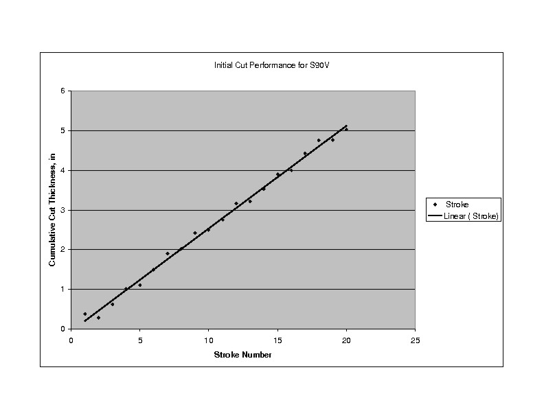

In regards to the initial low cutting ability of S90V. Based on examining the actual data there is a misconception in the above. It was stated that the S90V blade does not cut as much material at the start. The first point measured is AFTER 20 CUTS. This is much too far too make such a statement as the initial rate of blunting can be very high for large carbide steels, especially if the edges are acute and/or polished. I would affirm if the cuts were measured at 2,4,8,16 then you would see a much higher initial performance from S90V.
As I mentioned in my previous post, this statement would be correct if the test were a CATRA ERT test, with silica-impregnated cardstock used as the cutting medium. However, it's not correct for our test.
To demonstrate that the 20 stroke measurement is consistent, I've included a plot of the total rope cut as a function of stroke number for the first 20 strokes. As you can see, the cutting performance is very linear for the first 20 strokes, and you can see that the proposed "much higher initial performance for s90V" doesn't exist.
The above data is also a very poor way to compare the blades because what it does it take two dependent variables which are highly noisy, divide them and magnify the noise and then plot essentially two dependent variables so now both the x and y axis are highly noisy. This actually reuquires very complex methods to fit properly even with simple models because this adds another element of nonlinearity into the problem. What should have been plotted is just the stroke count and amount of media cut. This would give a much smoother curve as the x axis variable is independent then and has no noise. It is also much more straightforward to rationalize as it just shows how much media is cut after a certin amount of passes.
This figure is not our preferred figure to plot. However, we used it because it's the same plot specified in ISO 8442.5:1999, according to CATRA

The above graph attempt to show the sharpness after a certain amount of media is cut but as I noted it magnifies the noise and introduces an additional nonlinearity. I'll look at the other data shortly.
The data may be noisier than you prefer, but it's clearly not even close to the limit for determining which of the two blades has the higher performance. Since you have a PhD in physics, I'm sure you understand the optical resolution limit, which is also very similar to the statistical test for determining whether two sets of data come from different population. In both cases, if the mean of the first set is separated from the mean of set two by a factor larger than the standard deviation of the data, the difference can be determined through statistical processing. As you can see from the figure, the two data sets are not even close. I can understand that you might disagree with the exact amount by which the FFD2 outperforms the S90V, but I can't see any plausible way to interpret the data to mean that the FFD2 doesn't significantly outperform the S90V. Not only is the initial sharpness higher, but it drops at a lower rate, even though it hasn't reached the plateau (and won't, because we don't test to the point where the edge is gone and we're just relying on the carbide "teeth").
As I said several times in the above, and noted in detail in the sharpness article, there is push cutting and slicing sharpness and you can be very high in one and low in another. If the slicing aggression is much lower initially, regardless of the push cutting test, it would indicate improperly formed edges which you would verify under magnification.
I understand the difference between push cutting and slicing cutting. Our primary sharpness measurement is push cutting, because that's how you shave, and shaving sharpness is our goal. In our tests, total media cut is intended primarily as a measure of the amount of cutting work done to degrade the sharpness, not as a primary measurement of the sharpness itself.
In my opinion, the figure that best shows the improved performance of FFD2 compared with the other materials is this one:
