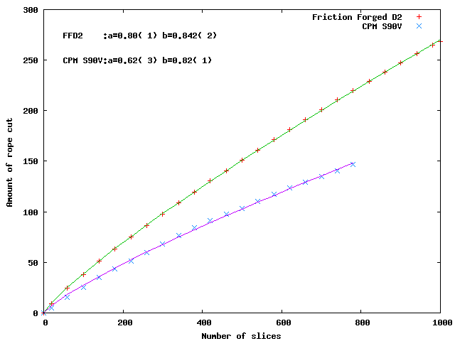

(Quoting from my earlier post)
What exactly is that a graph of? It looks like it simply logs the total amount of material cut as the test progresses.
You're exactly right. It is the total amount of material cut as the test progresses for the first 20 strokes. I presented it in that format, because that's Cliff's preferred format (see, for example, the following):
Here is the relevant information modeled :
Note how the plot is much smoother and more stable. This is also due to cumulative plots being inhernetly an averaging process plus not plotting two dependent variables. Fitting this data is MUCH more robust because of these two issues and note the model parameters are precisely defined.
Cliff's earlier point was that we had biased the data by leaving out the early data points:
It was stated that the S90V blade does not cut as much material at the start. The first point measured is AFTER 20 CUTS. This is much too far too make such a statement as the initial rate of blunting can be very high for large carbide steels, especially if the edges are acute and/or polished. I would affirm if the cuts were measured at 2,4,8,16 then you would see a much higher initial performance from S90V.
So I plotted the data in Cliff's preferred way for the first 20 cuts. According to Cliff's model, there should have been a very high initial performance that dropped off after 20 cuts. However, the data actually shows a constant increase in the total amount of material cut after each stroke, which leads to a straight line plot. This means that there was no "much higher initial performance" as Cliff attested.

Cliff's model.
Cliff Stamp said:
C(x)=Ci/(1+a xb)
Here Ci is the initial cutting ability, which is dependent on the geometry of the knife and properties of the material being cut. The value of a depends on the ratio of the forces Fe/ Fw and along with b depends on the characteristics of the material being cut and the properties of the steel. In general the main influence of b is on long range blunting where a is more important in the short term.
The benefit of using the above model is that the parameters can be correlated to properties of the steels and thus predict behavior. As a starting estimate the dependance of b would be expected to be similar to
b(p,h)~1/(p*h*wr)
Where p is the probability that a carbide will tear out on a given cut, h is the size of the hole and wr is the wear resistance. The probability of carbide tear would be related to the strength of the martensite and nature of the carbides (size/amount), grain size, and other properties. Note this is for slicing, for push cutting this would invert :
b(p,h)~p*h/wr
As in push cuts when carbide comes out the performance drops rapidly as the holes just bind up in the material.
