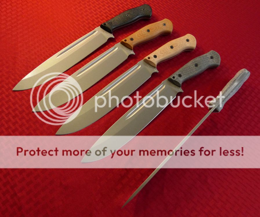

These are thinner than normal (almost RLC) Light Choppers with heat treat optimized CPM 4V at HRC 64 taken down under .020" before sharpening and sharpened at 15 DPS. This is aggressive geometry used in competition cuts. That's the purpose of this alloy and HT, it can do that. You probably shouldn't use these to baton through a lot of fire wood but as thin as they are they're not fragile and they'll hold up fine in a competition cut including 2X4 chop, oak dowel, golf ball etc without chipping, rolling or appreciably dulling and sail through ropes, water bottles, paper and straws etc like a laser beam. This is a high performance knife with high edge stability and resistance to the sort of damage like chips, rolls and bends that can get points deducted in a race with the same advanced metallurgy and thin geometry used in competitions. Actually more advanced metallurgy, our heat treat outperforms the current "state-of-the-art".

HT optimized CPM 4V, 64.0 HRC, .188 thick at ricasso
Total length 15.625
Blade length 9.875
Edge was taken under .020 and sharpened 15 DPS
Weight 17 oz
Grippy 3D machined scales in micarta or TeroTuf
Black oxide treated 18-8 stainless steel fasteners

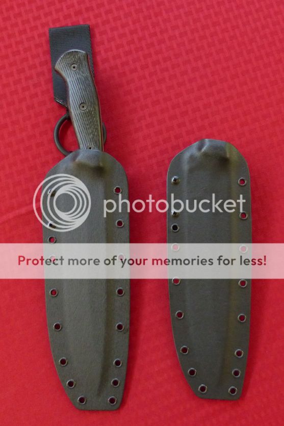

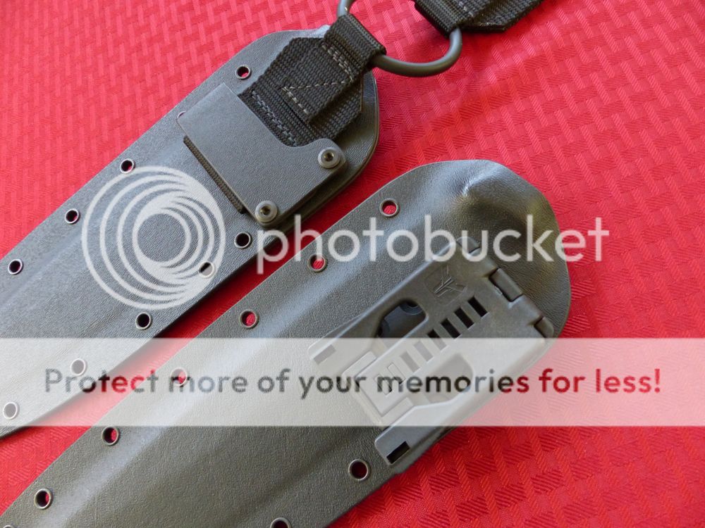

This is a big knife. If you're going to carry it on your belt you might prefer the dangler sheath. If you're putting it on or in your pack you might prefer the TekLok. Both configurations work both ways, but it's nice to have a choice.
Tell me what scale option you choose and I'll build it. There are 12 knives available in this sale. The knives in the picture are not the knives you will receive. The knives need scales and sharpened so they won't start to ship until next week.
These are "field grade" with tool and grind marks, milled and tumbled. The bevels are hand ground and slightly convexed after being milled.
