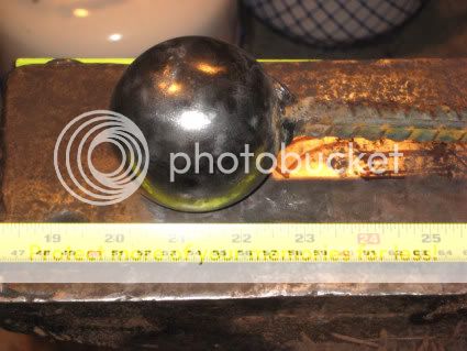

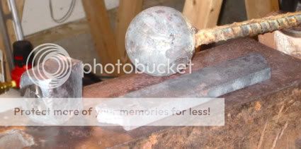

And here’s where it all started.
That is one thick, SOLID sphere of 52100 and I did NOT envy Stuart the chore of pounding that into a blade – particularly doing so by hand, and particularly when using one hand to try to swing a 20 lb hammer:
Stuart ultimately enlisted spousal support in holding the bearing to he could swing that beast of a hammer with two hands. And he’s got a cool vid showing that very thing which hopefully he can add here.

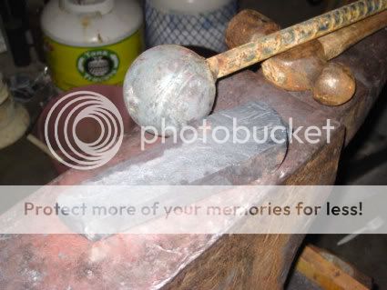

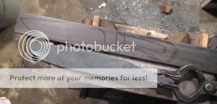

After more pounding than I’m sure Stuart would like to recall, a knifelike object began to emerge:
Preliminary grinding done, ready for heat treating:

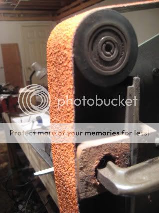

Further grinding:

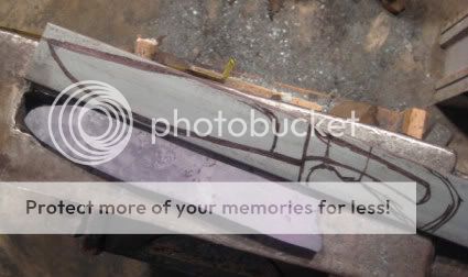

First, here’s a look at the sketch of the overall design:
A composite handle of wood with horn was contemplated from the outset, based upon a similar combination that Stuart had tried in a nice large Fowler-styled hunter.

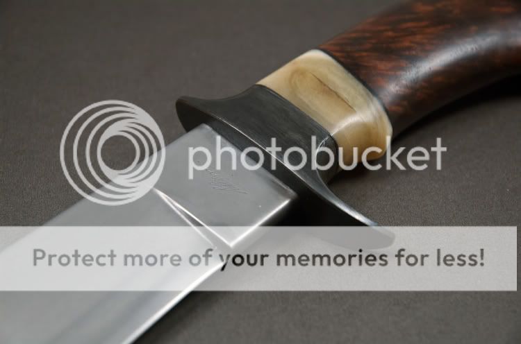

We ultimately decided that the horn would provide the bets contrast with the blued / etched mild steel guard.
Here is the whole deal all glued up:

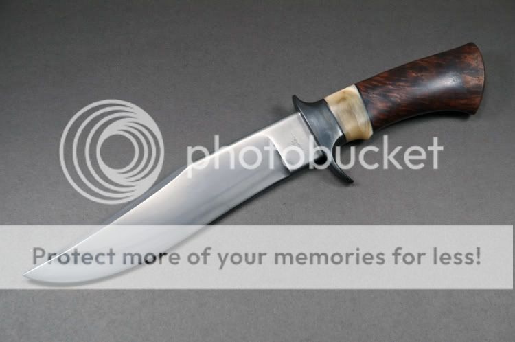

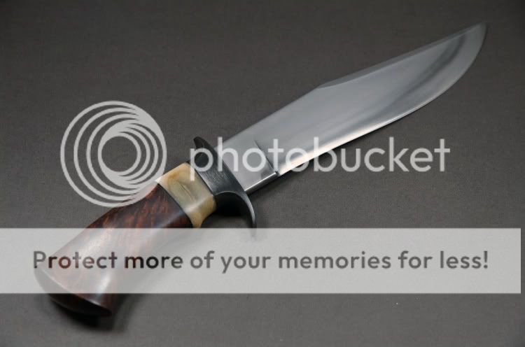

And finally, the finished knife:
A sheath is in the works, after which the knife will be heading east – and I can’t wait!

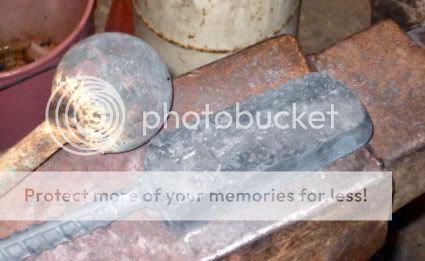

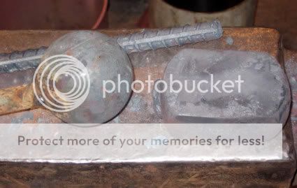

Thanks everyone.. I took about 60+ photos and several videos for this WIP.. I think I show my methods to share what others have taught me and also to garner any criticisms and tips to improve my own knifemaking. And having Ed talk me through the process was about as good as I can manage at the moment from being at Willow Bow. What a treat and an honour. I have utmost respect for Ed's theories, methods and results. I tried the best I could to stick to these as I made this blade.
Here's a couple pics I liked that show a little of the process. This is the series of the forging. Reducing the billet, each of these photos is about 2 or more hours of hammering and at least a 1/2 hour to heat up the bearing. The last forging session was the longest and from the rough billet took about 3 1/2 hours to get the blade shape.
