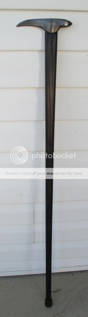

My latest project, I saw one of Beaver Bill's Bear Claw canes in real life and had to have one, but sadly it's way out of my budget.
So on a budget of $20 I'm re-purposing an old $5 hatchet to make my own Bear Claw Cane.
I went to the big box store to look at the shovel handles, they were just a tad small in diameter so I picked up a post hole digger handle. I had to rummage through a bunch of them to find one with good straight grain. It's made of ash not hickory but it should work just fine. After cutting off the attachment holes I still had 4 extra inches for a fudge factor. I used a plane to do the shaping the shaft More than half the weight of the wood wound up on the floor. So far $5 for the hatchet and $10 for the handle and I'm still $5 under budget. :)
I fitted the head to the staff before finishing it so as not to mar the polished head with tool marks from the fitting. I then gave the staff a quick burn, stain, and wax and set it aside until the head was polished and ready.
I finished the head with a lot of filing, emery cloth, wet sanding down to 400 grit and then buffing with a heavy cutting compound. I went with a cold blue finish, it's not perfect, but it's close enough for me.
I hung the head, cut off about 3" from the foot and added the rubber shoe. It's now ready for the street and it came in under budget.

Outstanding work. It has a well balanced look. I was doing some physical therapy this morning on my back and shoulder. I have a basket with some walking sticks and one of those alpine ice axes. The vintgage ones with the small blade like a hoe and a point on the other end. It also has a sliding metal ring with a strap attached. The blade and point of axe has a leather cover over both side with a buckle in the middle. I was using it do to range of motion on the shoulder. The wooden end has a pretty sharp spike on it. I thought about using it as a walking stick but also thought about the trouble that might come my way. Then I just got on the forum and saw your walking stick. It just might be the stick to visually keep trouble away. Nice mod. Very well done. Enjoyed the post.
Just a thought as I went back in to admire (and "borrow" your images for my own use ;) ),...is that I believe your main purpose in creating the head conversion was to allow for effective self defense possibilities.
That said, in going over the pics I just wondered if you meant to taper and thin the shaft to the extent it ended up? I have several "crook" style bent wood canes, and the one I like the best has a full 1 inch diameter ALL the way to the rubber foot.
One inch is a very easy to grip diameter, and I would think the strong taper you used (looks to be terminating at maybe 1/2 inch diameter from the look of it?), would make it much easier for an attacker to rip it from your grasp. (even if you get a one good "stick" into his arse! :rolleyes:) It can't help to also create a much weaker breaking strength should you need to swing the head with a lot of force, and at a most inopportune time. A uniformly thick 1" or so shaft world also give you a more effective "mass" should you garner a strike with the lower section of the cane.
Anyway,...not nitpicking as the head looks wonderful, but just want to point out a possible weak point as the obvious intent here is for self defense.
It's also possible the head to shaft point is much thicker than I'm picturing, and so the rubber cap end is thicker that what it appears to be. But even then the strong shaft taper will allow the cane leave your grasp much easier than it might otherwise, should a bag guy gain access to the handle end.

The shaft tapers from 1 3/4 at the eye down to 7/8 at the shoe and it still pretty strong with minimal flex. The plan was, to keep it as light as possible, velocity over mass. It was never designed as an entry tool, it's meant to be fast and agile and I sure as heck don't want to get hit with it, maybe giving it to my wife is a bad idea. :) Ive considered some small rounded brass or steel studs for grip
