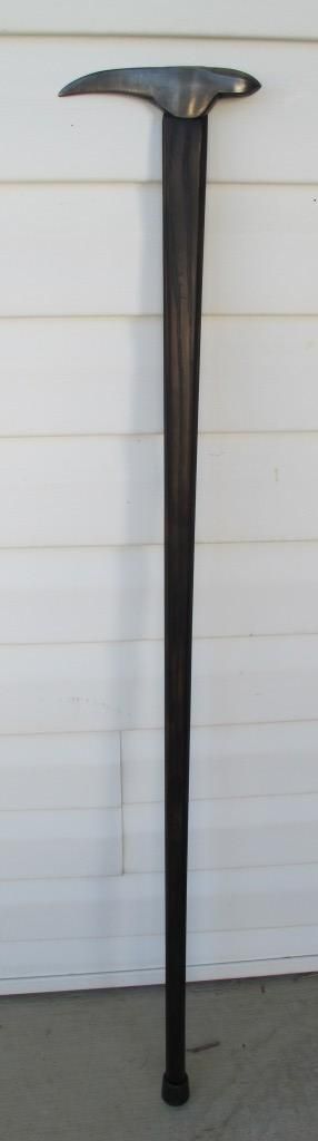

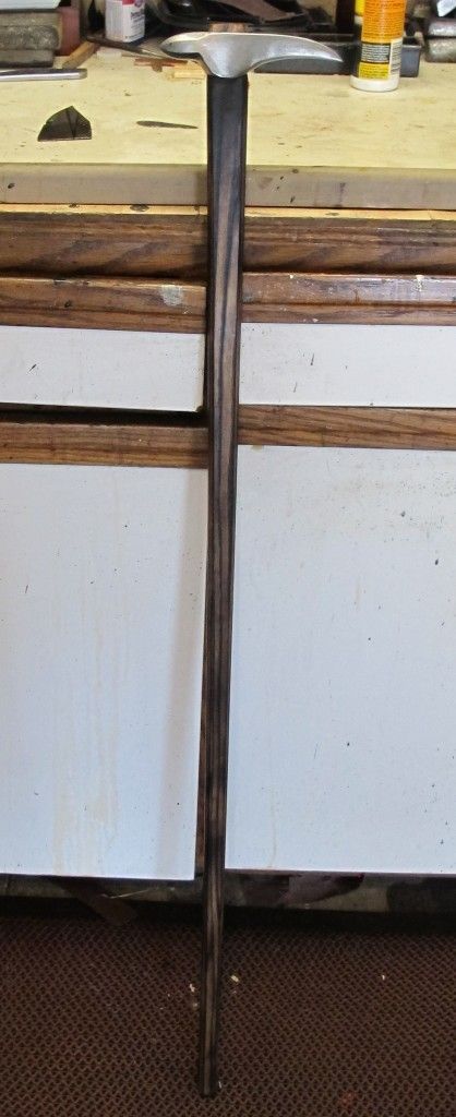

The shaft tapers from 1 3/4 at the eye down to 7/8 at the shoe and it still pretty strong with minimal flex. The plan was, to keep it as light as possible, velocity over mass. It was never designed as an entry tool, it's meant to be fast and agile and I sure as heck don't want to get hit with it, maybe giving it to my wife is a bad idea. :) Ive considered some small rounded brass or steel studs for grip
OK,...it was hard to tell the "scale" of the construction, and certainly 7/8" termination is still plenty strong and weighty for any potential lower end "work" on a bad guy. The photo looked like (or I "assumed" :rolleyes: ) it was starting from the usual 1" or so diameter, hence my comments.
However, the strong taper is still a potential concern were I to make one personally. Perhaps adding a slight "hand stopper" bulge just above the rubber cap if I get around to making one, or even a slightly thicker area at the base and adding in some finger grooves! :)
Another option maybe to come straight down with 1" or 7/8" diameter shaft material, with any additional thickness only at the head area and tapered perhaps a few inches below it.
If I had your set up in hand, I might consider adding a turned hardwood "accent" knob about 1-1/3" to 1-1/2" outside diameter just above the rubber cap. With a tight tapered fit and wood glued on, would be as secure as a baseball bat grip! (remove the finish on the shaft, of course) Adding a small 1/8" wooden dowel drilled and glued thru the knob would pin it to the shaft for a very secure grip.
Just thinking out loud here, BTW. I'm still drooling over the cane head you made up, and blinded by the beauty! :D
Beautiful work regardless of whether it's a weapon or not. :)

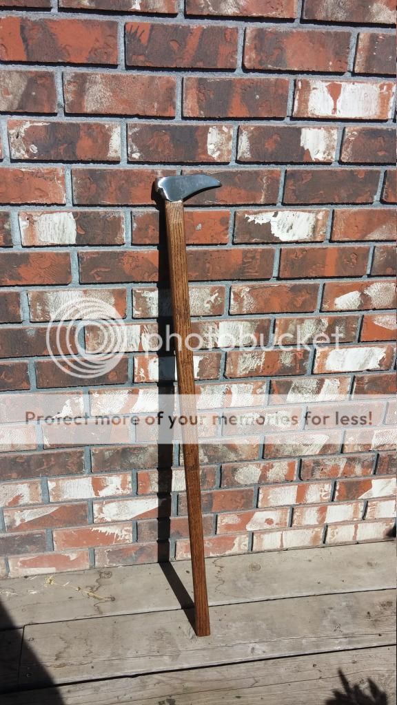

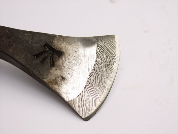

I am currently putting together a fokos (aforementioned "shepherds cane"), ordered the head from Adam Thiele, a smith in Hungary. Got a metal cap for the end that will accept either a steel spike or a rubber piece. Once the head gets here, then I'm off to get the postholer handle. I also settled on that being the best and most economical choice.
Archaeosmith Adam Thiele's work:
I will mask off the pattern weld, then do some final shaping of the metal for smoothness, then sandblast and parkerize it.

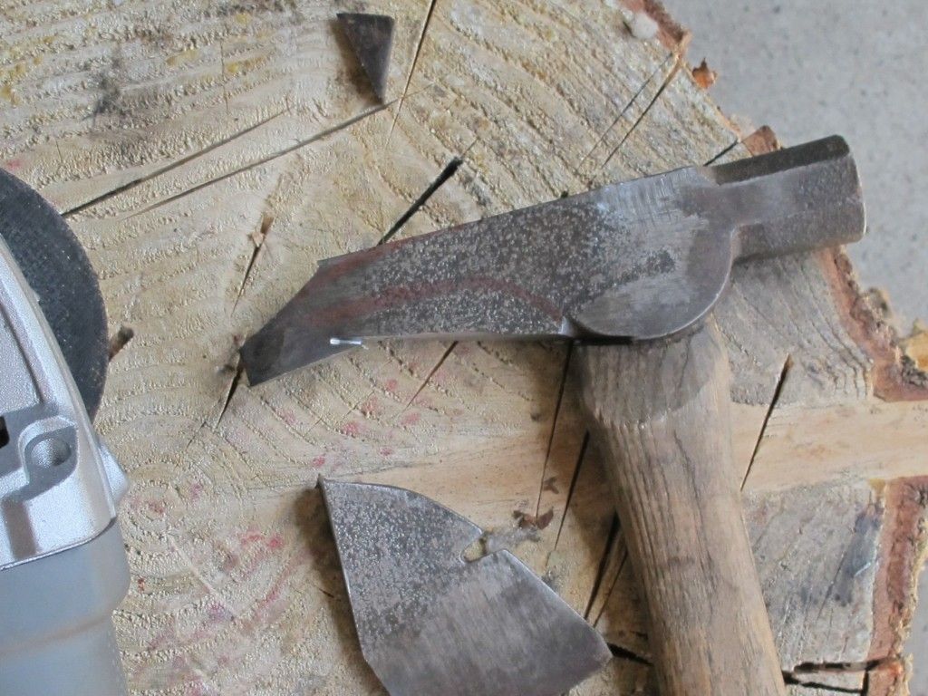

I decided I needed to try this out for myself...
I took the hammer poll off, thought it might look even less suspicious with the spike as the handle where it can't really be seen.

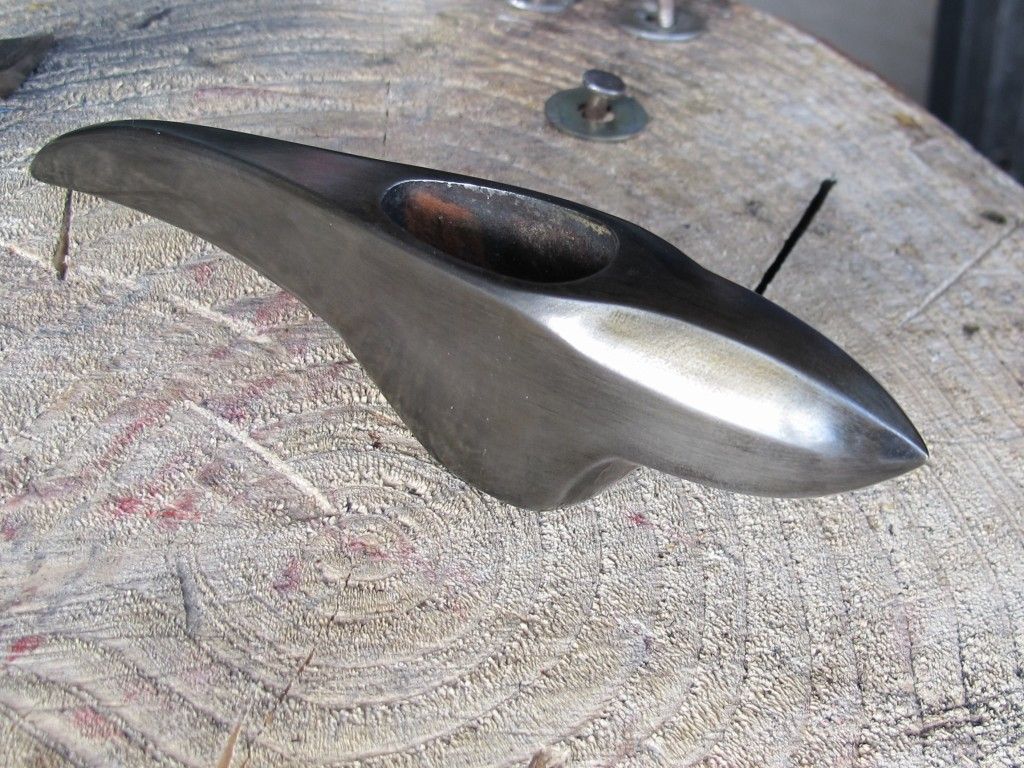

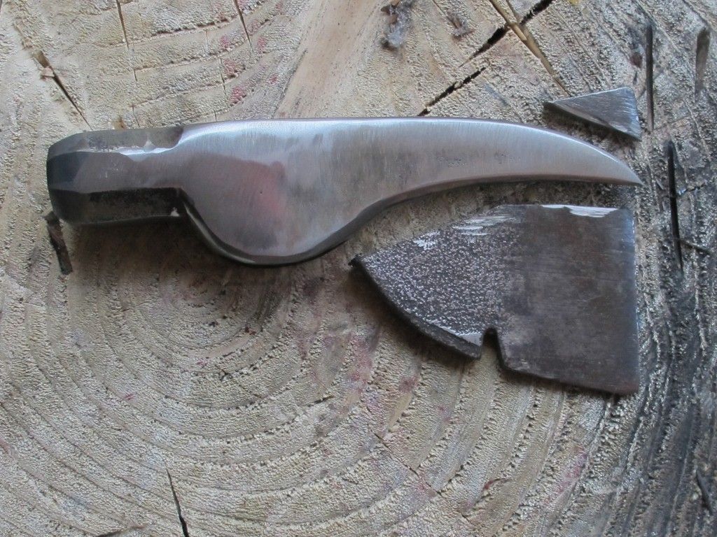

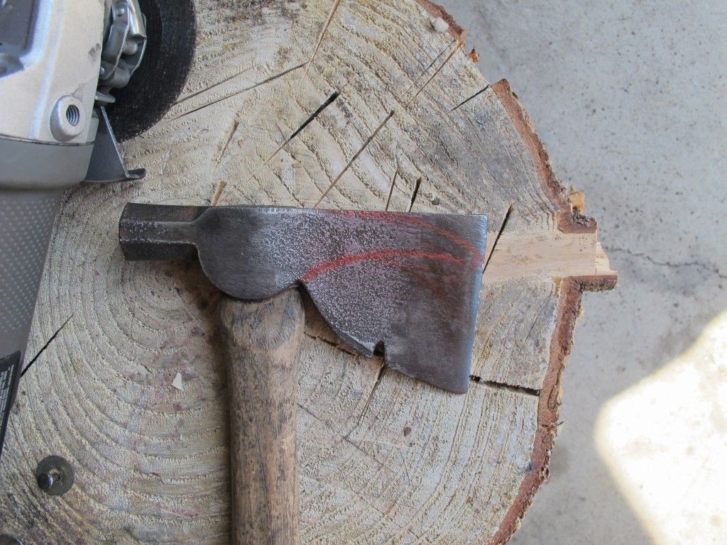

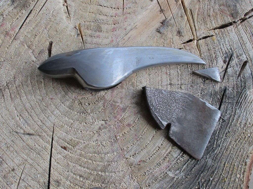

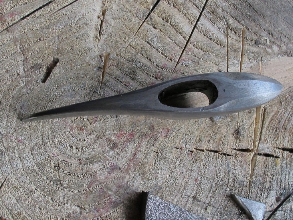

My latest project, I saw one of Beaver Bill's Bear Claw canes in real life and had to have one, but sadly it's way out of my budget.
So on a budget of $20 I'm re-purposing an old $5 hatchet to make my own Bear Claw Cane.

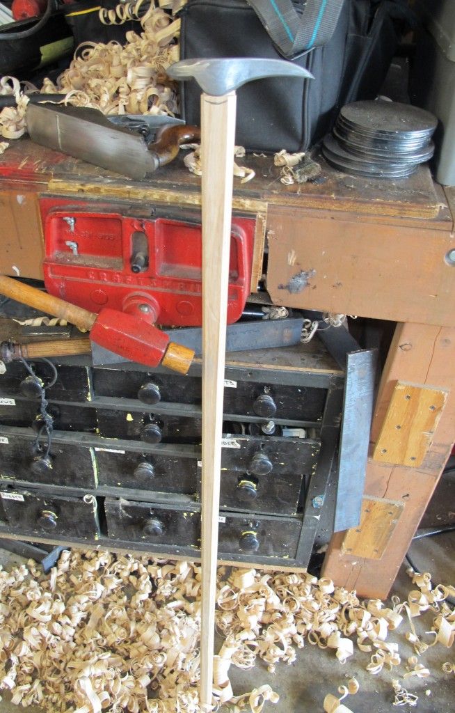

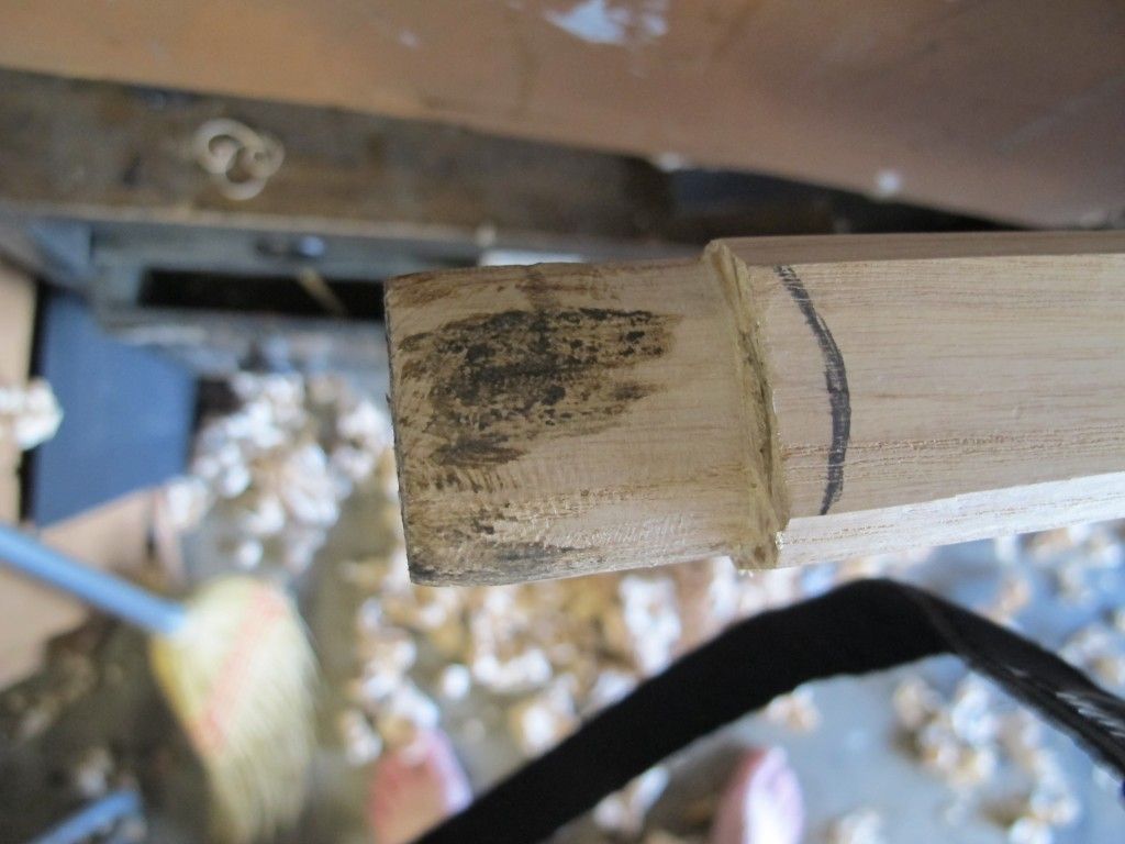

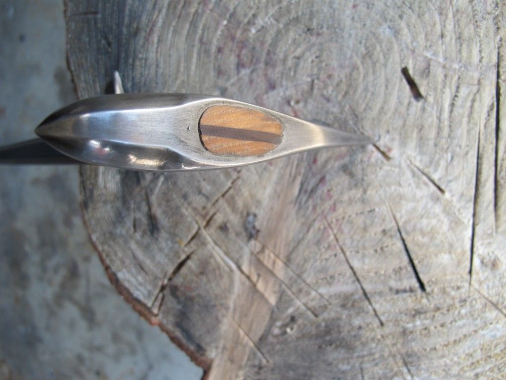

I went to the big box store to look at the shovel handles, they were just a tad small in diameter so I picked up a post hole digger handle. I had to rummage through a bunch of them to find one with good straight grain. It's made of ash not hickory but it should work just fine. After cutting off the attachment holes I still had 4 extra inches for a fudge factor. I used a plane to do the shaping the shaft More than half the weight of the wood wound up on the floor. So far $5 for the hatchet and $10 for the handle and I'm still $5 under budget. :)
I fitted the head to the staff before finishing it so as not to mar the polished head with tool marks from the fitting. I then gave the staff a quick burn, stain, and wax and set it aside until the head was polished and ready.

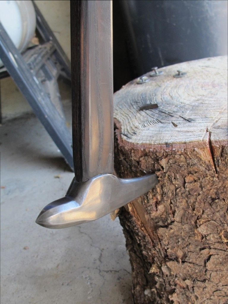

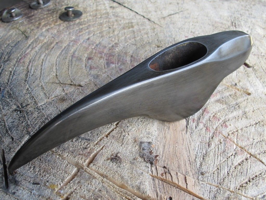

I finished the head with a lot of filing, emery cloth, wet sanding down to 400 grit and then buffing with a heavy cutting compound. I went with a cold blue finish, it's not perfect, but it's close enough for me.
I hung the head, cut off about 3" from the foot and added the rubber shoe. It's now ready for the street and it came in under budget.
