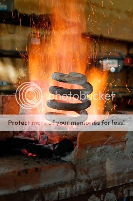

So on day one, we started with the standard blade material of the ESVO school, the giant truck coil spring - 5160.
This bar is a solid 3/4" dia bar, so it takes either some power forging tools (which they're fresh out of) or the next best thing, lots of hammers...

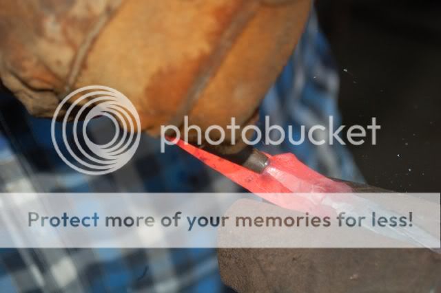

Mike begins the creative forging at the anvil reducing the bar to a beast...
The shape of the nose begins to form...
The eyes and the nostrils are set with a punch...
And the ears are split from the body. The chisels and punches he used the first time were immediately blunted when he used them. We re-sharpened them a couple times, with the same result. Then we figured out that once the dragon began to take form, the steel was no longer 5160, but had become some kind of prehistoric, draconian unobtanium which required a short trip to Mount Doom for some special tools. After that, all went well...

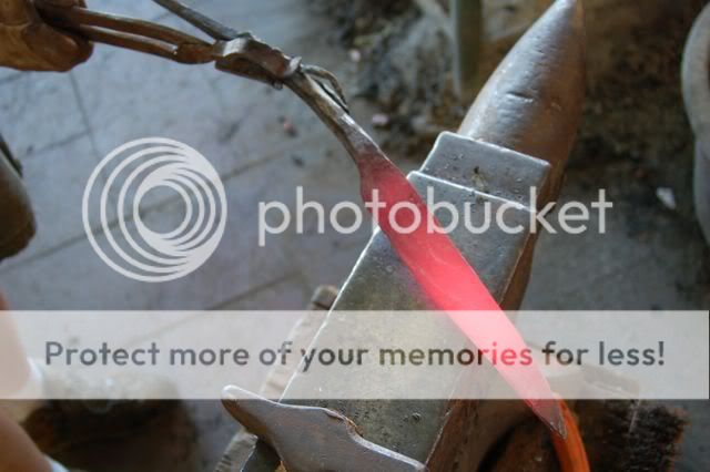

Mike stopped the dragon half way through so I could get the blade forged. It took some more gang hammering to get the stock down to a manageable size. I am a big guy, but I dislike hard work and avoid it when possible...
Getting the blade shaped, starting to look like a knife.

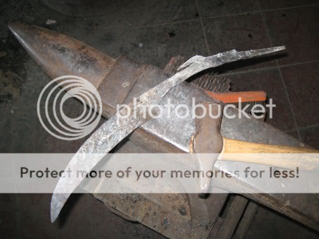

And this is the rough forged blade. We found a local iguana hunter who lives in the mountains and had seen the dragon asleep many years ago. He got a close enough look to describe the talons in detail and we worked very hard to duplicate the size and shape as much as possible. Tomorrow we get the dragon finished...

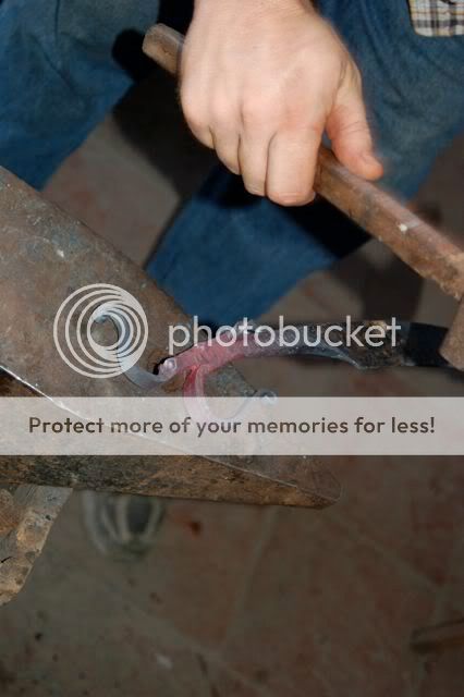

And what's a dragon without a tongue. The tongue is formed separately, and will be attached later...

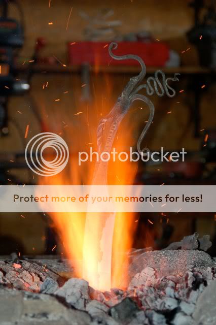

And the blade is normailzed to get it ready for grinding and heat treating...

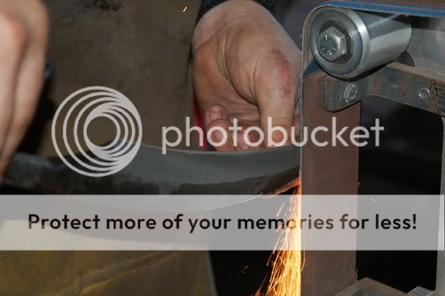

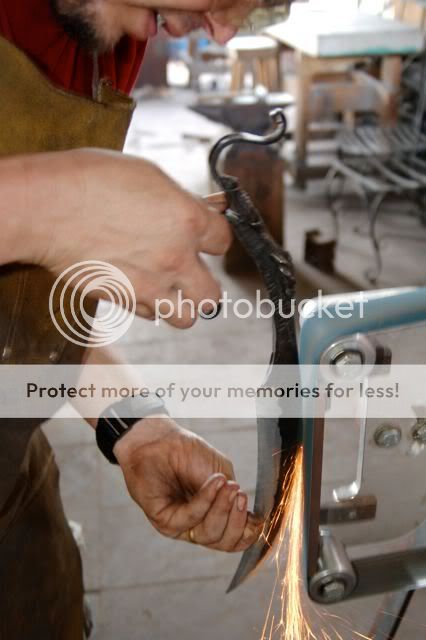

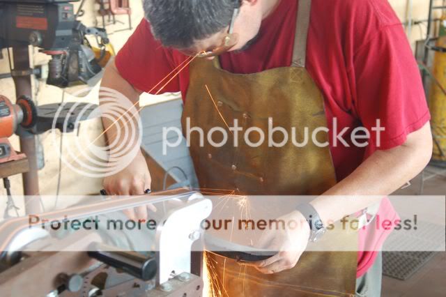

Doing the rough grinding. A few days ago, I took out the seven stitches I had in my thumb from a little slip with a knife a few days before I headed down...
Adjusting that curve on the spine to match the curve of the real thing.

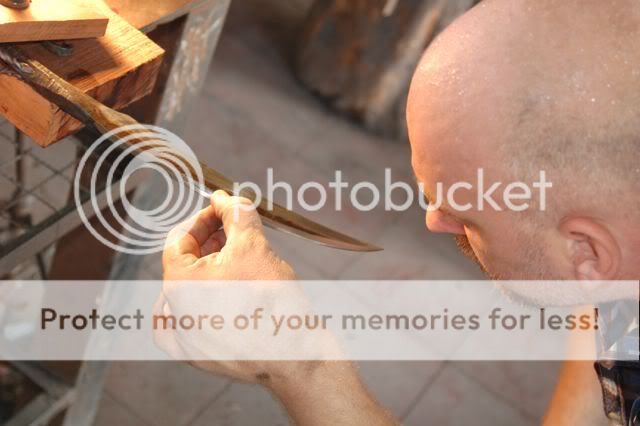

Checking the blade finish with a critical eye.
