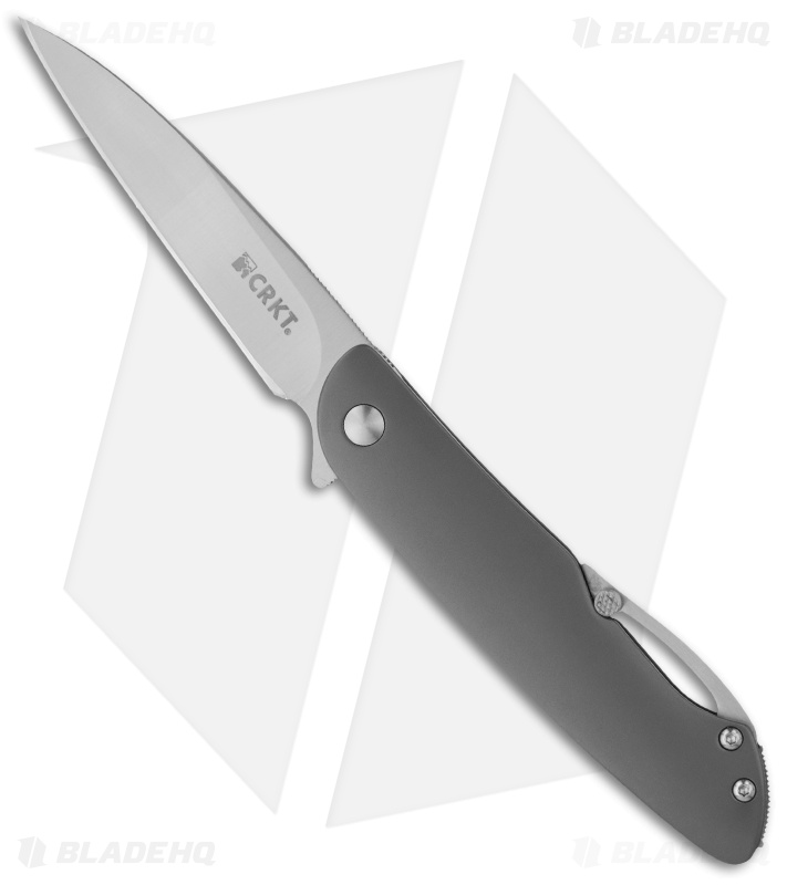

I like the idea of a spine mounted clip sort of like seen on the crkt swindle. The only issue is where most right handed people clip their knives in their pocket (on a pair of jeans they normally clip a tip up knife so the blade is against the seam closer to their hip, opposite the seam closer to the zipper) a spine mounted clip will make the knife sit backwards to what they typically prefer. Usually people like the blade to sit against the seam as a saftey feature.

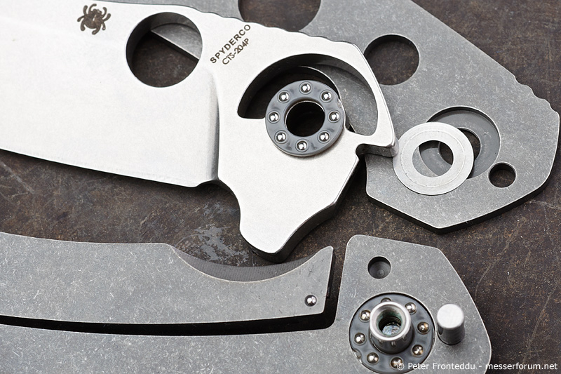

What I wanted to ask was is this going to be on bearings? My dream would be a well made phosphor bronze washer pivot which can be an outstanding smooth system. Bearings would be fine too, just make them caged bearings please! No loose bearings like IKBS.

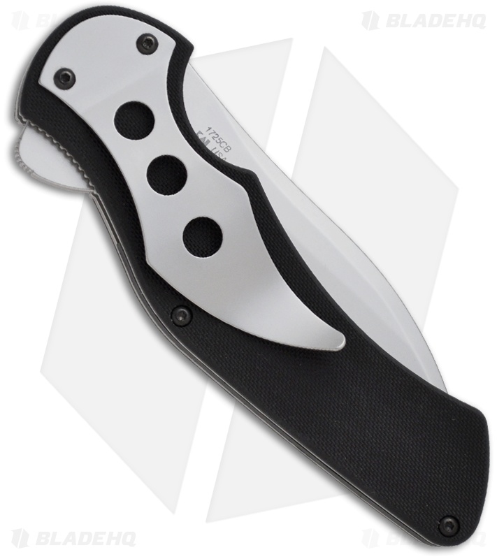

Please watch this video to see how the maker used a backspacer to fit a large blade in the handle while making it impossible to touch the blade.
Skip to 20 mins in to see backspacer feature.
A backspacer might help you prevent the blade from being able to be touched.
Those clips are getting a little crazy for me haha. I've never tried the swindle or the Razel in pocket, but I know some people are into those clips. I think I'm going to stick with a 3d machined clip. I have an idea on how I want to clean it up to better match the simple lines of the knife. I'll post pictures later.
As far as bearings vs washers... it wont be loose bearings either way! I was originally going to go with caged bearings, but I'm not sure it's needed with this lock type. I'll have to look closer at those other button lock knives SpySmasher mentioned and see if they are using bearings. It might be plenty smooth on just washers. There's so many "titanium flippers on bearings" that I was planning on just doing them from the start.
I am no knife manufacturer but I imagine it is harder to get a perfect action on washers than it is bearings.

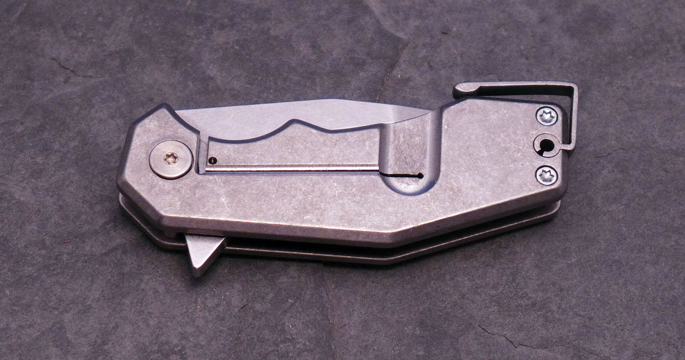

Or if you are going to have a stationary stop pin please do something like this.
(I can’t get the pic to copy. Look at post #57 in this thread plz.)
