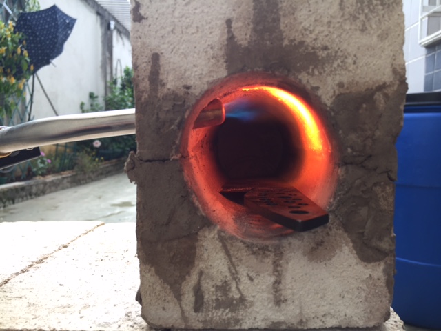

I noticed with the improved torch that there is plenty of heat, but I can see how I am not getting the swirl I need. The front 1/4 of the chamber isnt getting nearly hot enough. Gonna play around with the torch angle and roundness of the chamber to improve.
Roundness, contrary to what DiamondBackIronWorks says, is the key to an efficient forge. Without the proper swirl it is a blacksmith forge, not a bladesmith forge. I dug up a couple old images to show this, one of which is with the aforementioned MT245C. Yeah, you definitely don't need MAPP. It'll get expensive real quick.

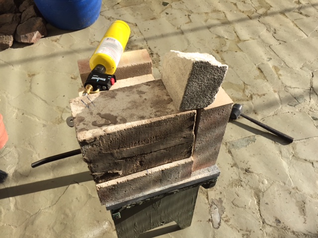

As I said earlier, I put a fire brick in back now to adjust the heat. Some times maybe just about an inch of opening in the back.
I use my cigarette to adjust the vortex/ swirl with puffs of smoke.
And you can see the draw from the front with smoke.
Not the healthiest way but it's what I had on hand.

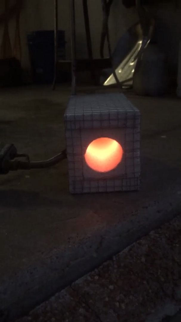

Can anyone help me out here? What external surface temperatures do you get with such a 2BF? If properly coated with refractory cement on the inside, why couldn't I just wrap the bricks in aluminum tape rather than hardware cloth? I've been planning to build one this weekend, but wanted a little feedback from you experienced guys first.
Your torch isn't powerful enough. I have the exact same one, and had the same problem. I am also wondering what to do about it, anyone know?
Sorry, I never noticed your question, LoD. On a well used Atlas, you can expect around 400°F on the outside of the metal shell, even higher at the front and back near the exits. Without a metal shell to dissipate heat, you can probably expect 500°F and above. Aluminum tape uses adhesive which burns well below this temperature, then the tape falls off.

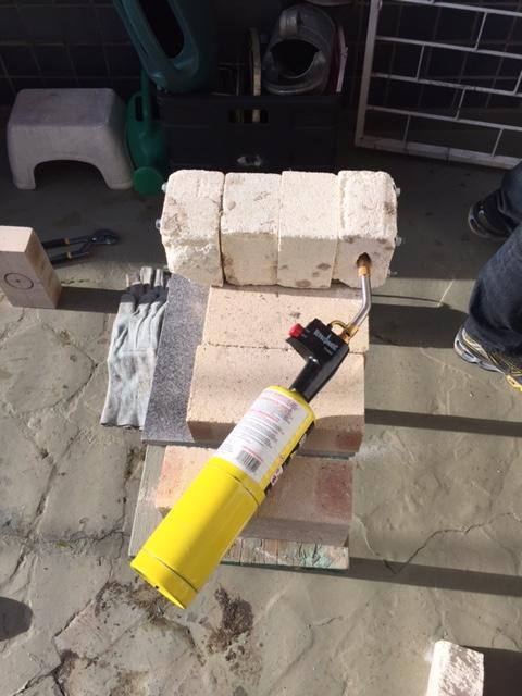

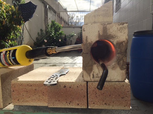

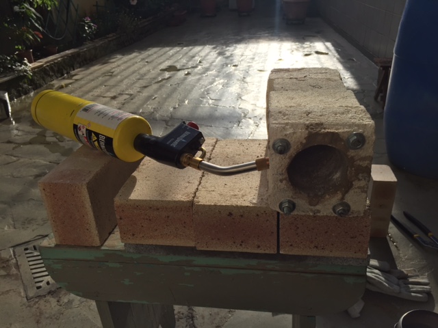

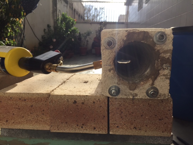

Hello everyone I've tried both designs ( the two brick one and the one suggested by the atlas knife company). Sorry but I had the make the tests during the day, I'll try later to make them at night
two brick forge:
a small video of it working:
[video=youtube;KD7tDWGVPzI]https://www.youtube.com/watch?v=KD7tDWGVPzI[/video]
Now the design suggested by the atlas knife company:
and a more complete video of the process:
[video=youtube;nvpXxkEM3W8]https://www.youtube.com/watch?v=nvpXxkEM3W8[/video]
My impressions:
In both cases I was expecting higher temperatures, which could be explained by the diameter of both holes (6.5 cm). Altough I meneged to put both test knifes on the austenitic temperature ( seen by using a magnet) and on both cases I was quite happy with the file test.
On the Two brick design I had to put those bricks on the back in order to retain more heat but on this desing I got a better circularity of the forge. Now, I'll try to make a second two brick one with a smaller diameter ( 5.5 cm)
thanks a lot for the tips and information guys!

The tip of your torch shouldn't be so far in. The brass will melt if it's in the chamber and the forge is working right.
Second, not sure that you'll get enough BTU from that torch, even with MAPP.
Third, 6.5cm(I use 67mm) is ideal for the chamber to insulation size on a 4.5" square brick. (I love mixing standard and metric!!!)
Fourth, the torch angle looks much better in the last video. Wholly inadequate in the pictures and first video.
Fifth, resistance to heat isn't the same as insulation. Seeing that you easily carved the bricks, I'm going to figure that they are insulating. Another way to be sure is if they are heavy or light. Heavy bricks don't insulate, light ones do.
