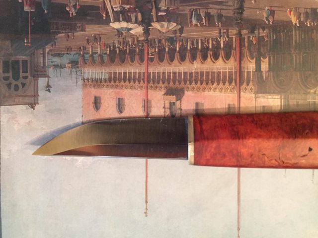

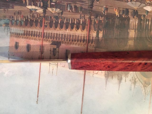

I was really happy with this knife:
UNTIL THIS HAPPENED...
I sanded through the handle and into the epoxy holding the tang :(. My plan is just to fill the holes and live with it, since the knife is just for me anyway. Unless someone has a wonderful suggestion.
Ouch, that hurts. I would replace the handle, as the blade aka the hard part is done. Even if it's for you, you want it to look nice so you can show it off.
As JT said, replace the handle and do it now. Or throw it out! You will be forever sorry if you don't. It sure looks good otherwise.Don't you deserve the best that you can make and you will pick it up to show.

Am I looking at it wrong, or is the entire tang exposed? If so, it's a structural issue and would not be safe to use. You should redo the handle. Take it as a learning experience.

Aside from that, I'm really curious as to how big of a hole did you drill in the wood for it to come that far out to the side?? I looks like the hole is three times wider than the tang/spine thickness for you to grind into it at the outer part of the handle. I may be looking at it the wrong way though.

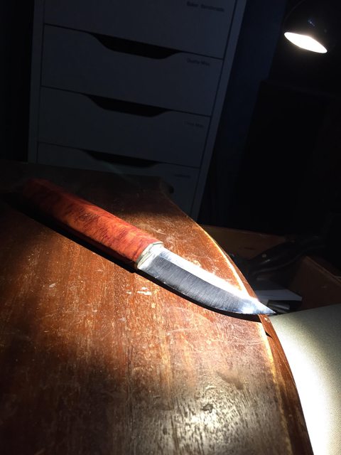

Its got a wide tapering tang - here is a photo:
I had to drill a 1/8 hole the length of the tang, then a 1/4, etc, all the way up to a 9/16th's hole towards the blade side of the handle.
The tang goes at least 95% of the length of that long handle.
What may help you is to scribe a center line on your handle. Hold a straight edge along the spine of the blade and mark the handle. That should help keep your grinds centered and away from the void in the handle.
Overwrap that area with hemp cord and epoxy it.

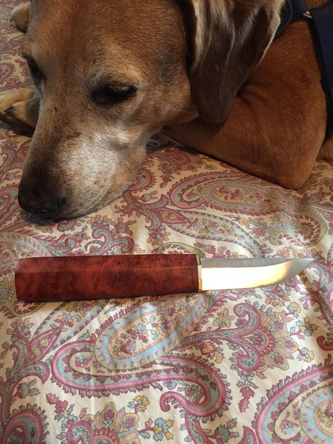

One funny thing about this post: when I put my photos on Imgur, lots of "civilians" say them. They were worried I was going to hurt Sadie, my dog - who I'd give my right hand for...
Right, because non of them ever used a kitchen knife with a pet in the room lol
To be fair, that community makes Youtube commenters appear sophisticated, rational and intelligent in comparison.
That error is common. Most of us have done it a few times. You can remove the handle and cut it off past the bad spot and then add a new bolster block, or replace the handle. In some cases, you can grind the handle down a bit thinner and wrap as suggested by Adam.
