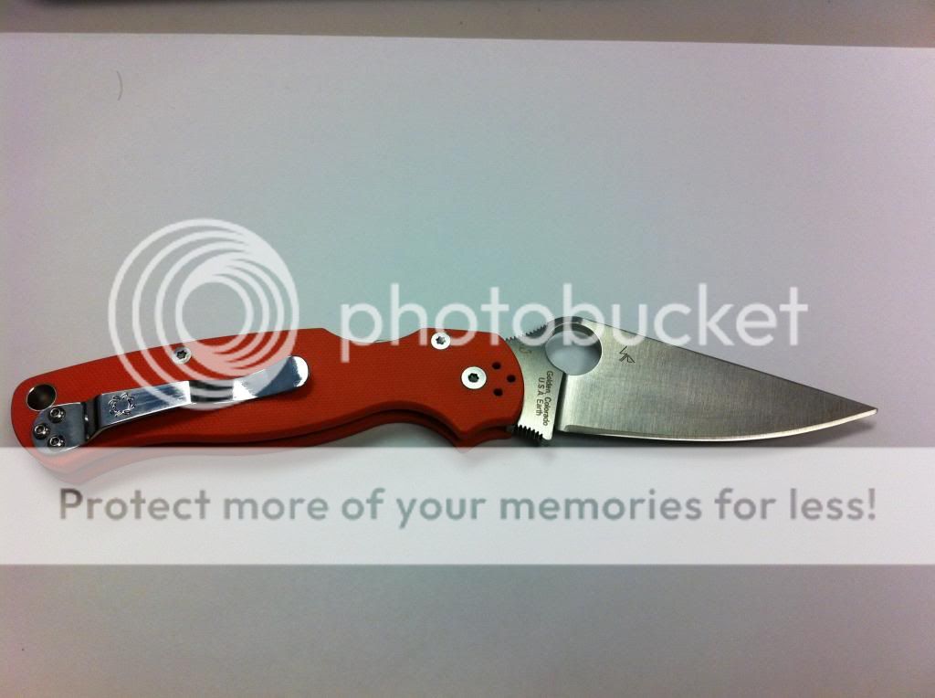

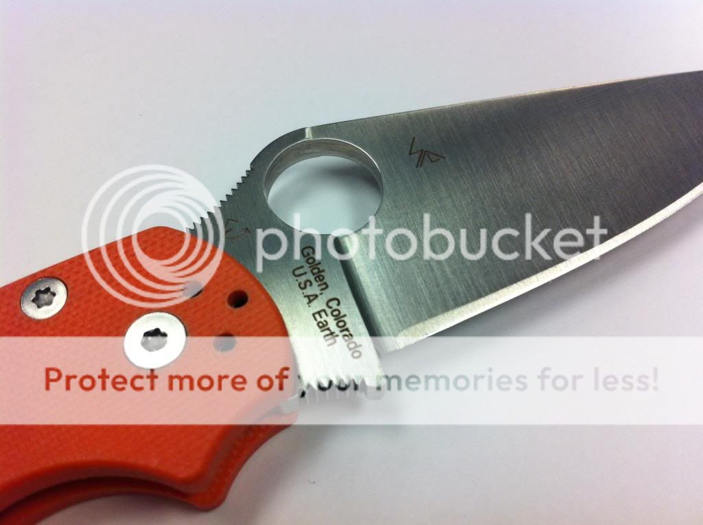

Here is the picture of the knife. It has the S30V steel.

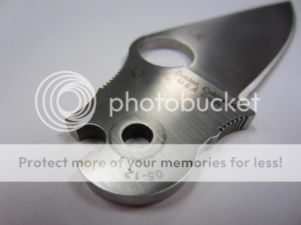

Here is the laser marking, notice it is not black but rather brownish orange.

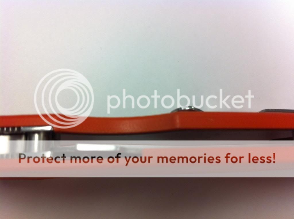

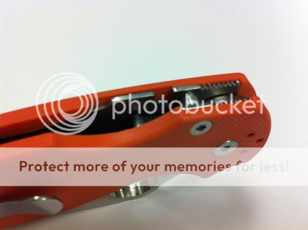

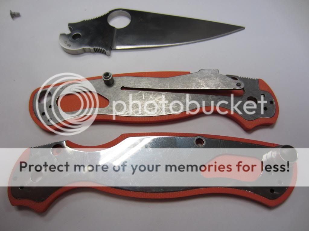

Here is the full liner, no milling.
Compression lock....I've seen fakes Para 2 with liner lock but not compression lock yet.

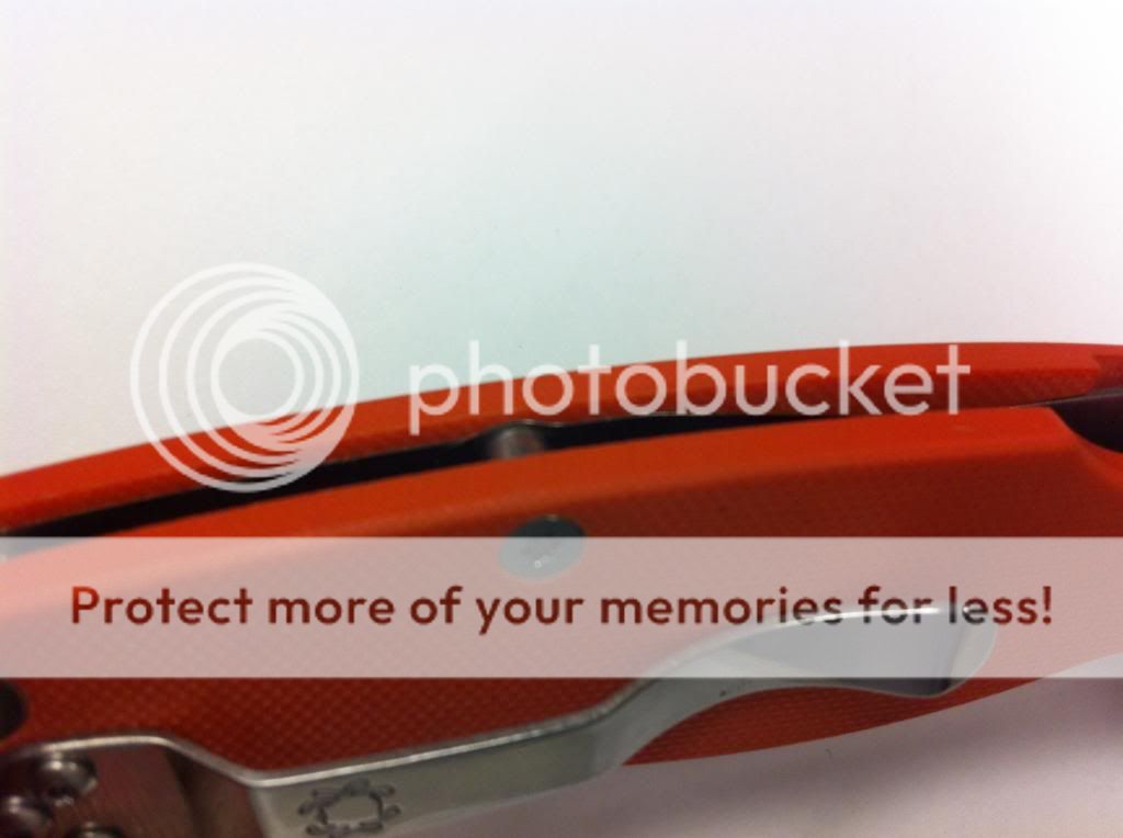

Also the rear back spacer, the spacer have a flange that inserts into the liner. Current Para 2, it's flush. If you look close to below picture, you see how the liner arcs around the spacer, the G10 is also milled precisely like that....

I'm pretty sure what you have there is a fake, the fakes have gotten very good but the tell tale signs are non milled liners, jimping not angled back on the top of the blade and also more of a v cut rather than u, pivot torx and scale torx that are the same size, and the g-10 will have a different texture. I'm sorry to say but by looking at those pics, it seems like you bought a fake. I'm also pretty sure the fake websites sell an orange PM2. Sorry for your luck, the best defense against purchasing fakes is to educate yourself on the minor differences between the fake n real thing. There are a couple videos out there that go over them, that's where I learned.

Also, the laser marking does not look black, more like an dark orange laser mark.
Just as a data point, the etching on my orange and brown Para models looks dark orange to my eyeballs too. That would be quite a copy job if it were fake.

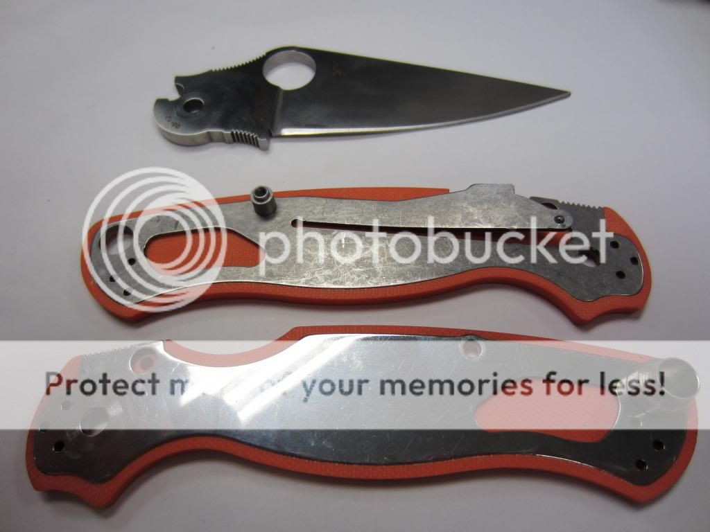

Ok Mods, please help me move this thread to FAKES & KNOCKOFFS....this thing is by FAR the scariest i've ever seen. I've seen a FAKE Millie and were quite impressed but this thing is crazy. I will post Side By Side with a real Para 2. Here is some pictures after taking this thing apart.
do you notice the different color of steel on both liners....the one above is call Spring Steel...for compression lock. The bottom just low carbon steel.
There is always the possibility of a Franken-knife - not uncommon with sprints. You (we) would need to see side by side comparisons - my visual memory doesn't extend to the details of the P2 (although I've had several apart for cleaning and lubrication). Whether it is a Frankenspydie or an outright fake is still up for grabs.
