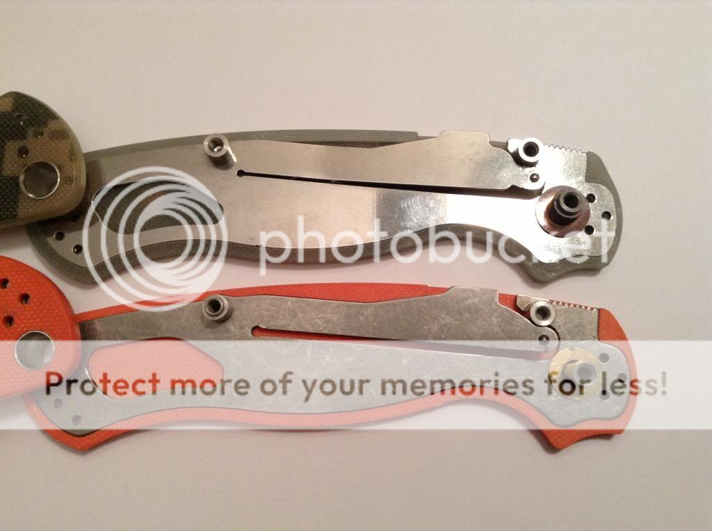

Full Liner on a PARA 2 orange
It's fake I'm almost positive the fakes I've seen are almost identical except for the one cutout in the liner and the cutout for the compression lock is a even half circle instead of a slightly obtuse half circle that's stretched out towards the back end witch was supposed to make the real one more ergonomic to disengage.

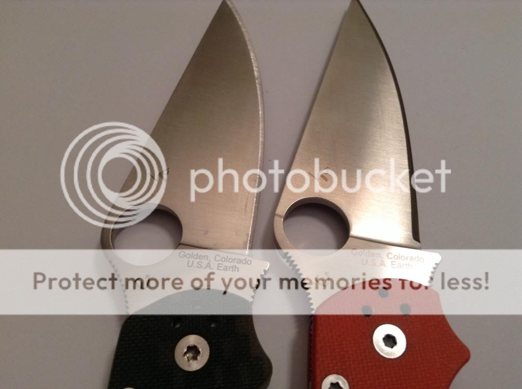

The liners are all wrong. Won't say any more, just gives the counterfeiters something to work on.
How is the steel on the knife??? Is it cheap Chinese junk, or good stuff?
Edit: Meaning the blade. Spydie runs their S30 pretty hard, and Chinese are good about writing s90v or something retarded insane, on a 440a blade. That should be a tell tale sign.

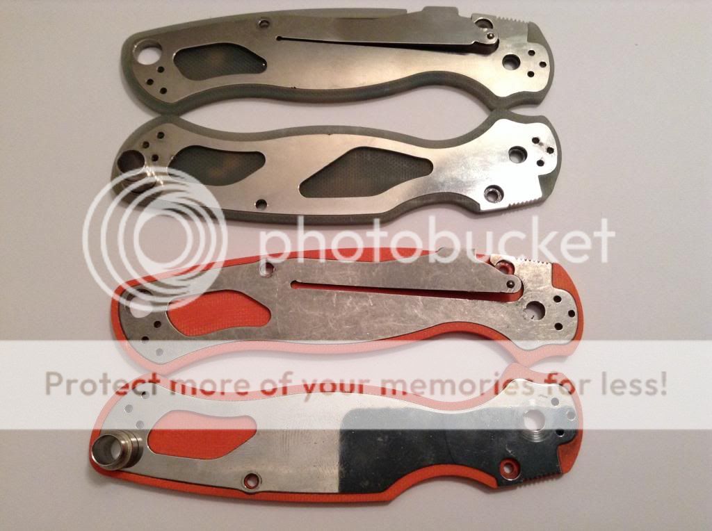

Good thing is that you cannot swap the fake liners into the real scales....they don't fit. I also notice the holes on the real scales are drill concaved so the flat head screw will sit flushed. The fake scales are drill without a concave.

It looks so close. If they didn't get lazy towards the end it would be a perfect fake. One more mill on the non locking side and a quick polish on the lock side and it would be almost exact. It also looks like the real one has more of a belly on the handle.
I just check the Torx size on the fake. The Pivot is T9, scales screws are T8. The real para Pivot torx is T10.
The locking tab is quite a bit different. There is also some deformation on the fake on the underside of the tab. Not sure the exact role that area plays, but that knife could become unreliable. Also, the fake does not have that little imperfection on the liner that has been discussed before as a product of an assembly process.

Looks like the bottom spacer is different.
Aside from the liners, the stop tab, and what others have mentioned, the liner on the fake has some radiusing where the other doesn't - and if you look at the places on the fake where the bottom spacer is seated, there is extra metal there - that's actually an upscaled feature on CRKs. The worst thing to me is that they have the plunge lines looking closer - usually fakes do not terminate the edge grind like the real versions, and these are much closer. It isn't close enough to the flat of the ricasso though, so in fixxing the plunge they have encountered another problem.
Even though there are many clear differences, there are certain things that don't add up about labeling it as a clear fake. I would have to hear from Sal before making a call - did you check to see if the indentions from the manufacturing process are present on the fake's liners? It could be a prototype or the orange Para could have been a run where certain things were changed.
