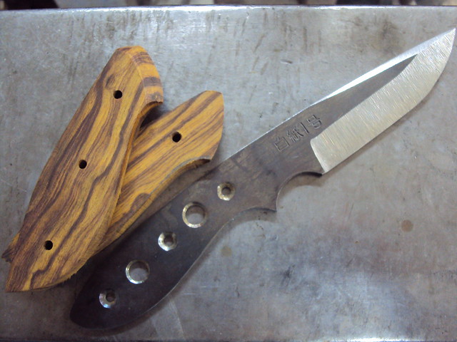

You missed the point of my post completely. Regardless, here is a knife I made:
Can you see how this knife didn't take a trip to the belt grinder after being hit with a hammer?
Looks like it took a trip to a belt grinder somewhere along the line. I don't think those grind lines leading from the spine to the edge were caused by a hammer
What layer? You just have to set the cutting machine to an ''organic'' curve instead of a structurally weaker straight shoulder as found in ka-bar and buck knives.
I think you misunderstood. He was referring to the thickness of the tang decreasing from ricasso to butt. I think you're referring to the shoulder contour of the tang where the guard goes. I agree with your point, but that's not the same thing as uniformly tapering a tang.

Looks like it tooki a trip to a belt grinder somewhere along the line. I don't think those grind lines leading from the spine to the edge were caused by a hammer
Actually, no. Revolving waterstone. It should be noted that that was after temper - pretty far removed from the hammering stage.
Ahhh....gotcha. Was it a manually powered stone? Would love to see a picture of your setup. I do think that this isn't at odds with the point that was being made: some sort of mechanical abrasive removed stock to shape the knife rather than an impact displacing it. I don't make much of a distinction between a wheel, belt or file other than that some are powered and some are manual.
I guess it makes a difference to a maker who wants to make a knife using no power tools, and I totally respect that. I have mucho respect for a guy who can get even grinds using hand tools.

Perhaps I did, because as I said, tapering tangs and the point at which the bevel is ground has absolutely nothing at all to do with forging. I have 16 blanks ready for heat treat, then they will be hollow ground afterward. None of them are forged.
Stock removal has nothing to do with doing a disservice to the customer. Quite a few knives are made like that. Bob Loveless, SR Johnson, and many other celebrated stock removal makers tapered a tang just fine, and their 'disservices' go for high prices.
Forging vs stock removal has absolutely nothing to do with the quality of the steel, the properties of the steel, or the soundness of the overall design in the 21st century with a competent maker. Since you tempered that blade, then maybe you also austenized it. Maybe you stress relieved it as well. And some normalizing cycles. Perhaps a spherodized annealing. Enough thermal cycles after forging, and a look under a microscope at 1000x wouldn't show a difference from stock removal. Forging the secondary bevel before heat treat vs grinding it in doesn't make a difference to cutting performance. Tapering the tang by drawing out the steel isn't better than grinding it in. Did you drill those holes in the tang or punch them through on the anvil? Is one method a 'disservice' compared to the other?
