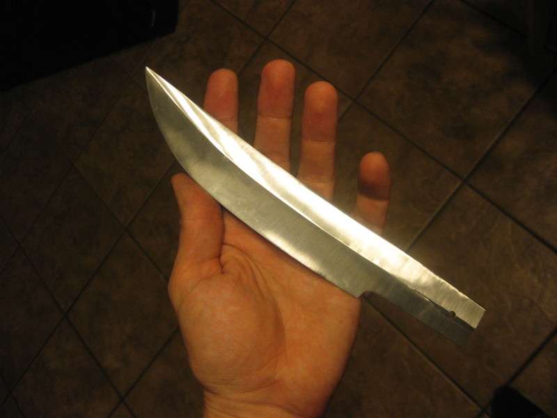

I have had the amazing opportunity to handle/use a couple of Tom Maringer's recent works, and it has convinced me to try and make a knife that is double edged and requires a habaki. So while part one of this adventure is done I now have to make my first habaki!

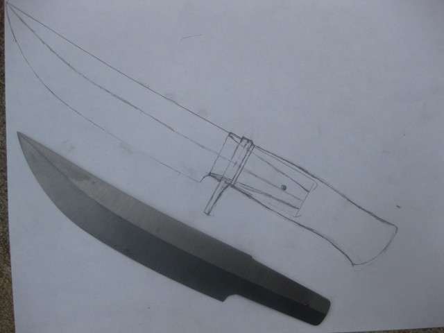

I would have to agree with you. However, I am not planning on going full on Maringer with this one. Despite the fact that the toggle tang is a VERY cool system. I am currently planning on using some nice wood a guard probably some spacers and a pin.

What I currently have envisioned for the handle looks more like an American fighter/bowie style handle. So no bamboo mekugi more like a copper or steel pin.

Here is what I am currently thinking as far as the handle goes:

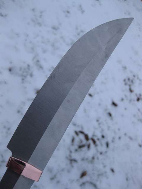

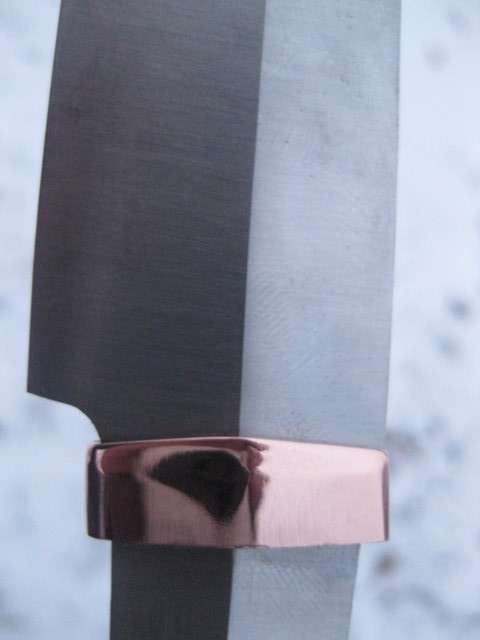

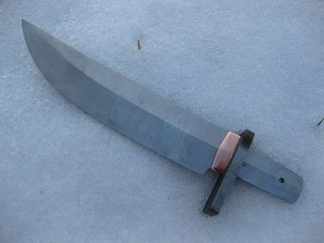

It took me a while but I have finally started working on the habaki. It was fun to bang on things with a hammer. I guess I better get my forge set up.
Looks good. I'm assuming you are going to braze/solder the habaki closed, and cut off the extra.
What material are you making the guard (tsuba) out of.
Stacy
Currently the plan is to attempt to tig weld it closed, and the excess will be removed. The guard will likely be wrought iron.

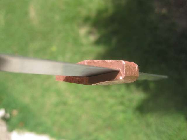

Ok, so I got a bit sidetracked! I dropped the whole welding it up with a tig thing as a good machine is not inexpensive. This being the case, today I went ahead and soldered her up and did some shaping.
