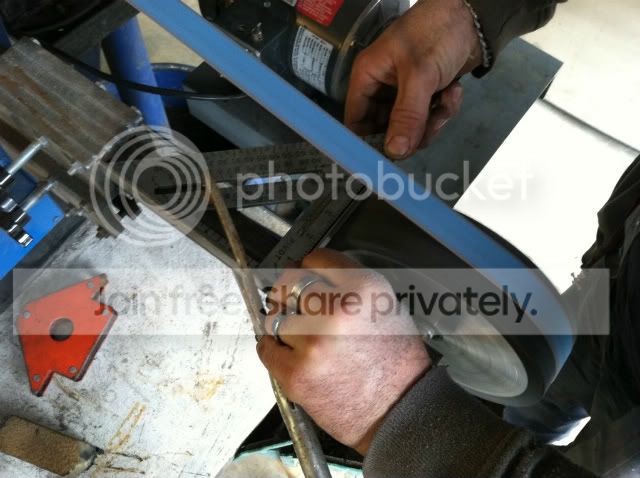

Monday I re-mounted my new 8" serrated wheel on a tool arm and then broke the wheel in. It was a budget wheel. It was 2.05" wide, un-balanced had rubber haning over the side.... I trimmed it to 1.995. I then clamped a square to the tool arm and used it to guide a file into the wheel from the backside while it was running at 10% power to removed the big dip in the center of the wheel. It now runs MUCH smoother!
I also ordered a new 1.5Hp 3Ph 1725 RPM motor for my disc grinder. I picked up the new switch for it today so I can run it off the VFD for my GIB.

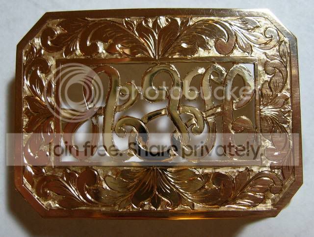

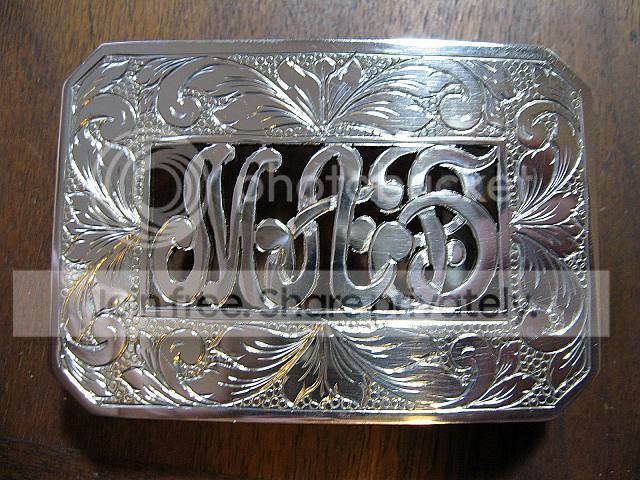

A few belt buckles that I did recently. I enjoy doing different stuff!
Gold-filled
Sterling silver
Nickel silver
Gold-filled
Sterling silver
Nickel silver
those are awesome my friend, I dont know why I never thought about people making belt buckles.
I'd think you can come up with some awesome buckles, those look nice.
On a side note, the only thing that I have going period right now (and only on weekends that I am home from college) is the repair/restoration/thorough cleaning(in many pieces) of a true 70's vintage jubilee brand dixie air horn......I still can't get the thing to work.....one day I will..
You know, buckles are fun to make. Any knifemaker can make one. They don't have to be fancy. If anyone here wants to make one, I'll be happy to help!
I own one buckle like these (aka: not the usual type you find at clothing stores). I now want to try to make one. I have looked at the one that I have and they are actually very simple, the more designs on he front, the more complex but hey, they look awesome and work, and to me, can very easily carry sentimental value. I know the one that I have I got when my dad died, I have worn it almost every day since I found it in the bottom of our gun safe and put it on belt.
I believe there was a thread earlier about a belt buckle as a weapon, making your own could easily let you make one suited to that task rather than having to find one that doesn't look threatening.
I just keep thinking offer
Stuff I could do. Now I will have to try
Again though, very nice work
How to you make the latch/pin/piece that goes into the belt?
Jeez Bill, nice buckles! I bet you could make some really nice sword fittings with that sort of openwork and engraving.

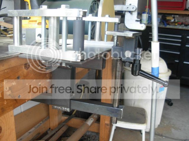

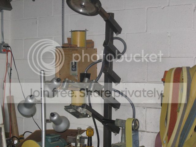

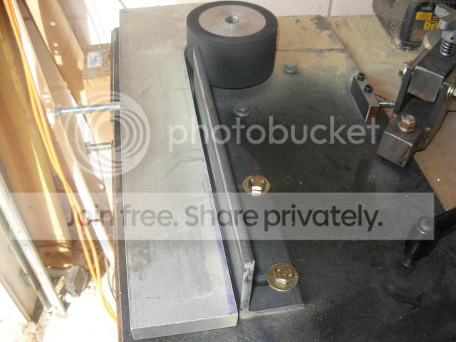

A bunch of new additions to the shop for me this tax season ;)
Built a 5 slot tool tree
Nearing completeion of my horizontal grinder build.
Building a buffing attachment as soon as I'm done with the grinder. Thanks for the inspiration and sharing your ideas !!!!
Also going to build a godzilla tool and picking up a heavier hammer for gross stock reduction (tangs)
I'll have some leftover materials from my projects for a plunge lapping plate and a fixture to hold the knife by the ricasso.
In addition to building tools I also picked up a rotary platen and have a carbide faced file guide on the way from Bruce Bump.
Alot of exciting additions this year. Sometimes it's difficult to stay focused on the big picture and long term goals as a maker and take the time away from making knives to build tools. I already have a complete month of my available time on the tree and grinder but thinks it's worth the investment of time in tools that should provide a lifetime of service.
Here's a couple teaser pics-
