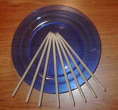

G-10/Garolite is pretty stout stuff, I've made fighting sticks form 5/8" rod that we have yet to break. I've seen seen it listed at 38,000 psi on some charts. Here's some chopstick I made from small G-10 rod.

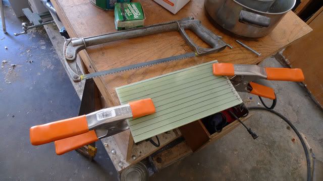

After reading this I bought a sheet of jade green g10 from http://www.usaknifemaker.com/ to make some. It was the cheapest g10 I could find, g10 is apparently pretty expensive...
arrived today, didn't plan on making them immediately but I couldn't resist and had nothing else to do for 6 hours.
10.5"x5"
tried a hacksaw, terrible idea. it worked but it took way, way, way to long.

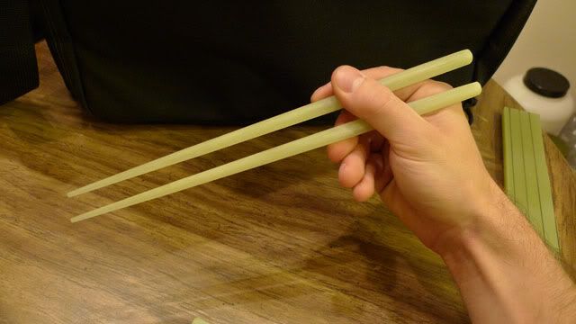

I don't have a shot of them in process, but these were ground to shape on a craftsman 4x36" belt sander in the vertical position. the shape was roughed out on the rollers and the taper was made by pointing the chopstick point down and pushing it into the flat platen and rolling it in my fingers. kind of ghetto, but worked really well.
final product, 4 sizes: 6.5", 8", 9", and 10.5". You cant see it even in the full 10mp image because they are slightly translucent, but it goes from round at the tip until the midway point, then becomes square with rounded edges.
mini 6.5" pocketable ones
8", perfect size for my hand. I'm glad i made the 3 sizes, cause both above and below just don't feel quite right.

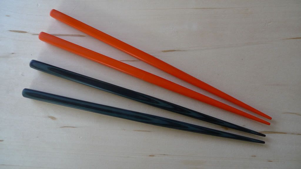

finally got around to making a few sets for friends as gifts (yes, 2 years later o_o ) and made a black and orange set to see how they'd turn out. I wish I had thicker blue sheets to use, but in the end I think I still like the jade best.
It's hard to stay uniform with a sloppy 4x36" belt sander, but I tried to keep a range of +/- .010" at both ends, and keep the center line of the taper in the same place.
