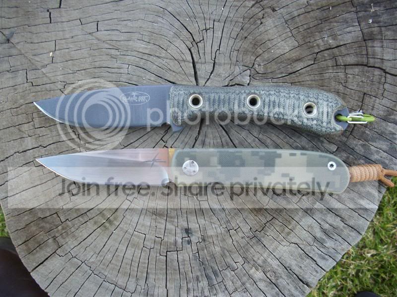

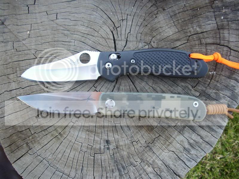

Ok, before I start some background. I met Gareth a year ago at our local knife show. He is the only frame lock maker in South Africa at the moment (that I know of). Here are a few pictures of his SA hunter model next to the Insingo.

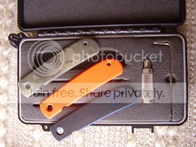

Price: R2000 for the knife, R200 for each extra scale and R3000 for the entire kit as seen.

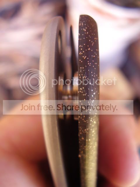

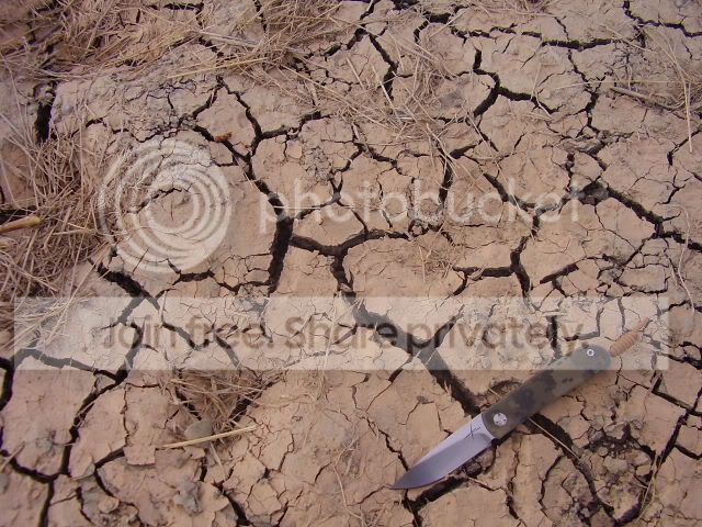

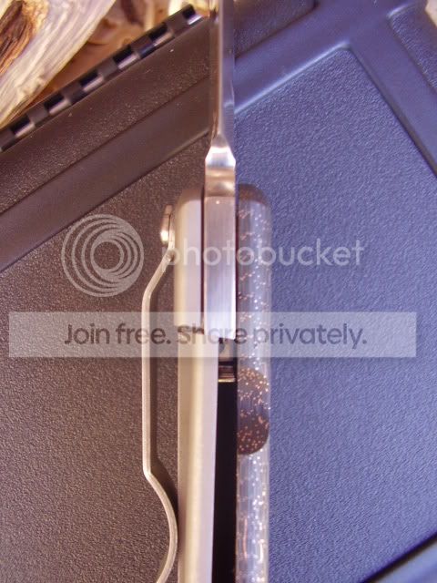

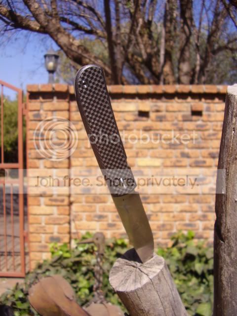

General observation, wow! The lightning strike carbon fiber is a beautiful thing! The knife is light, thinner and smaller in the pocket as expected, however it sits comfortably in the hand and different grips. The pivot is LARGE (CRK Umnumzaan), action is smooth. Really big standoff (CRK Umnumzaan and Rick Hinderer).

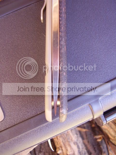

The blade retention is really good, strongest I have of my limited frame and liner locks. Easy to open due to the same Lip opening as on Burger EXK knives. Lock is solid. No play open or during the motion of opening and closing (ie side to side ply around the pivot while opening or closing). Disengaging the lock gives you a nice thumb workout, very sturdy.
Everything is pretty much spot on according to my requests. The Pocket clip also functions as a stopper for accidental over extension of the lock (Rick Hinderer). You can feel it pushing against the lock when you try and push it past the frame.

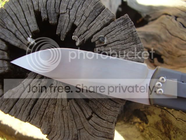

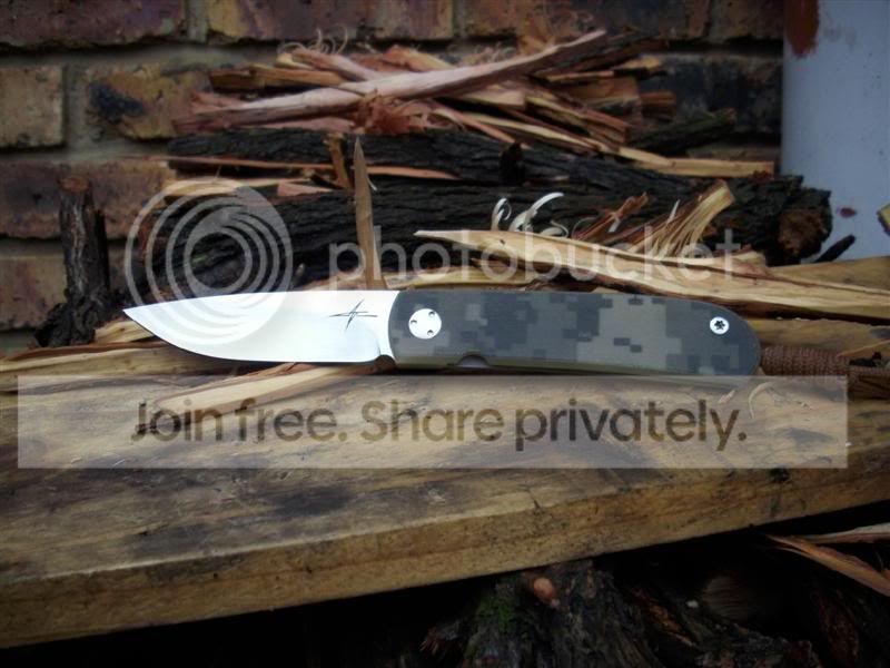

This of course leeds us to the blade and grind. WOW! I am in love with this thing! Cant wait to start using it. Inspired by (Rick Hinderer’s) slicer grind but with a (John W Smith) twist. I don’t know if Rick does it the same way but the grind is thinner at the tip then at the hilt of the blades edge. So fine work can be done with the tip and harder cutting can be done at the hilt of the edge.
The edge came shaving sharp and the blade is perfectly centred.

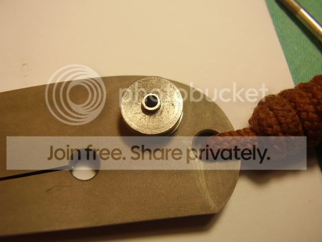

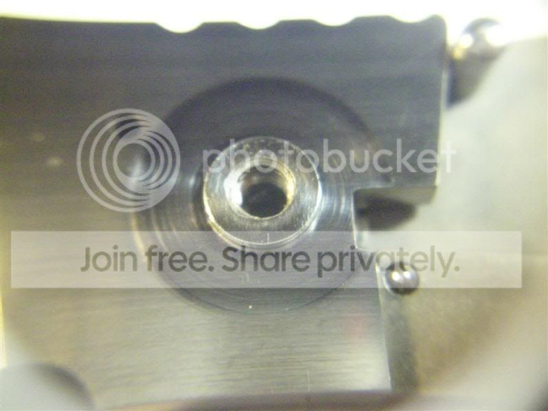

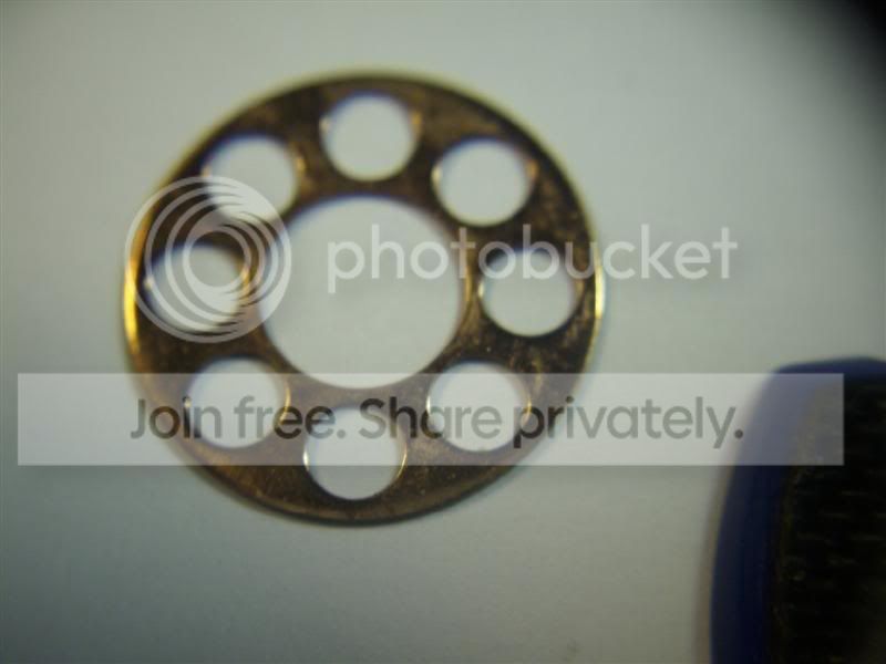

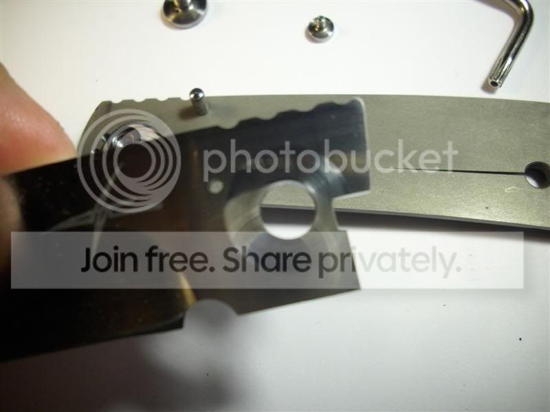

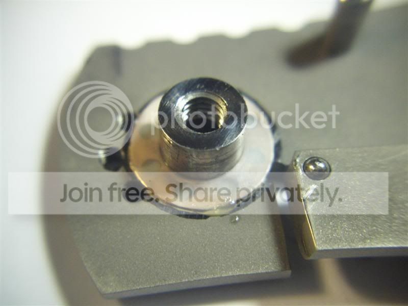

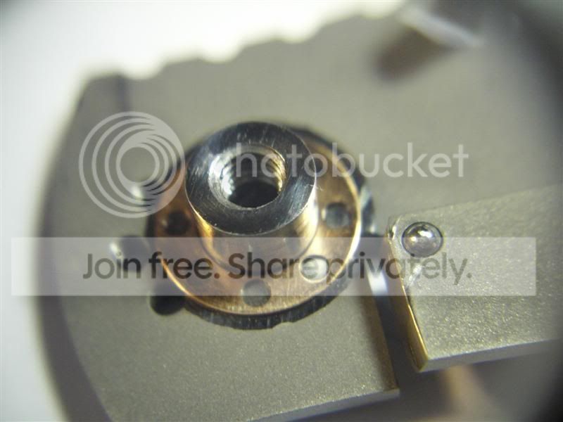

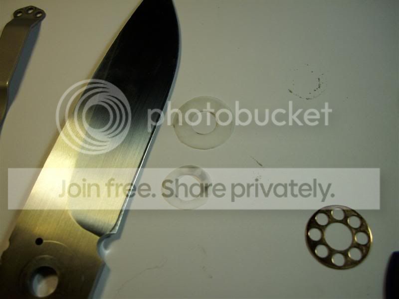

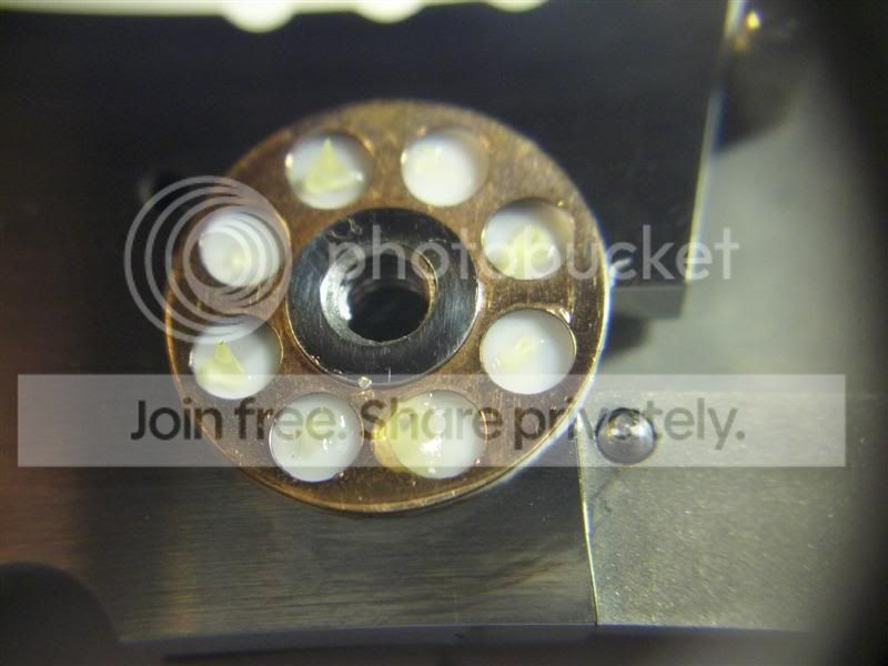

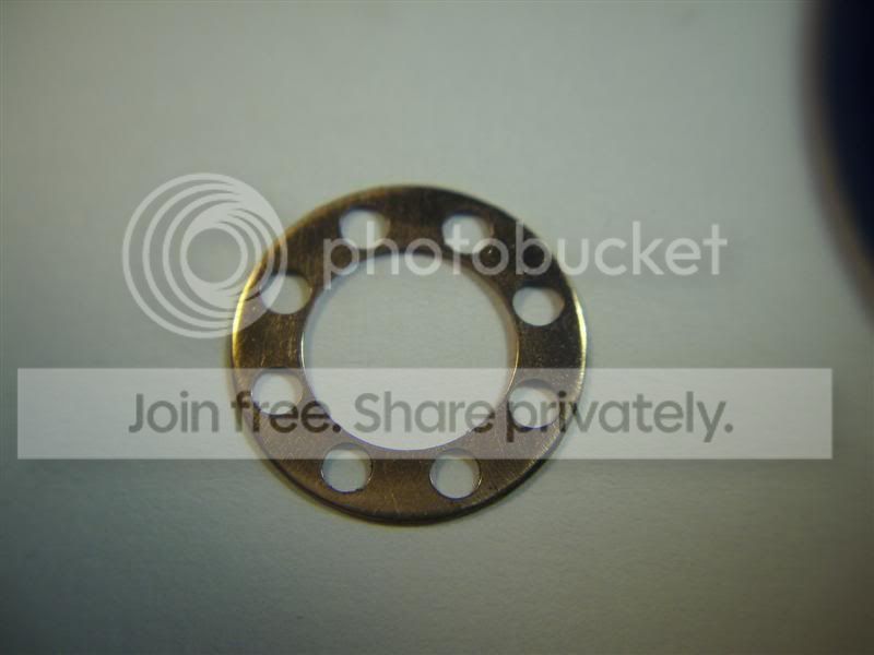

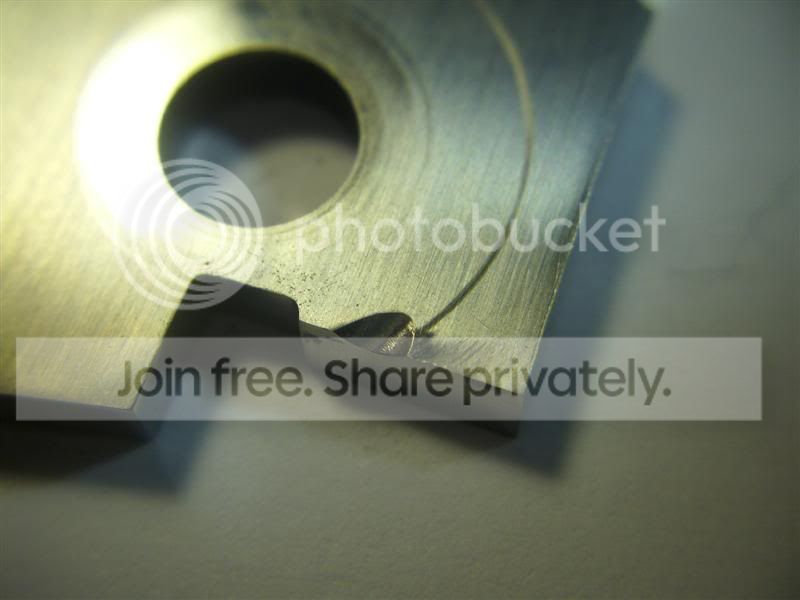

After some further inspection I noticed there are 2 teflon washers as well as 2 perforated bronze washers.
There seems to be a cut out for the detent ball to role over the 90* corner of the lock face, thereby creating a smooth action opening and closing.
All the smaller cavities of the blade have been mirror finished. (Later talked to Gareth and he stated he does that to prevent any form of rust.
The lock is a bit sticky. (Gareth stated this can be due to residue of the bead blasting, recommended I use a magic marker and it worked so no issue)

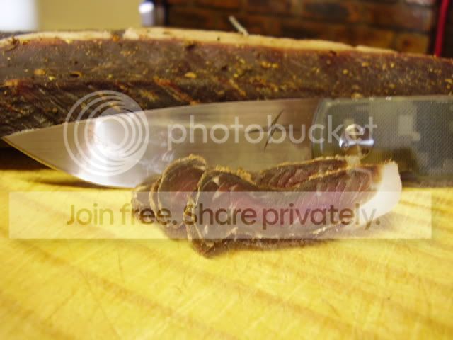

RWL-34…..you beauty! What great steel!
Sharpness test:
http://www.youtube.com/watch?v=2-OUR4xUx90
Very fine grane structure, takes an edge very easily and holds it. Can be sharpened to a mirror finish and can take a good medium edge from a silicone stone.

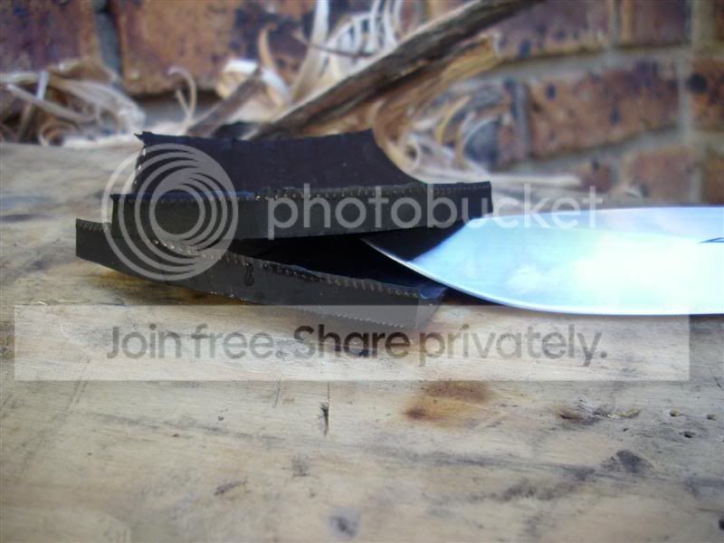

Here are videos of the toothier edge in cutting some material.
Gareth Bull Custom Cardboard cut
http://www.youtube.com/watch?v=3AWjMRBFPqA
Tire.
http://www.youtube.com/watch?v=2SdXLEmuxiU

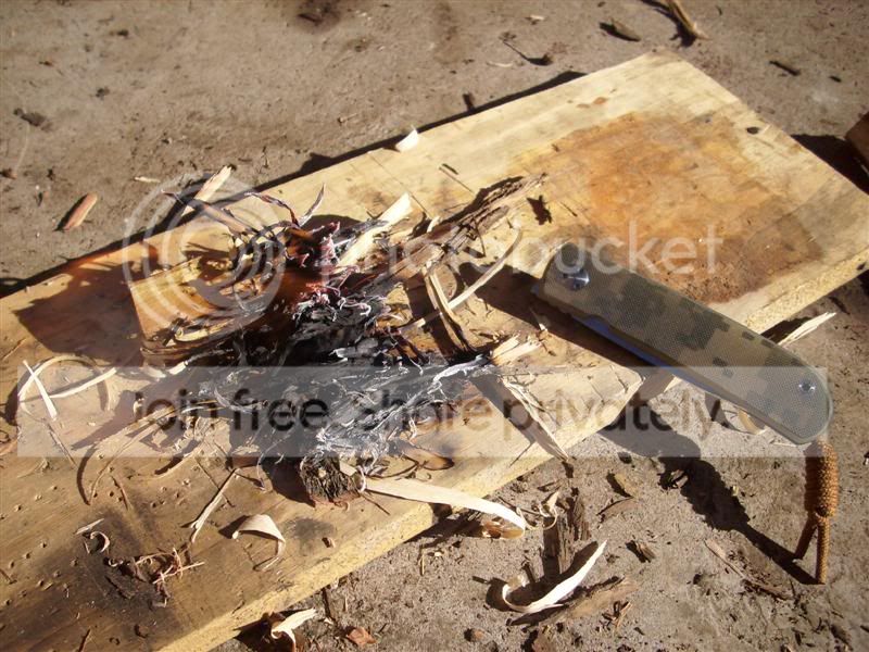

Fuzz sticks.
http://www.youtube.com/watch?v=rXX_M-CUeRE
And then after that I touched the edge up on the fine silicone stone again in less then 5 minute.

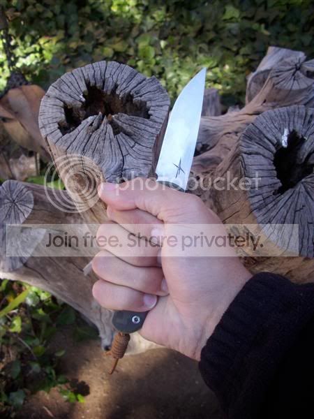

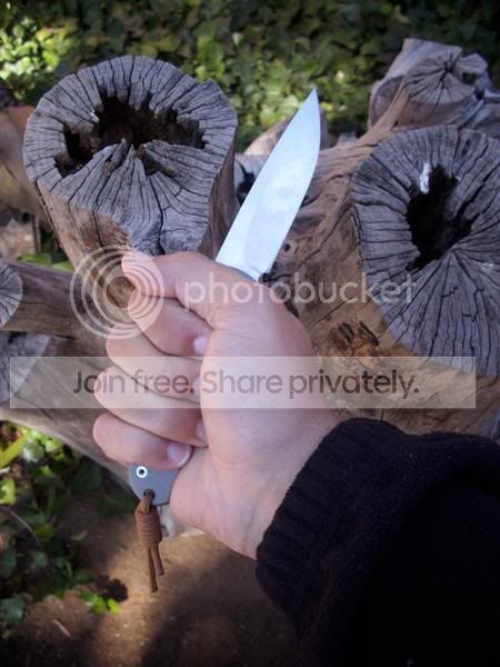

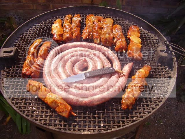

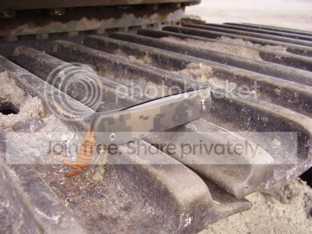

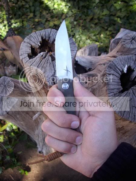

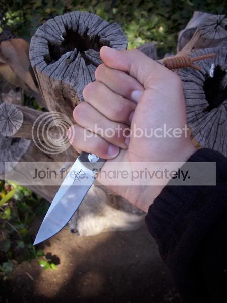

Same size as the 550HG grip. Due to its light weight it rides easy in the pocket, yet when in the hand it feels solid. IWB carry, pocket carry, shirt pocket carry is comfortable.
Size comparison
Ergonomics
I love it! The simple handle reminds me of the design philosophy of Loveless, Terzula, Carson and Smith. Good with solid feel. Not a knife designed for stabbing purposes.

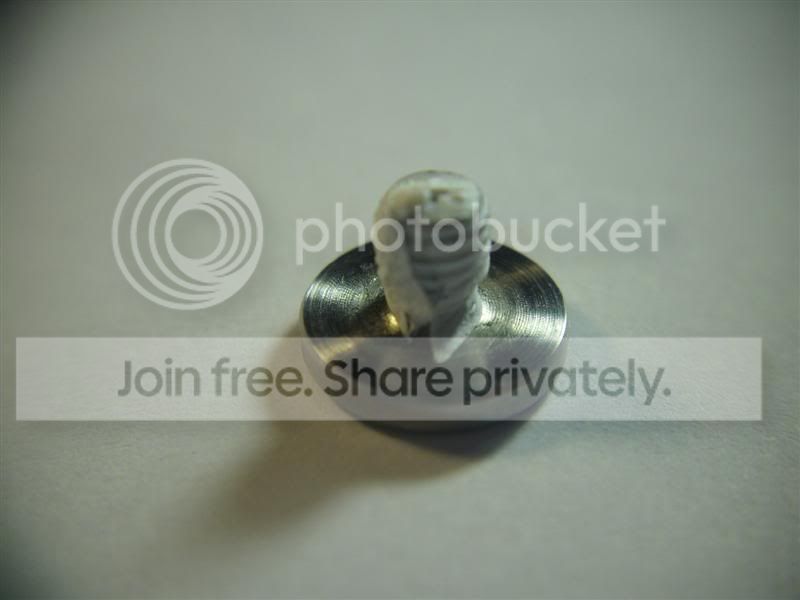

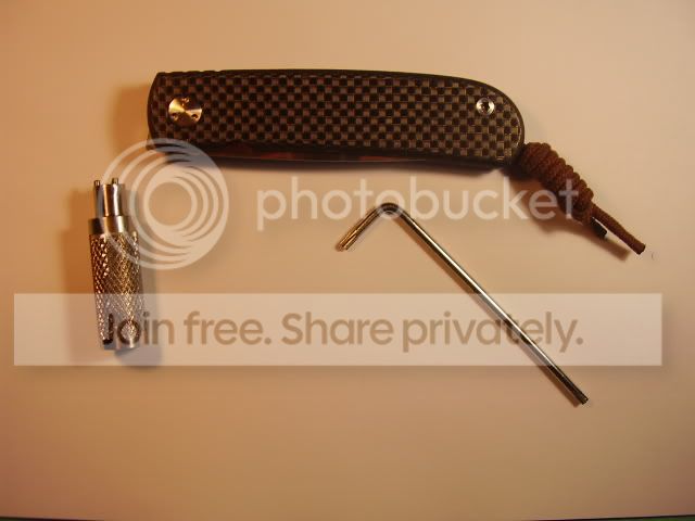

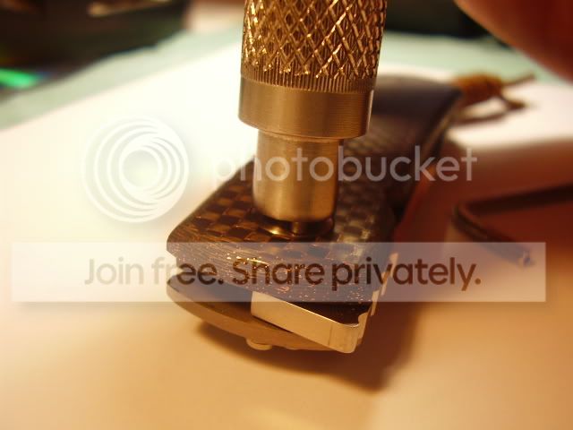

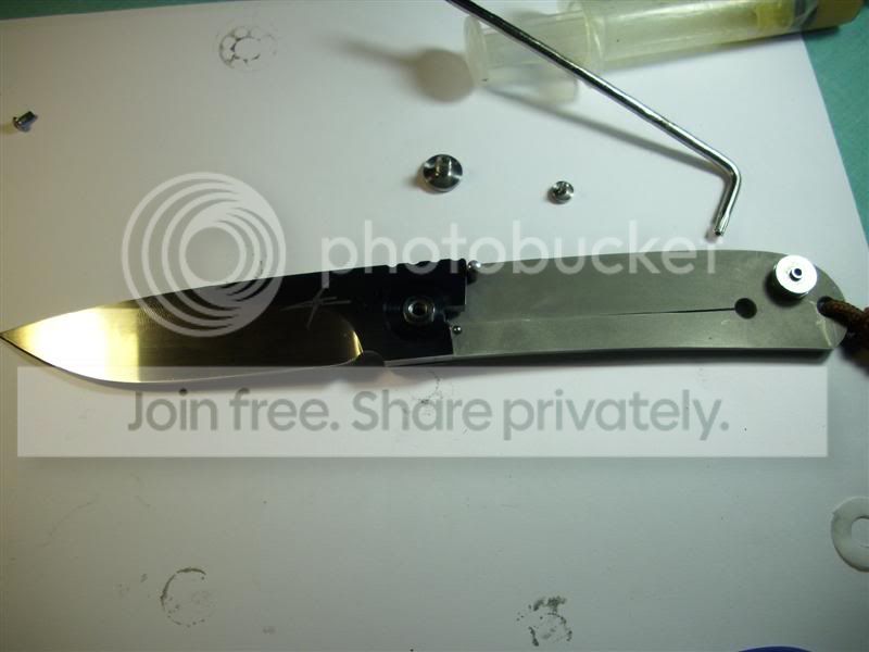

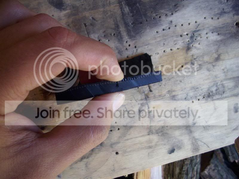

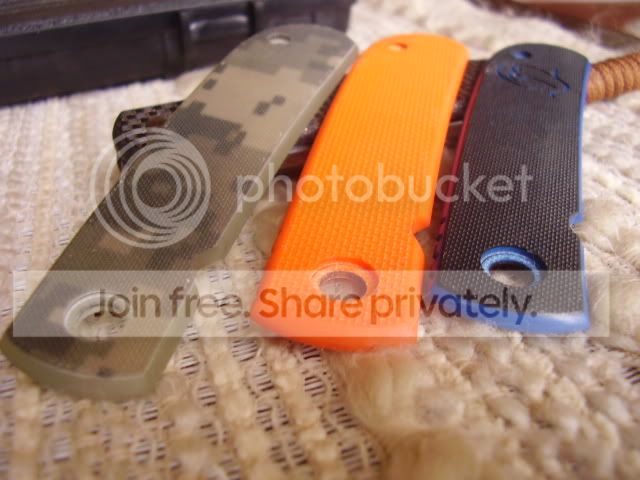

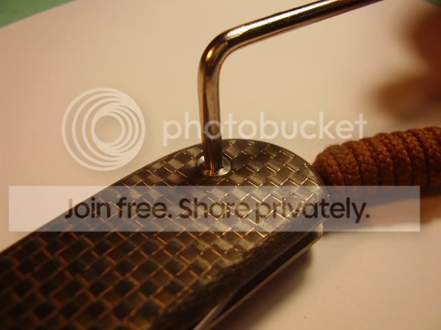

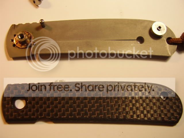

I took the knife apart and here is the process. I swapped the handle scales, gave it a good cleaning.
The standoff is so close in tolerance to the female screw par I just did not even bother to remove it.
Pick scale
Results!

That's great looking knife and a kit to go with it. Good review also. Did you ask mr. Bull the reasons behind perforated washers?

Washers have the holes in them to hold lubricant , no ? Interesting and good looking knife. How on earth do you open it though ? Don't really see some of the
influences you mentioned either but it is a good looking tool ! :) IMO the knife , concept looks pretty original.
Thanks for sharing.
Tostig
Thanks for all the kind words everyone! Gareth mentioned he had something in Blade Mag as well. So for those who can, have a look!
As I understand it the perforated washers holds the lube for longer periods. I have experienced this with my Sebenza and since I cleaned the GB Custom I have not yet applied any new lube and it has been washed in warm water with soap that normally will remove any excess lubricant in my experience.
