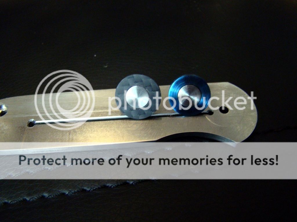

Prototype lock protectors: These were made by hand on a drillpress of all things - tore my fingers to shreds making them but they came out so I'm happy - the titanium one is for the 3" model, the CF version is for the large proto, still not 100% sure it'll work so I'll do some destructive tests on it. Worst case scenario they'll all carry titanium protectors but they'll match the standoff that way so it's not a bad compromise.

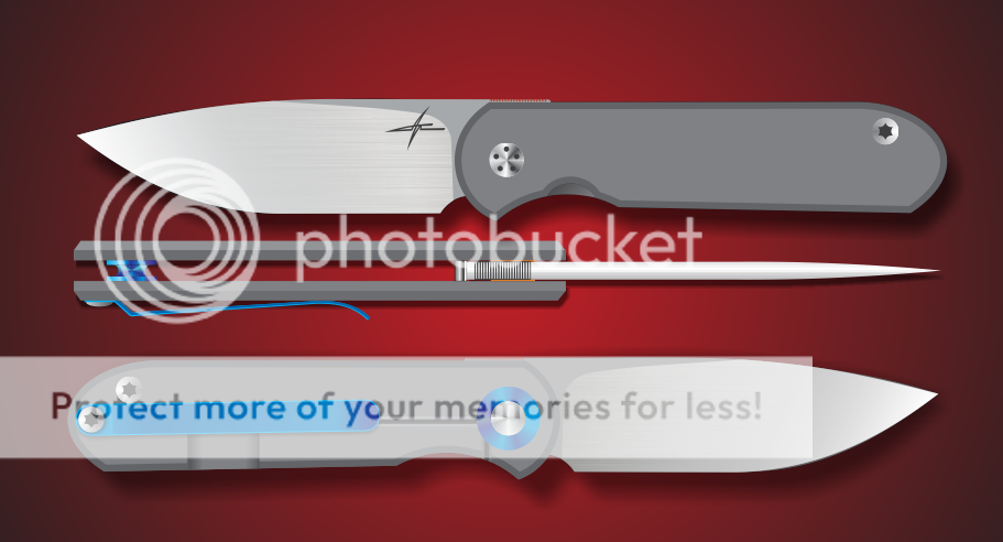

Inlaid clip rendering

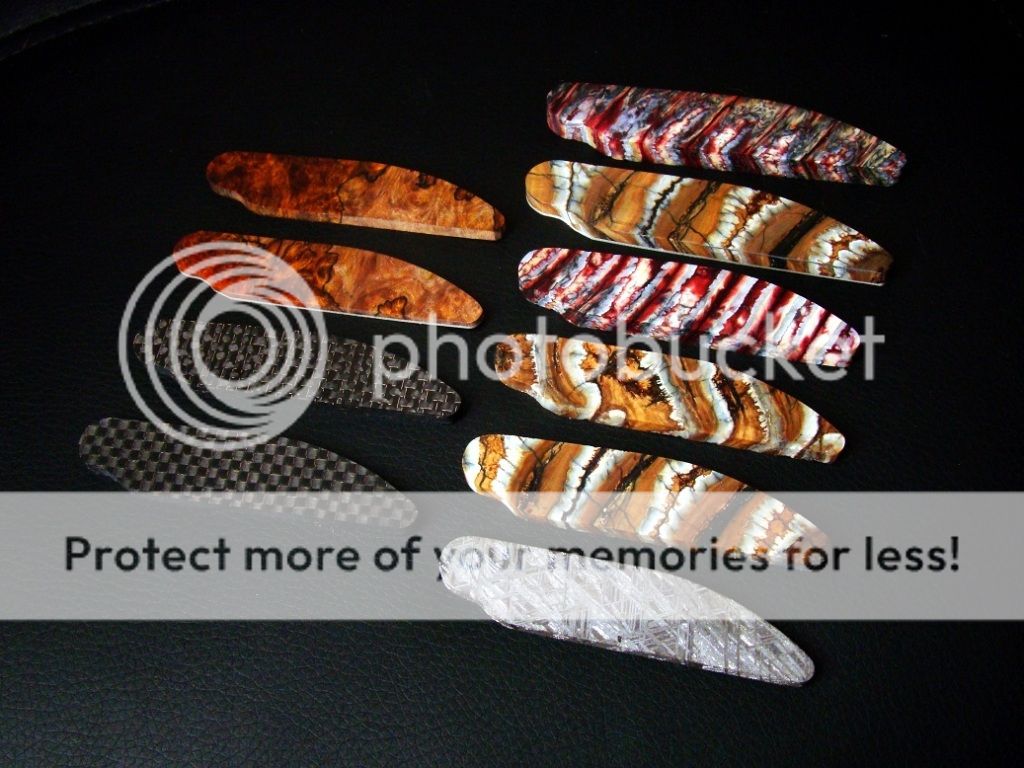

Inlays for the dressed up versions

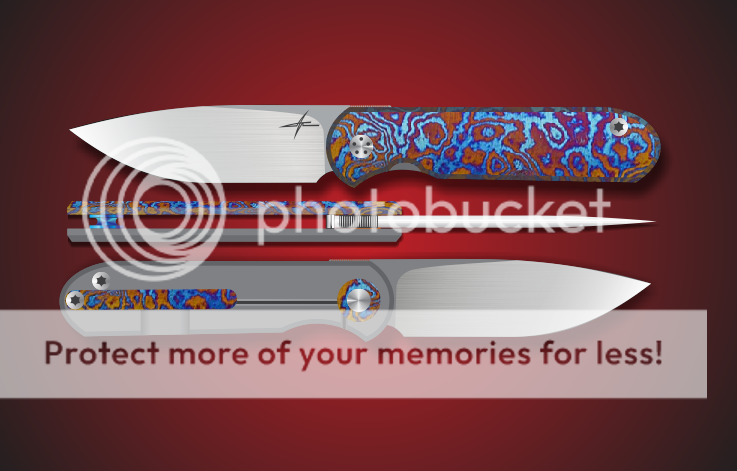

Super Shamwari - obviously with Timascus but it has other cool metals involved too - still semi-classified

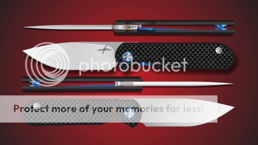

And finally the update to the ultralight plan. The blue details are all titanium (standoff and around the pivot as well as the inlaid leaf lock) Because of all the steel's on offer I'll put the steel name on the underside of the blade in the finger guard area.
As far as cool setups - there are a couple :) Right now I have M390 blades, RWL-34 and even a couple SM-100 blades on the bench :D

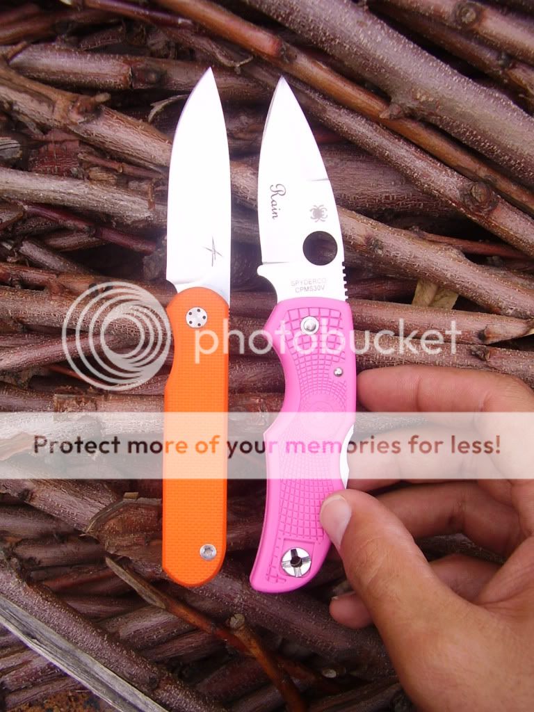

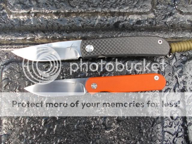

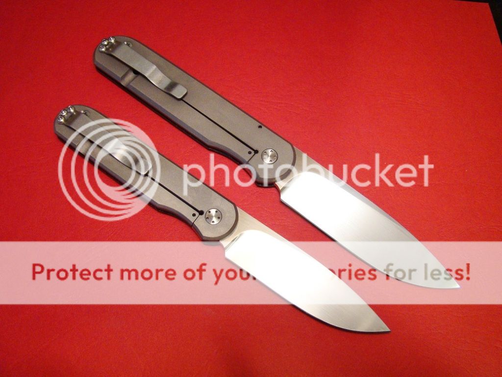

These are Marthinus' pics of the Warlock and Warlock XL:
I don't know what the exact measurements are for the Shamwari, but the orange Warlock is close to the same size as the titanium rendering in the 3rd pic of Gareth's post above in this thread.

Thanks for the photo credit.
Just one correction. The Larger model is an older model of Gareth called the SA Hunter. To date there are only a few large Warlocks that I know of.
Here is the SA Hunter compared:

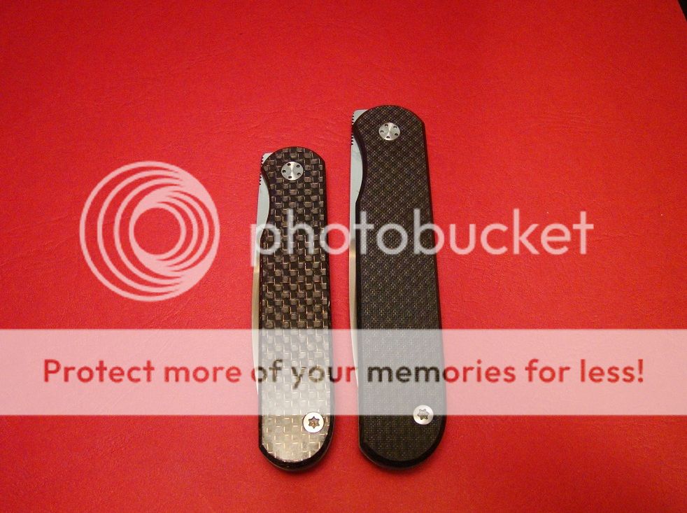

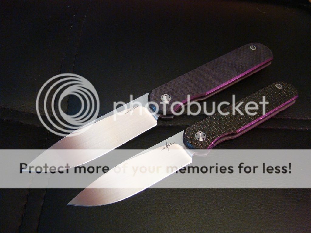

Here is the small Warlock and the Large Warlock next to each other. Gareth finished this order for someone and posted the pictures. It was the last two made of 2012
Hey all
Just finished these two up, one large Warlock and one standard.
Both have 3mm RWL-34 blades, blasted titanium frames and stainless fittings, the large has textured carbon fiber and the small has smooth lightning-strike carbon fiber.

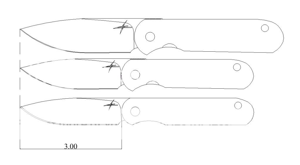

EliteKG - you got it spot on mate the lengths will be the same. By far the most popular size has been the 3" blade. I think it's a mix of meeting laws and the fact that a good 3" blade can get a lot done in our modern lives. The 3.4" was dictated by what I felt would result in the most hand-filling handle but still small enough to EDC - your knife's no good to you at home in a drawer :D The best way to do a size comparison right now is my CAD design so I put all 3 together: Top is the large Shamwari, bottom is the WarLock.
Little easier to highlight the changes this way. You can see the broader dimensions and the dropped guard area, the Warlock is based on a continuous line along the bottom so the guard is in line with the blade, the Shamwari's is a bit more pronounced.

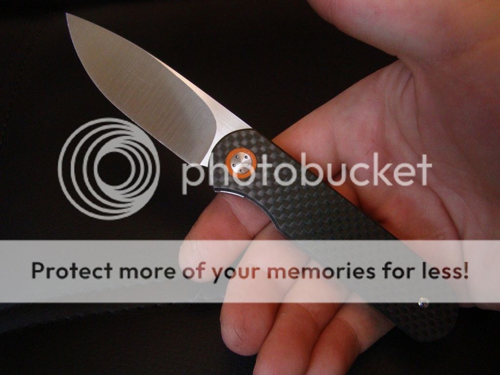

Here's a 3" in hand (the grind is pre-hardening rough grind - still needs to be raised to the proper height and crisp up the grind line) :

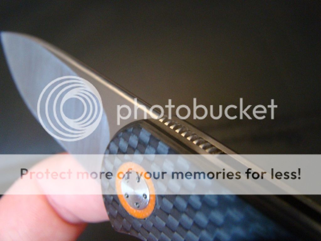

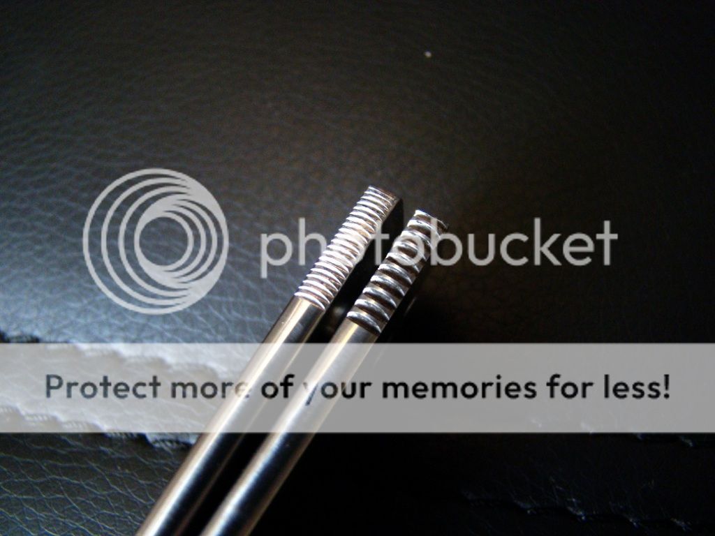

How the radius exposes the jimping (this one's a linerlock):

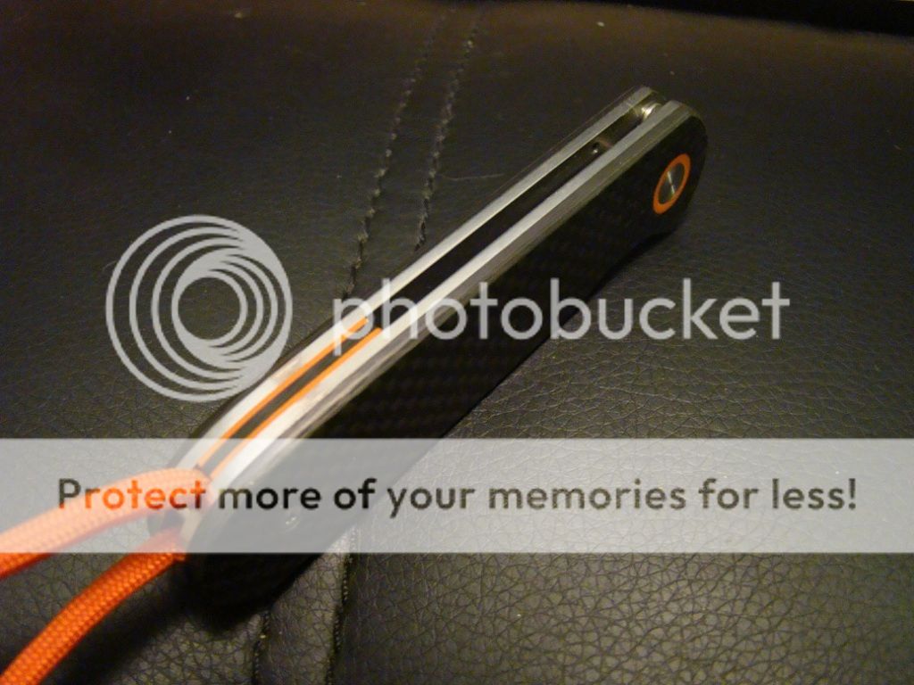

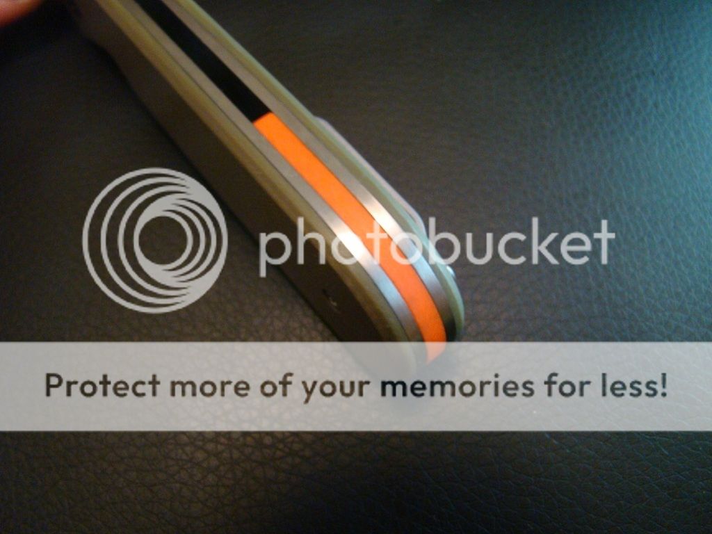

Matching 2-tone spacer (most of the shamwari's will have turned standoffs, I just wanted the color-scheme here)

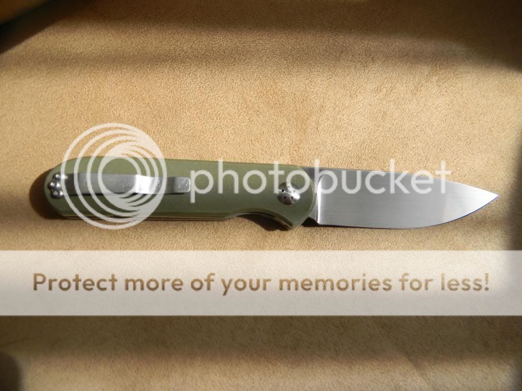

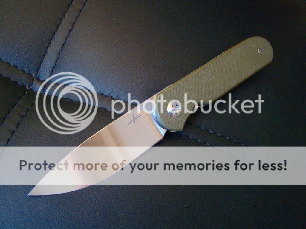

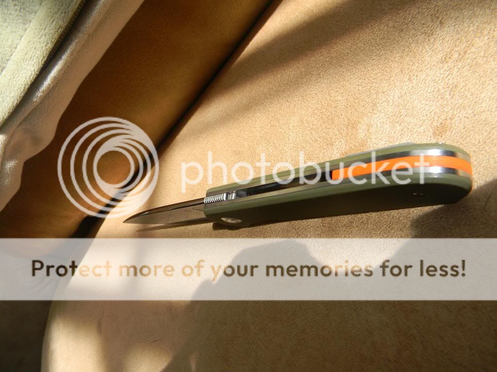

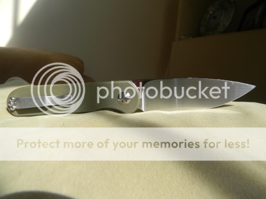

Hey Gents
Finished this one up just before midnight last night. It's a linerlock version of my Shamwari (Bit simpler to make - no sandblasting and no outsourced engineering!) and I'm chuffed with how it came out. The framelock versions will be coming on track soon, but this was a nice way to test the theory.
Specs:
Blade - RWL-34 ground high and hollow (I used a 450mm wheel so it's pretty shallow as hollow grinds go)
Liners - 2mm Titanium
Spacer - Orange G10
Scales - Olive G10
The blade's got a radiused spine for a bit more comfort during cutting, really enjoy this touch. It also makes the jimping look pretty cool ;)

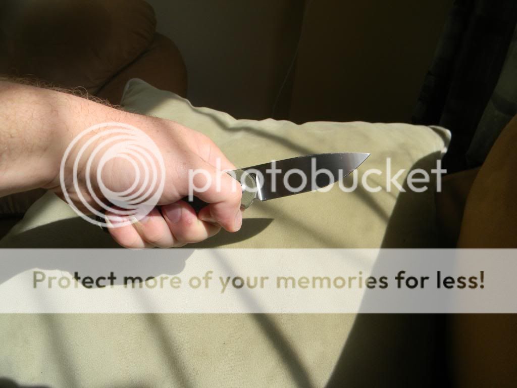

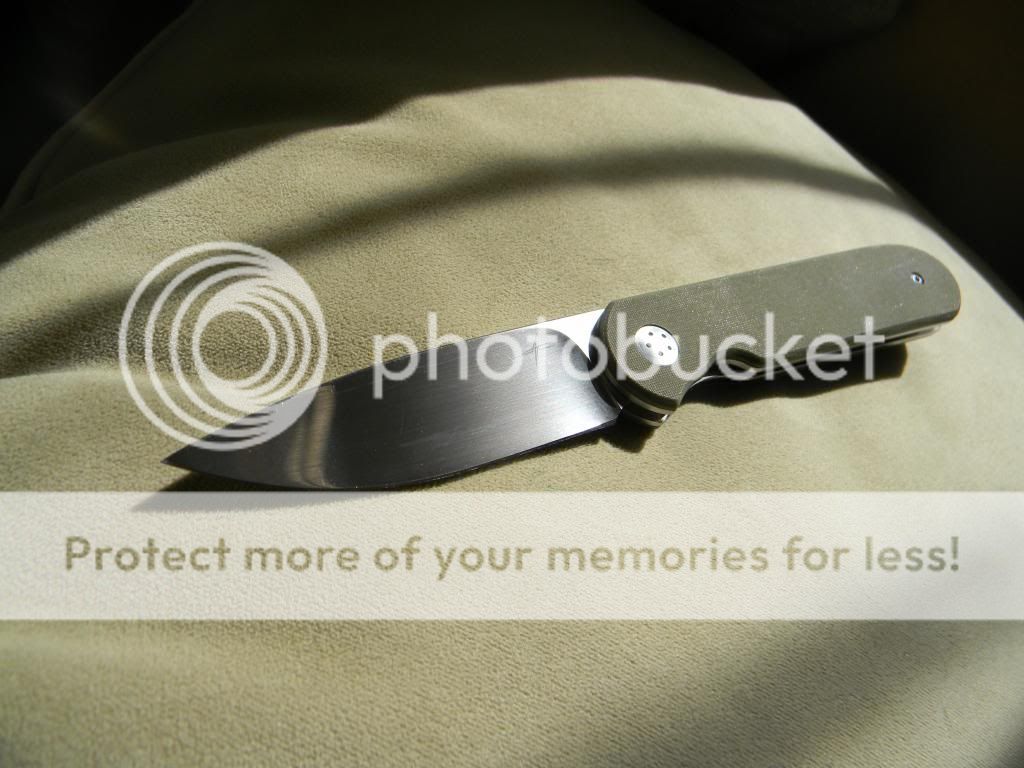

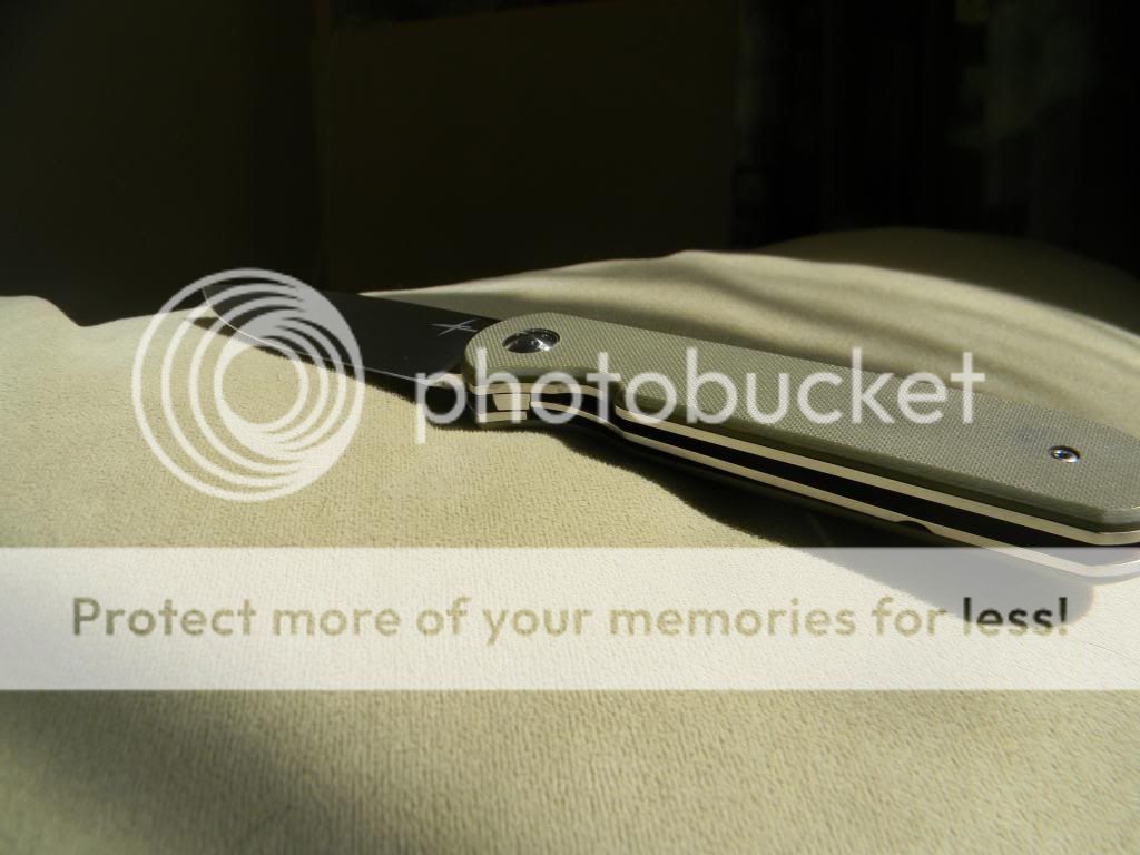

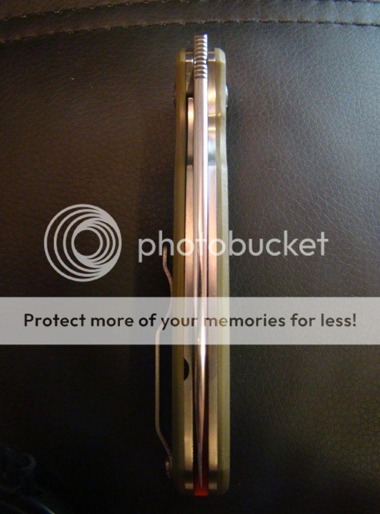

Eventually, as promised; here are some more pics!
The more i use this knife the more i want to use it!
