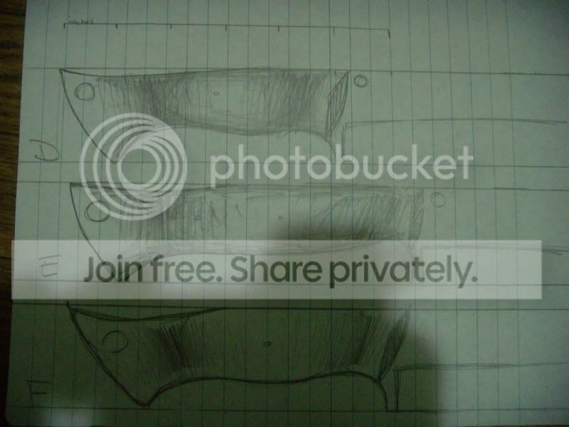

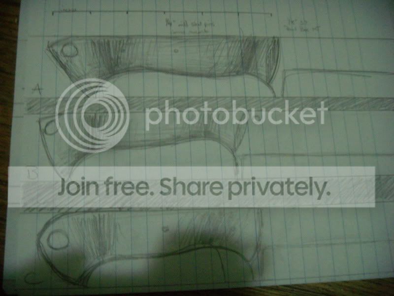

today i drew up some handle profiles in a spare minute, tell me what you think:
(very very sorry for the bad quality...the scanner won't cooperate so i had to photograph them instead...)
what do you think?
