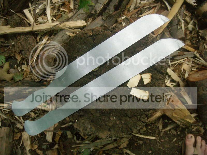

here is a pic of the soon-to-be-blades with some other blades that i have already shaped and am in the process of drilling (both of my drill bits snapped, gotta get new ones :mad:)
i decided to go for one of the handles pict chose, i think that it will be more comfortable to those not used to kukri style handles, it looks much more "machete", and it will be a little bit easier to make.
should i try doing a combo grind on one of these? i don't want to mess up and make something with alot of stress risers (this is pretty pricey steel...) but it could be cool to have something like a really thin convex or scandi grind for the first three inches, say, and a thicker convex chopping grind after that. i think i will probably stick to a single convex sabre grind on these...but maybe in the future i will play around with it.
i hadn't thought to round out the spine at all, i was just going to leave it sharp for scraping and smashing. i suppose those sharp corners are hard on a baton though, which i had forgot to think about before...
i intend to be very concious of the handle shape and finish, as it is a very important part of the knife, especially on one like this where it is easy to develop hot spots and hand fatigue.
i think i might try doing the edge like pict did, i will have to see how it unfolds...

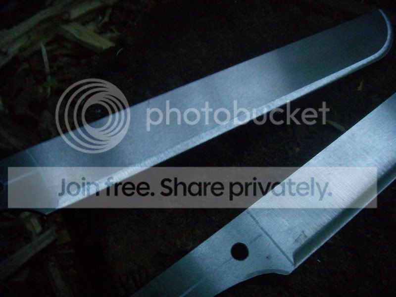

some more progress, sorry about the bad photos, it is starting to get dusky here and the camera doesn't like less-than-perfect light...
i drilled the pin holes and started the grinds. one is going to be a scandi and the other is going to be convex.
