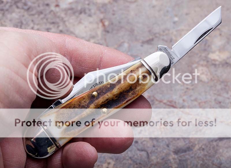

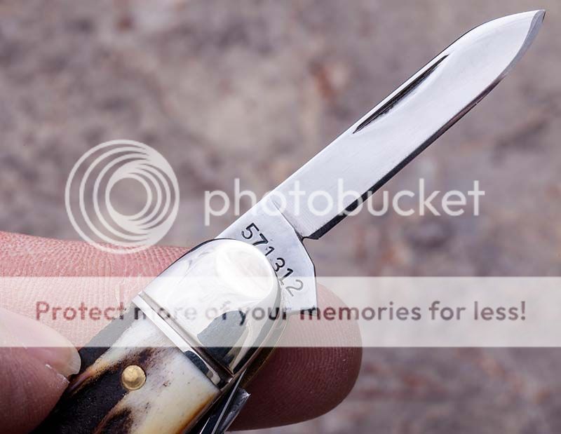

Thanks Kevin, here are few more, shot tonight with some better lighting as I had to take some photos of a watch I put up forsale;
I'm liking this knife more more all the time, the coping blade is still one of my favourites and the main clip is pretty slick looking...

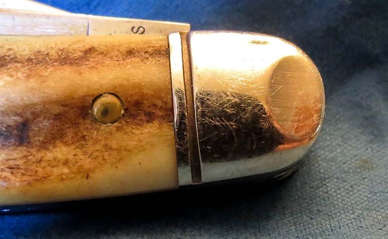

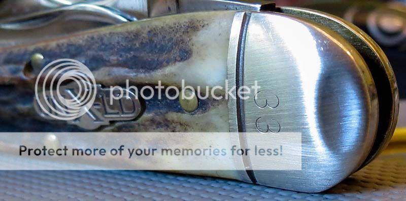

So, as I did with the other one, I used some 600 grit sand paper and applied a nice brushed finished to the bolsters, the way I do it is to cut a piece about thumb width and about 3" long or so, I grip the paper in my right hand and with the right hand I pull the paper STRAIGHT from one end of the bolster to the other, all the while pushing down on the sand paper with my left thumb, I keep doing this until I get the finish I like. Here are some images taken of the knife;
Here is a Before of the bolster,

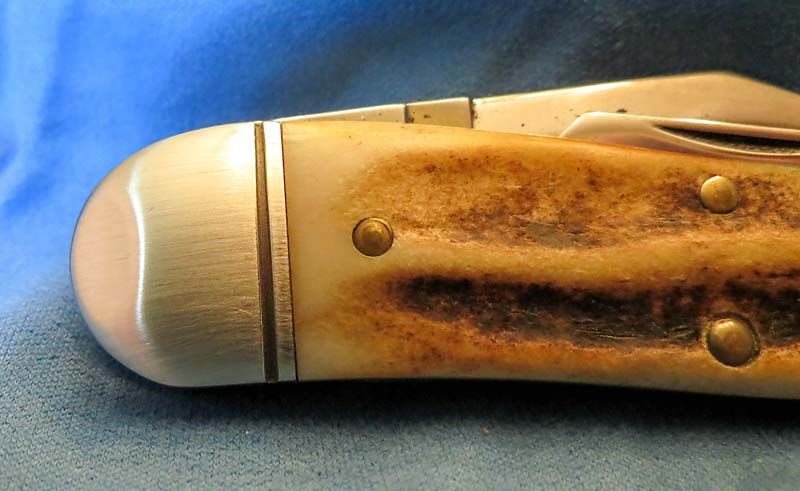

same bolster, knife flipped end for end to photograph it better;
I was worried about the serial numbered end, but that worked out ok, probably won't take a lot more to make it fade away but the brushed finish looks good and also hides further scratches too, so you don't have to do this as often as you would if it were polished.

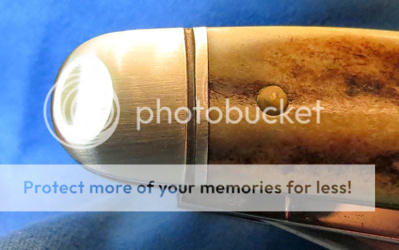

and here's a shot of the other side of the larger bolster end

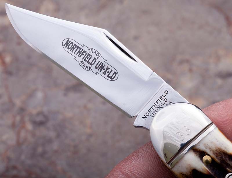

And the blades are keeping their edges very nicely and wow do they CUT !!!

Nice work Gary, like that brushed look. I can see some nice patina marks trying to show themselves as well:thumbup:
Indeed they are, I've taken an AG Russells Rust Eraser to the blades every now and then, but I may need to try and force an even patina on there sooner!
Also one thing about the sanding bit, you may want to wrap tape along the open ends of the bolsters to help prevent dust falling down inside, I spent the morning with some oil getting the blades to open smoothly again, nothing major, you should always oil the joints! One thing I found was using the plastic hypodermic needle thing I got from Chris Reeve's knives, when the grease they have inside is gone, I take and pull the plunger out and put in some light oil, the long plastic needle helps to get the oil right where you need it, very handy...

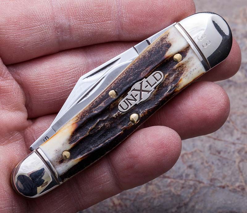

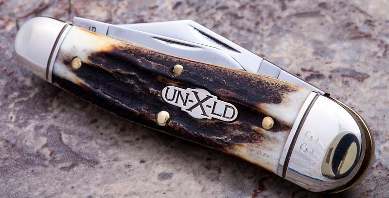

Just touched up the bolsters today, the 33 is starting to wane a little bit, but still legible, it didn't really sink in until today that it is one of 35 made, you'd think it'd be one of 50, so mine was right near the last one, serial numbered at least...

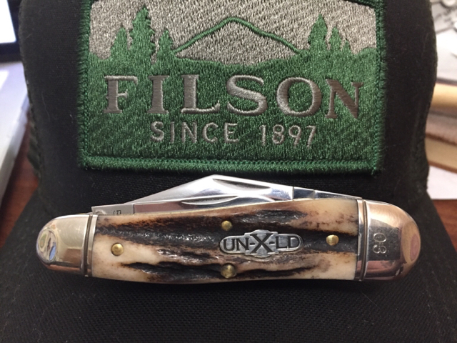

I'm in!
I was actually kind of sad about the shield side. It's my first stag folder so maybe it's perfect, but it just looks weird to me. The non shield side is awesome.
Sorry for double post, but I was looking to try and find quantities produced and couldn't find it. Does anyone have that info?
I love it CodyKenobi!! Awesome on both sides and all around!! The Filson hat gives me that outdoorsman feeling...just great
+1. :thumbup: Looks great on both sides. Incredible popcorn on the pile side, great shield fitting on the mark side. It's hafted very well.

Isn't this the total Gary was mentioning? 35 it seems.
Grand pile side for popcorn and a great shield inlet on the mark side, you got a beaut!
The nice thing about that knife is where the shield sits, in that deep valley of the Stag. Much better than popping out on the surface!
