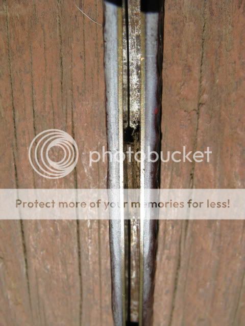

If you choose to put a 'bumper' inside the handle, I'd highly recommend putting it under the kick, so the edge of the blade isn't resting against it when closed. Especially if it's made of wood. Wood will absorb moisture and trap it against the blade's edge. All the more risky with a carbon steel blade, as with your GEC. Here's what I'm talking about:

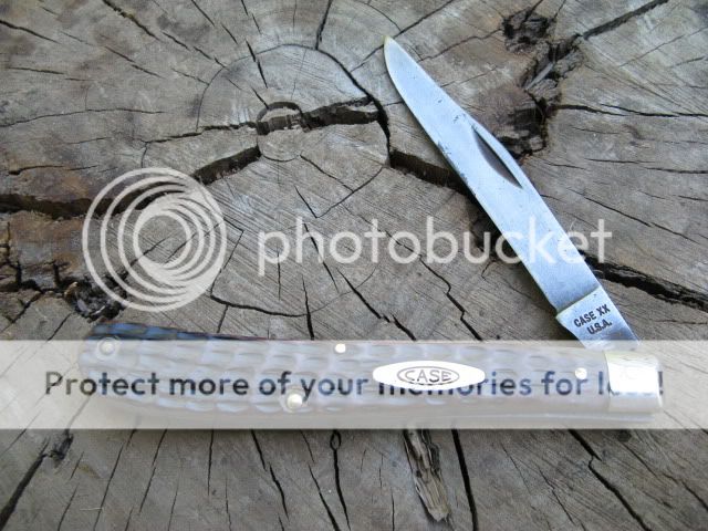

( pics below linked from this thread ---> : www.bladeforums.com/forums/showthread.php/880104-Case-Slimline-Trapper )
Notice the stain/corrosion on the edge of this trapper's blade (seen on the portion below the nail nick):
A wood bumper was inside the handle:
