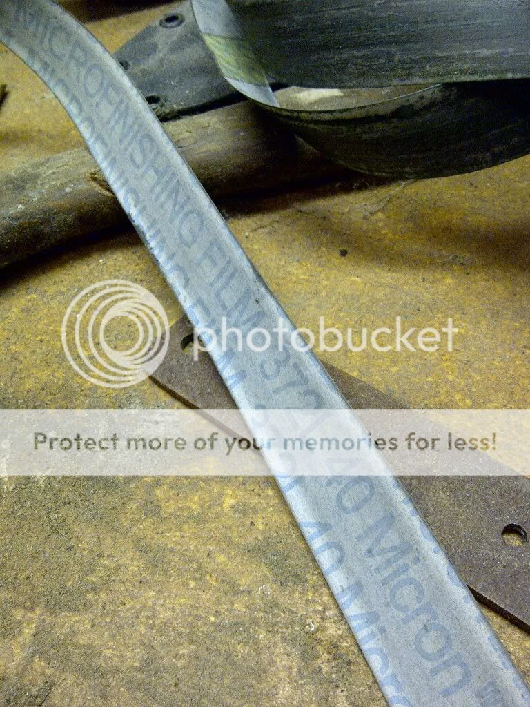

I think 1095 is about the easiest steel to sharpen. With that said, my D2 knives are not pocket knives, they are mid sized fixed blades so I finished them differently. As you can see from the following 100x microscope shot, they still get sharp enough to do a little cutting, and they slice abrasive materials well. For the photo I positioned the D2 blade and held a fine hair with tweezers and simply pushed it into the edge. You can see two cuts made into the fine piece of hair. Point of the story? You don't need mirror polish for sharp :)
Kevin
That looks like VERY nice edge Kevin! Of course, I gotta ask...How'd you finish that edge??
I've been thinking of trying something like that, finishing on a 25 micron DMT diamond stone and stropping with 6, 3, 1 micron diamond paste. How much time do you spend on the stropping with 1095? How about D2?
Vic,
Thanks. That's a relatively sloppy edge I did quick. 3m grinding belt 40 was the number but I don't remember what that translates into grit off the top of my head. Green compound on the belt. Then leather belt with black and green compounds mixed. About a minute to strop the edge if that.
I believe if you get the edge right off the belts or a stone by hand, very minimal stropping is needed.
Kevin
Thanks Kevin, I think I've got an experiment for tonight. My DB barlow might be getting a new coarse finished edge :)
Cool! I just looked it up and the '40 marked belts' are 500 grit. '20 marked belts' are 1200 grit.
