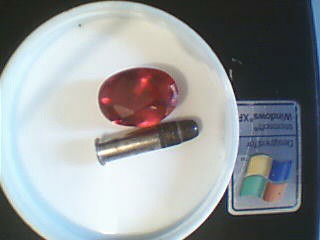

while everyones showing off their rocks, I may as well join in :D the shell next to it is a .22lr for size comparision, can't remember the caratage (edit 13.7 carats by the little multi-mode electric scale u use for reloading ammo), but it's pretty reasonable. Apologies for the poor quality, but my webcams not the best there is :P
How hard is it to set an oval cut stone in a pommel? I've had this ruby for several years now and haven't managed to think of anything to make with it... Cost me just a few bucks on ebay.
It's a real ruby in that it's the same chemical composition, same weight, hardness, colour etc, etc. but it was made in a lab and is pretty much worthless compared to a real out-of-the-ground ruby. I believe the term is manufactured, rather than synthetic. As I understand it, Synthetic gems are plastic or glass, coloured and cut to resemble gems, but which are different chemically, while Manufactured gems are made from the same chemical compounds as the real gems, but with the forces supplied in a lab, not by geological stresses.
