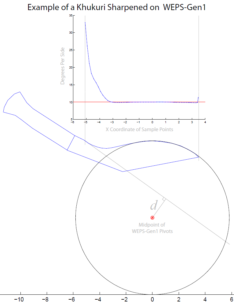

I was asked to do an analysis of sharpening a khukuri knife at 10 degrees per side. The analysis here is for a WEPS-Gen1
I started with photo of a khukuri that I found from www.KnifeCenter.com. I then did a polygonal trace of the knife edge which was then spline interpolated with sample points at roughly every 0.25 inches. The trace was more carefully done for the blade's cutting edge, and then only roughly accurate for the spine and handle. Analysis of the results are graphed as requested.
Original photo of the khukuri:
Results:
Please note that the graph and the knife are vertically aligned to help visualize the results.
Discussion:
I did not trace the knife edge perfectly, which may have caused some minor artifacts So the slight "hump" at around -4.5 <= X <= -4.0 inches is probably due to inaccurate tracing on my part. Similarly, I may have clicked slightly off on the very tip of the knife, which would cause the change at the tip of the knife at X = +3.5 inches. Likewise, the slight oscillation around 10 degrees for the main edge of the knife is almost certainly due to inaccurate tracing.
The sharp increase in degrees per side for -5 <= X <= -3 is expected from the Dihedral Triangle Theorem in the technical report. The gray line is a tangent of the knife edge near X = -5. As one can see, that tangent line travels very close to the circle center. The distance from the tangent line to the circle center is labeled "d". Because d is much smaller than the radius of the circle, the dihedral angle must be much higher. Hope this makes sense. Feel free to ask questions if it is not clear.
Although this analysis was done with a WEPS-Gen1, the results will be very similar for a WEPS-Gen2. They should only differ by a tiny fraction of a degree, so the graph will be virtually identical. If there is interest, I can run the analysis for a WEPS-Gen2 and then we can compare it to a WEPS-Gen1.
When I have time, I plan to also analyze a kitchen chef knife.
Let me know if you have other requests or suggestions. :)
