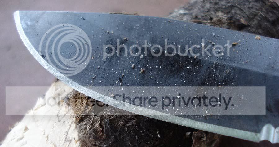

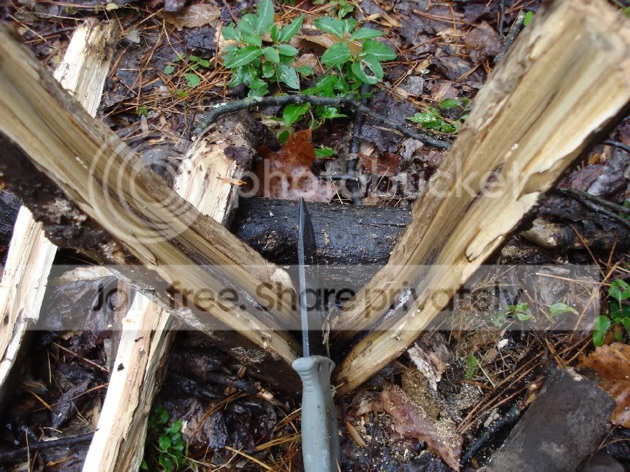

So I decided to test mine this afternoon by batoning through some wood. Now, it has been raining here for the past couple days and most of the wood I could find was wet and that might have played a role in my results. I don't question the experiences of my fellow forumite, but I must say my results were quite different and I was pleasantly surprised by the Gerber's performance.

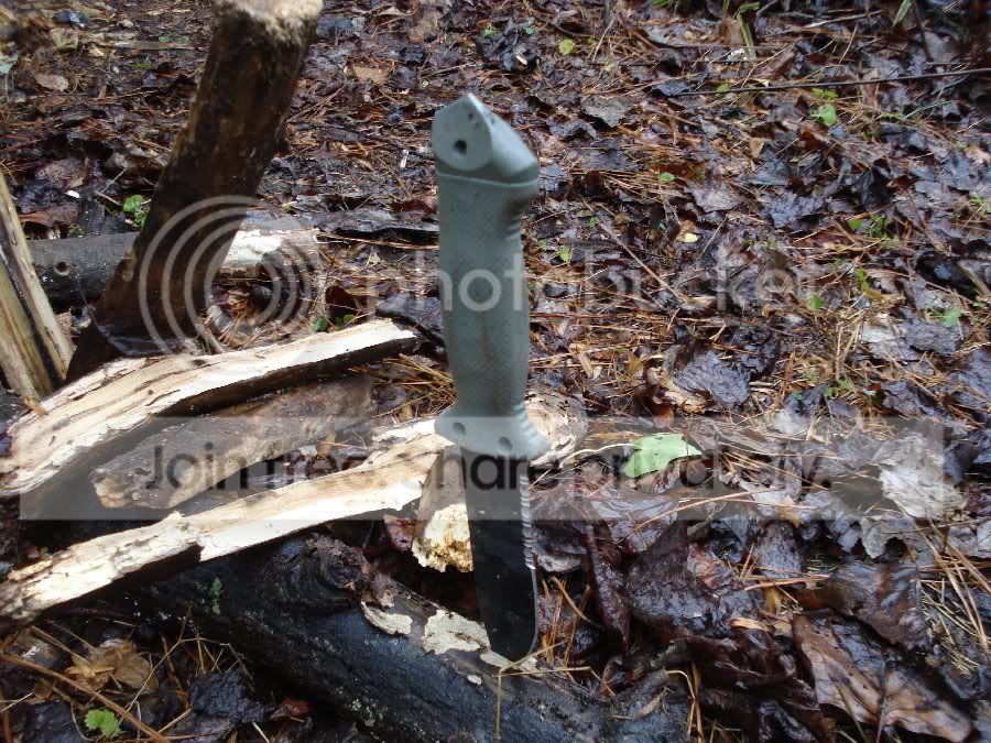

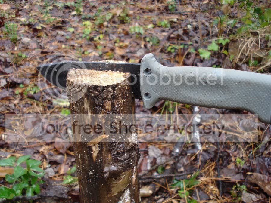

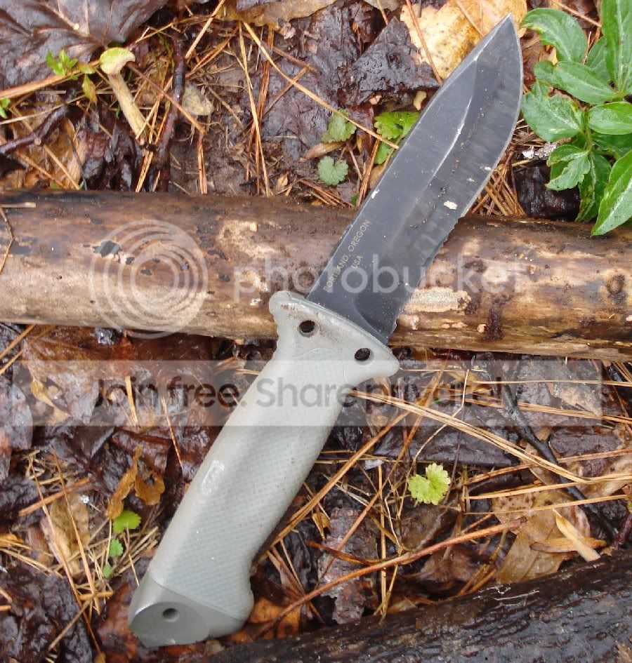

In these first few pictures I tried chopping through a piece of dry hardwood. It was actually pretty easy and I noticed no ill effects on the edge.

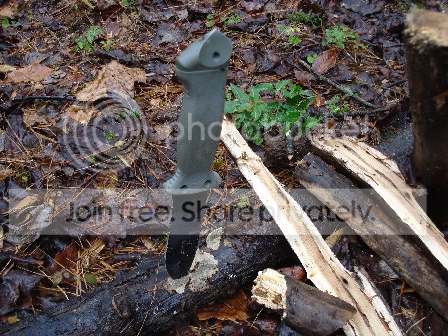

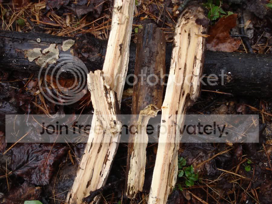

Then I batoned through a wet piece of deadwood. It really wasn't much of a challenge.

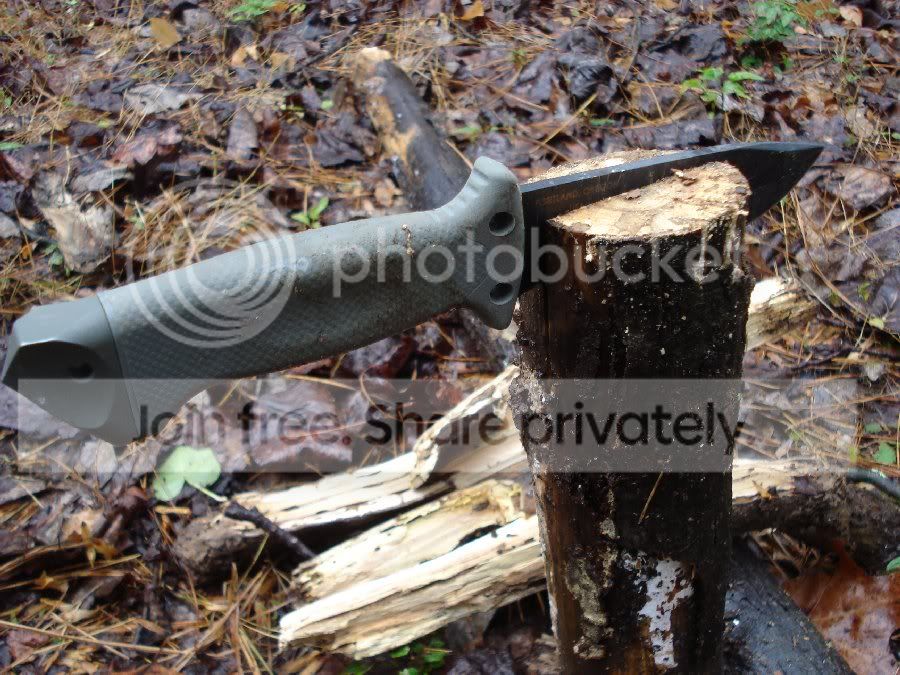

Since that was so easy I decided to try batoning through a 4" treated fence post. Sorry no pictures, but I didn't get through. It wasn't the knife's fault though. The piece of wood I was using to baton with was actually getting chopped in half by the knife's spine because it was softer than the fence post. I got the knife a couple inches in before stopping and wrenching the knife free. Then I batoned the knife point first into the end of the fence post. I got it in a little over an inch before rocking it free. Again There was no damage to the edge or tip.

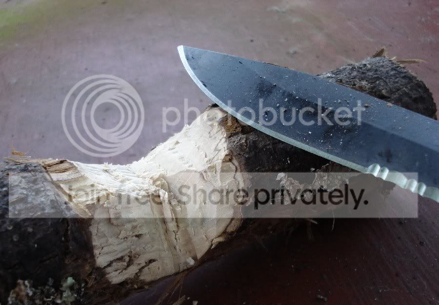

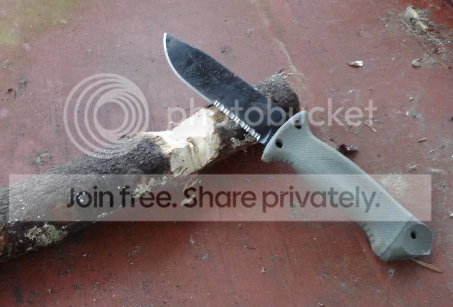

I finally sawed off a piece of limb that I thought would be a good test.

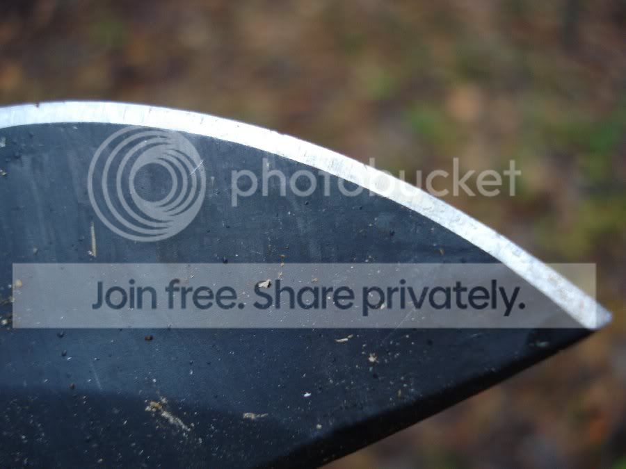

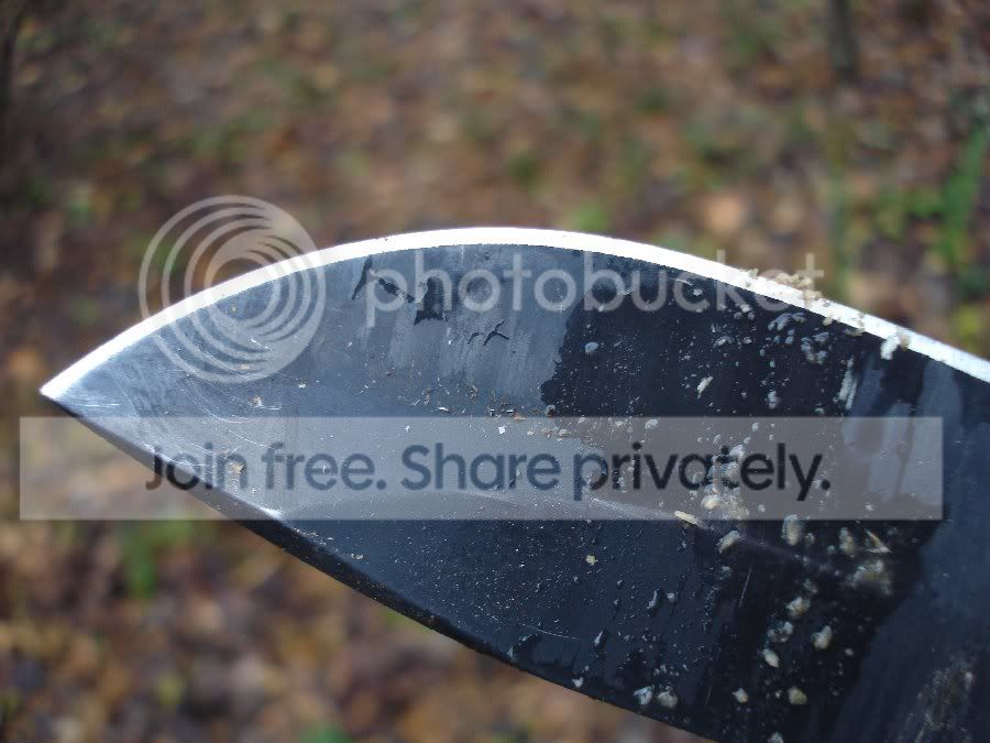

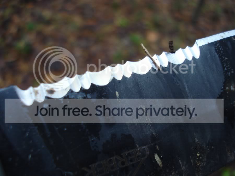

As you can see the knife went through it with no problem. Afterwards I examined the edge and was pleased to find no chipping or rolling. See for yourself.
It looks like I've been unfair to this knife and whatever mystery steel it's made of. I'm sorry my fellow forumite and LMF owner had such poor showings from his, but my knife seems to have held up very well. It could even still push cut paper when I got back into the house. Of course this was just a quick, simple test and prolonged use might yield different results, but I certainly feel a lot more confident in this knife now than I did before this little test.YMMV.

Thanks for the comments. The LMF performed well in my little test and it is comfortable and well balanced in hand.
