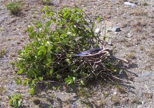

The Gerber Silver Trident is ground from 0.215" thick 154CM stainless steel with a dual flat grind which is 0.625" high, it weighs 320 g and is neutral in balance. The primary and secondary edges are ground at 22 +/- 1 degrees per side with an edge thickness of 0.035-0.050". The primary serrations are of a fluid wavy pattern ground at 30 degrees included and are 0.065" thick at back. The secondary serrations are chisel tip ground with the point inline with the edge and the scallops ground at 27 degrees and are 0.075" thick at back.
With the primary edge, push cutting 3/8" hemp required 35 +/- 2 lbs. The primary serrations are very fluid and efficient, making a cut with 14-16 lbs, while the secondary serrations required 30-32 lbs and were not very fluid which is to be expected given they are chisel tipped for durability. The cutting ability of the plain edge section in general was fairly low as it is thick and obtuse, fairly standard for a "tactical" blade. For example it is out cut by two to one by the Spyderco Vagabond on various woods. The carving ability specifically is reduced as the primary serration sare in the region where it is most efficient to carve. The primary plain section of edge is also so far out on the blade it creates a huge torque disadvantage and thus the serrations are actually similar in efficiency.
The point on the Silver Trident is fairly thick, it tapers 5.5 degrees distally through 0.865", and the blade is 1.1" wide at the back of the point. With a 50 lbs push it sank 169 +/- 5 pages into a phone book and with a hard vertical stab penetrated 592 +/- 5 pages. On 2x4 digging it sank in well and the handle was comfortable and secure, however the tip bent though a half an inch on even softer lumber so it isn't suitable for digging in even moderate woods.
The Silver Trident is fairly neutral in balance and only weighs 310 grams so it doesn't make a powerful chopper and a regular 2x4 takes quite awhile to hack through. It has less than 20% of the chopping ability of the Wildlife Hatchet. However it does have enough chopping ability to clear limbs and boughs for a shelter, make notches, rough out stakes and is comfortable and secure in hand while doing so.
While it can be used to baton woods it has problems in doing so because of the sharpened top edge and the serrations at the base of the primary edge. The serrations will have durability problems with knots so care would want to be take with that region of the blade, and the sharpend top edge really chews up batons wasting energying cutting up the baton that would be better used driving the knife into the wood.
The Silver Trident has a very ergonomic and secure handle, one of the better feeling grips seen in quite awhile, capable of being used for an extended period of time without raising discomfort while still allowing a very high degree of security. Even in very hard work such as the heavy stabbing described in the above, the handle was comfortable and secute. The large steel buttcap provides a solid hammer surface for tent pegs, nails or even crushing bone. The dual guard interfers with much utility usage but does provide extreme security in compromised grip positions. The top guard was cut off soon after work was started with the blade to allow greater grip versatility.
The sheath is made by Blackhawk Industries and is a cordura / kydex composition with a number of enhancements over lower grade versions. It readily converts from low to high ride using velcro straps, the kydex liner is held in place by a screw so it can be removed for ease of cleaning, or replaced if broken. The sheath has a secondary retention system with an extension of the kydex liner which fits up around the blade in the guard region and is secure enough to hold the blade in without the strap around the grip. The blade was still held in place with the kydex clip alone through falls of 10 and then 15 feet onto a hardwood floor, however it could be dislodged with a hard wrist snap. The accessory pouch is large enough for a solid multi tool, small knife or sharpener, or mini-survival kit. It would be nice if it came standard with a small torx driver to take the handle apart and a screw driver to remove the kydex liner. Lee Valley sells modified washers which serve well as screwdriver.
