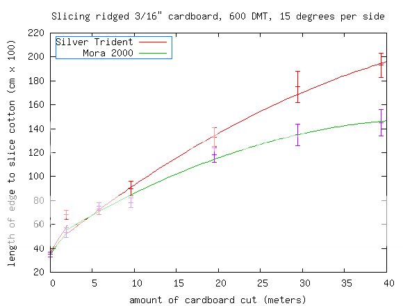

I used the Mora 2000 as a benchmark on the cardboard cutting performance by the Silver Trident. I had actually intended this to be a comparison of a high carbide vs low carbide steel showing the benefit of all the carbide in 154CM because it sure doesn't help in regards to toughness / grindability, however that isn't what happened :
The blades started out similar, but the Mora 2000 quickly pulled ahead. 12C27mod which is the steel in the Mora 2000 lies very close to the carbon saturation line at an austenization temperature of 1100 C thus it has trace amounts of primary carbides. However 154CM has a very high primary carbide fraction (17.5% chromium rich) so it should have a massive advantage in stock tests of wear resistance.
(anyone has any wear tests on 12C27, 12C27m, 13C26 let me know)
However looking at the edges under magnification they were deforming and showing signs of fatigue fracture with stress lines running parallel to the edge as well as pieces tore out of the edge, more than ten times the size of the micro-teeth left by the 600 DMT hone. Thus the wear resistance of the 154CM was of no benefit as it was just cracking apart.
The edge angles used here are very low, 10 degree primary for both blades and the 15 degree micro was only 0.1 mm wide, about 0.001" thick. There was little evidence of direct impaction which makes sense, but checking periodically the edge progress from a slight wave and progress to visible deformation and then tear outs. This seems reasonable give the very low thickness of the micro-bevel.
(yes I realize high mag shots would be useful here)
What would be interesting would be to see if RWL34 has the same performance. This makes me wonder if this isn't the reason why CPM 154CM had a significant increase over 154CM in the Spyderco CATRA tests. Considering that people are in general more prone to lateral loads in cutting due to the variance of a human hand, it would be expected that a greater influence of edge stability would be seen. The numerical details can be seen here :
http://www.physics.mun.ca/~sstamp/knives/silver_trident.html#edge_retention
I am also interested in 12C27m vs S30V (ideally AEB-L vs S30V) so a comparison to the South Fork seems reasonable as well as of course ZDP-189 which I have been meaning to do. That will just take a lot of cardboard as I want to do at least five runs with each blade for about 100 m each to map out the secondary blunting state in detail. That totals to about 1.5 km of similar stock cardboard. I shuld maybe include a Spyderco S30V in there as well and ideally the Swamp Rat S30V as well and see if there is any significant difference among them.
-Cliff

As the angles are very low the edges are deforming and seeing fracture. This may be due to the coarse grain and heavy aggregate carbides of 154CM.
In your review of the Trident then, when you say heavy aggregates, you mean heavy aggregates of primary carbides, as in it wasn't soaked hot enough to dissolve them? And what would be the cause of the coarse grain? Tempered too hot/long?
The grain is coarse by nature of the steel. The high alloy chromium wear based steels are especially bad in this regard in general. The primary carbides in D2 for example huge, easily 10 times that of finer steels :
I am being sloppy with grain here meaning it to refer to the austenite grain size and carbide aggregation. It would be possible to remove the primary carbides by high enough soaking but then you have to deal with the grain of the austenite coarsening, the effect on the hardening as all that dissolved alloy will induce massive retained austenite and of course it begs the question why did you have the alloy there in the first place?
Some steels work better than others at certain applications. You are usually better off picking an inherently more suitable steel when the standard heat treatments don't work very well because industry did design the steel for a purpose and has refined the heat treatements accordingly. Usually even if you do get it to work you end up having it be sub-optimal and vastly over expensive.
-Cliff
