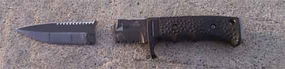

I reground the Trident to close to full flat over the past few days using a 200 silicon carbide stone, it was a very long process. With the apex of the edge reduced to ten degrees per side it was used for some cardboard cutting. The final microbevel (0.1-0.2 mm wide) was applied with a 600 DMT stone freehand at approximately 15 degrees per side. The blade cut 40 meters of 3/16" cardboard through a three centimeter slice before it stopped slicing newsprint cleanly. The sharpness was checked by slicing light cord as well and showed the same pattern as previous, very sharp then a gradual trailing. I'll need to benchmark another blade as a reference. I am think of SR101 maybe as it is the opposite type of steel used in large combat knives.
-Cliff
Did some impact work, I held the knife in a sabre grip. I wanted to simulate an unexpected hit, someone trying to knock the blade out of the hand. I intended to then actually do a forceful block as a follow up. No chance of that though as on the first impact on the spine the blade just cracked in half :
This was a light impact, not close to full strength and not even full body, just a swing from the shoulder. The crack runs through a serration and intersects with the point at which the top hollow grind hits the full stock. There is a really sharp point there at the apex of the grind.
-Cliff
May this high-carbon stainless tactical rest in peace. What did you hit it with, or what did you hit? Was the impact on the spine side right near the failure point?
Mild steel, 700 g, 12 inch long. The impact was light, the finish wasn't even scuffed. That general location was the target, as I wanted to avoid the serrations. I held onto it while Pat hit it. In an actual attempt to knock the blade out of hand the swing would have been many times harder, it wasn't a serious effort. My hand didn't even significantly move. The steel is much more coarse in comparison to steels like 52100 which are almost perfectly smooth to the eye in a break. This would be obvious though.
-Cliff
Cliff Stamp said:
I wanted to simulate an unexpected hit, [like] someone trying to knock the blade out of the hand. I intended to then actually do a forceful block as a follow up. No chance of that though as on the first impact on the spine the blade just cracked in half...
BWAAHAAAHAAAHAHAHAHA!!! :D
That's the only thing I could do when I read this. Jesus, that knife is a total piece of sh!t. It's nice to see it when someone actually demonstrates it, instead of rambling on praising it based on aesthetics.

I agree completely, Steven. My point was it's nice to see someone demonstrating this junk for what it is.

While the heat treating may not be on par with other production companies, the many problems with this knife are not specific to that aspect but to the design. I have also seen the same type of impact failure on a Buck/Strider Solution, Reeve Green Beret, etc. . High carbon stainless in general doesn't respond well to such impacts, especially when it has multiple sharp edges and focus points to concentrate strain.
I have recently used a Fiskars axe and while you can notice a difference in the edge performance compared to the Bruks, I would not describe it as harshly as your label. It easily takes the Bruks on a cost/performance perspective and with some hand tuning on the edge is actually competitive even at price. It is actually better than the Bruks in several aspects of design. The Fiskars is more in line for example with the ideal axe Cook describes in the axe book than the Bruks, aside from the bit being more of a soft wood pattern.
Back to the Trident, before doing this writeup, I did a search, local to bladeforms and net wide for feedback. The praise for this knife was in general high, usually as possum noted, based on a visual overview or specific to how it balanced in the hand as this knife is very light and neutral and some judge this as ideal for a fighting knife. This however as possum noted is not an opinion uniformly held. Personally it always seems to me that knives of this nature should be able to take heavy impacts and I see little value in high wear steels for that application.
