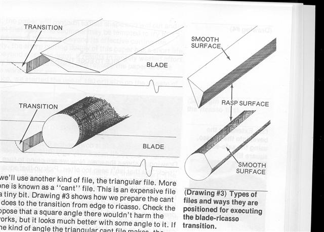

I've also been curious on the shoulder grinds.. would it be better to use a file to get the nice round shape? or use the belt?

I know that some makers also take a round file (1/4)and make the inital plunge cuts that way. You can make them nice and even. Then after you grind the blade you can use a dremel with a 1/4in drum sander and polish and even them up.
You can also use a round file to round the plunge. Just flatten one side of it, on the belt grinder platen, to make it safe. You won't scarf up the blade surface that way.
Chainsaw files work best, as they are not tapered.

I found the following, in a book I got today...
just curious if anyone uses this method..

I think people get too hung up on the plunge cut when they start grinding. Its really not that difficult to get a reasonably good plunge if you just take your time. Rather thah worrying about grinding the plunge in. Just form one as you grind.
Take your blade blank after its been profiled and turn the cutting edge up like you will hold it when you grind. Now scribe a line, or file a tiny notch where you want your plunge to start out.
Now start grinding and make sure that every pass starts or ends at that line. More than likely it will round itself out for you just through the course of grinding. As you get closer to finishing, the blade will probably be a little thick around the plunge, and thats the time to concentrate on the plunge, and grind it deeper or clean it up with a file.
The most important thing is to just get some time at the grinder without obsessing over the small stuff. It will all come together with some practice.
