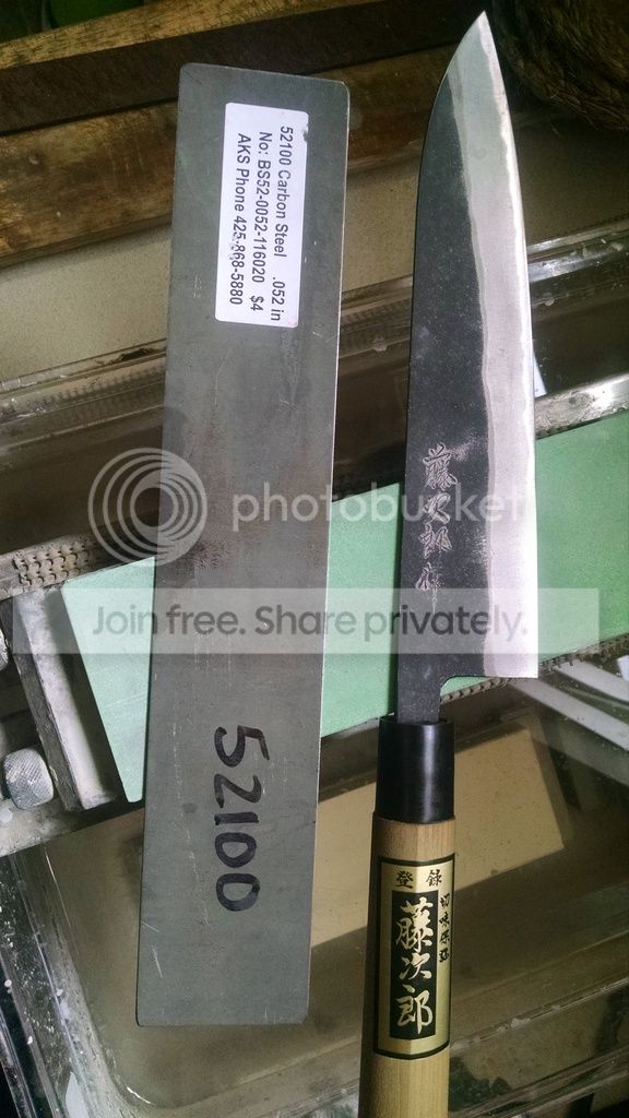

Hey guys,
I want to make a Wa Gyuto.
My plan is to cut out with a angle grinder.
Heat with a MAP torch on some refactoriy bricks, heat to bright cherry/orange hold and feather for 5minutes. Quench in warm(80°f) canola oil.
A few questions.

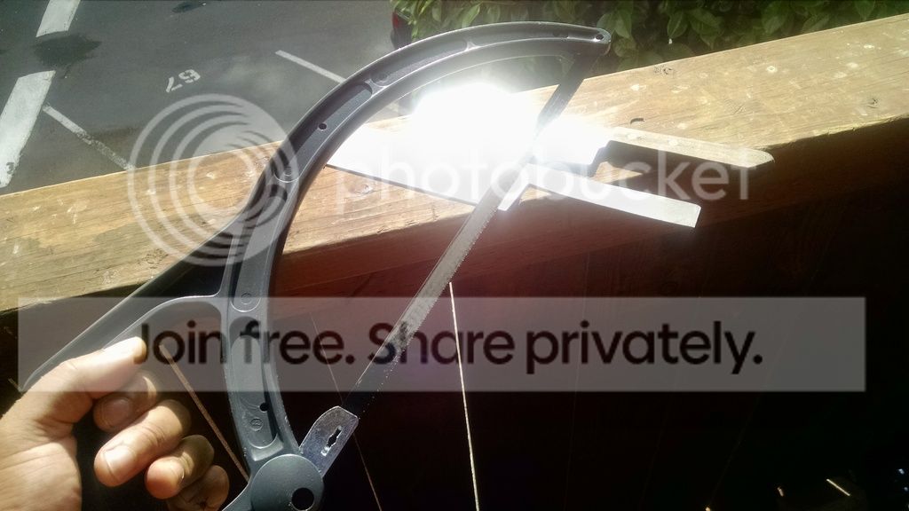

You can profile this thin 52100 easily via a hack saw + 1x30 36grit ceramic belt. Angle grinder is over kill (and unnecessary risks).
As bought is 0.052" - will be thinner than that as finished, so it's might be too thin for a gyuto WA handle.
52100 is a very tricky to heat treat and can certainly not be done well in a teo brick forge. It needs a long, controled soak and fast quench oil. Send it out, or use another steel.
Shawn that is thin to start out with. Even some paring knives are thicker than this .052. I like thin but that's a bit too thin for a Gyuto IMO

What's a good thickness for a Gyuto? .150?
At that thickness, you are probably going to have warpage issues even if you grind after heat treat.
I would go with .125" or .100". By the time you grind it, the blade should be even thinner.

I used the hack saw ,thanks blunt cut

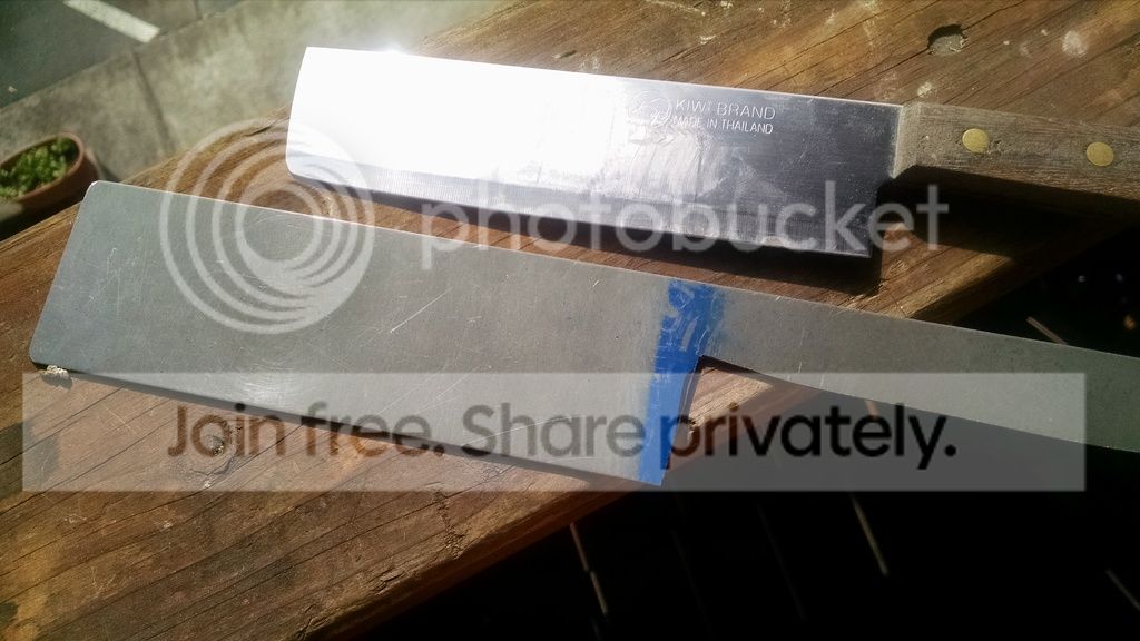

Shawn - that $2 kiwi is a very tough challenger to your 52100 nakiri. I've sharpened plenty of those Thai's kiwi veg nak.
To get a fighting chance, I would rather use a 3/4" mini torch. Heat w/ brush strokes about 0.5" above edge (avoid over heating). In a dark room, use high heat until just past decalescence, Continue to heat up another shade of red using lower heat. Try to keep at that shade for a minute or so (OK, this is for AKS 52100 not Aldo). Quench in warm canola with rigorous chopping motion back/forth for 5 seconds. Take out. Straighten your warp with 3 points via hand and or plier. Air cool. Wash. Toss in freezer for 10 minutes. Wash. Use a file to test hardness. If skated, temper, else repeat aust with a bit brighter red color.

Yea those kiwi knives are awesome.

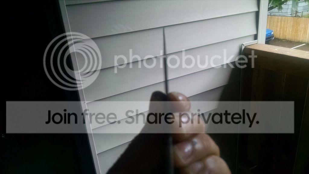

Here a video I took getting the steel even.
I then feathered it for 5 at a reddish orange.

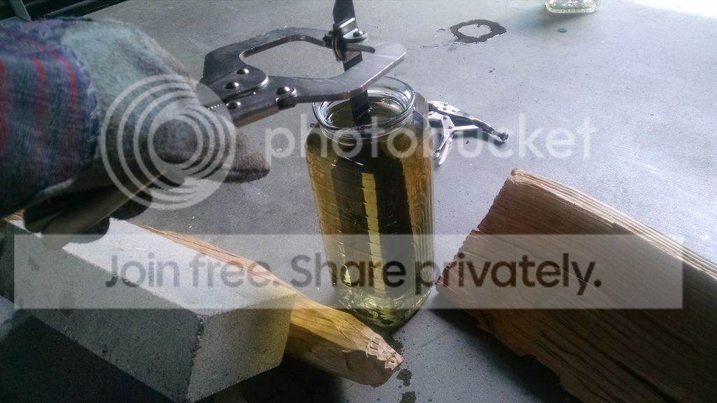

Quenched in warm canola I heated on the stove top to a warm temp.
I transfered fast.
No flame on quench
I held it in one place during the quench and left in until cooled to the oil. (30-40 sec)
Slight warping fixed in vice.
File checked good.

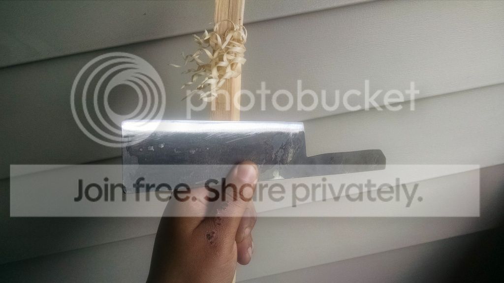

It's in the oven at 400.
I'm so nervous. Yet excited.
None of my knives have turned out great.
Using edge of file to test again for skating, again. Stationary quench most likely sub-par/failed in this case.
At ~1475F vapor jacket will be prevent sufficiently fast cooling to avoid pearlite nose. Here what vapor jacket for 1000F aluminum rod stationary quench in water look like.

I think it might have worked
Sharpens and cuts decent.
Vegetable oils like canola don't suffer vapor jacket issues. Is this still 52100? If so, canola oil will be plenty fast enough unless you do something to generate extremely fine grain sizes.
Edited to add:. That small container may cause trouble due to small volume but it it holds an edge you likely got what you were after.
