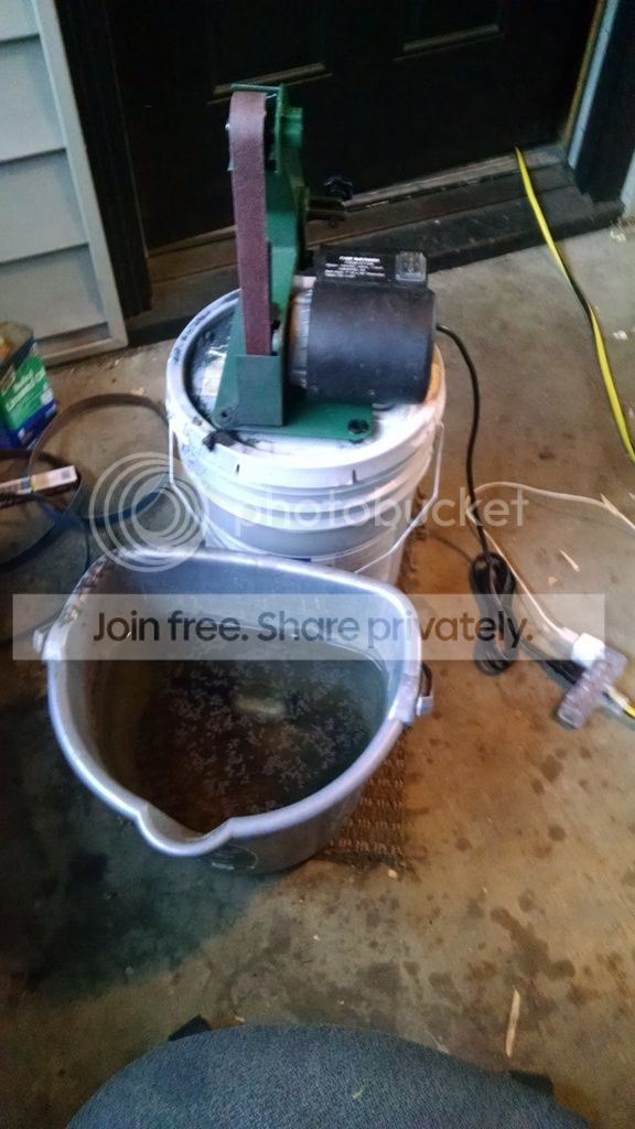

Just to be clear - are you referring to static or dynamic quench? Recently (my premature senior days) tripped(5 times) over PN in P50 (in big ammo can as tank) because of insufficient quench movement. I actually marveled how cool to see a smoke jacket around a blade for ~0.5s before small convection bubbles and then sub surface merged bubbles.

Vegetable oils like canola don't suffer vapor jacket issues. Is this still 52100? If so, canola oil will be plenty fast enough unless you do something to generate extremely fine grain sizes.
Edited to add:. That small container may cause trouble due to small volume but it it holds an edge you likely got what you were after.
Container size?

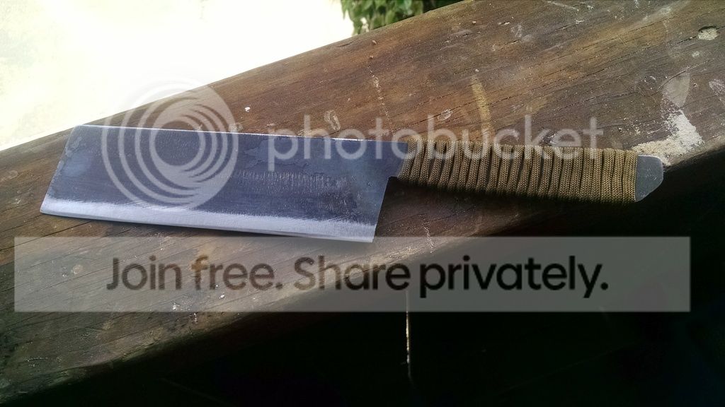

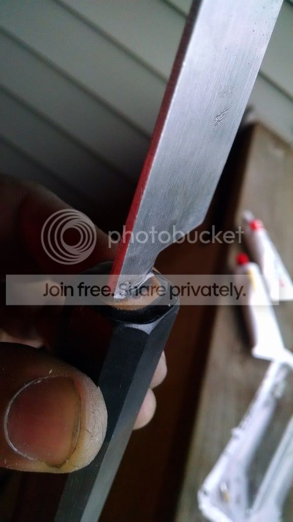

Ugly but functional

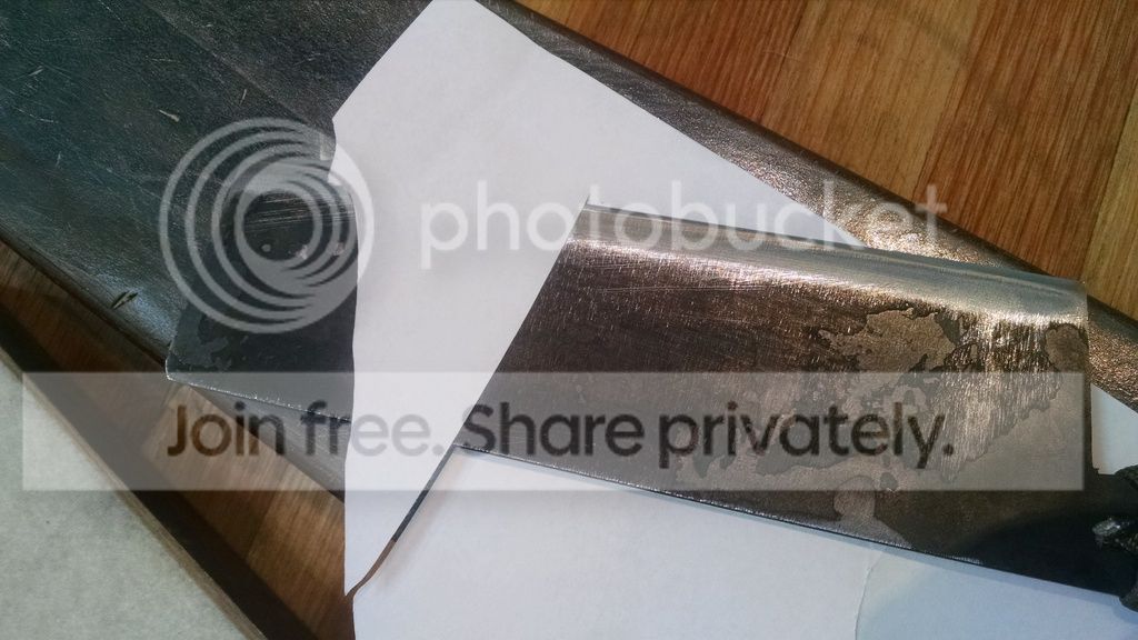

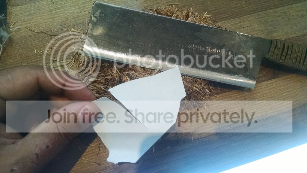

Cut 10 pieces of Manila rope, here's the edge on paper

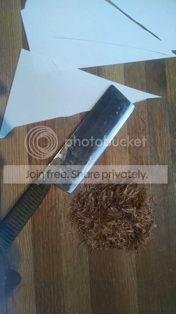

Cut ten more. Took more force. Edge could cut paper.but was dull
Stroped back on 1 micron diamond compound
[YouTube]AJFjUgZdjE[/youtube]
Testing on food

Generally a volume of 1 gallon is recommended as a minimum. The small volume could warm significantly and cool slower. Tough to say without hardness testing. If quenching many blades in one session you definately want a larger volume.

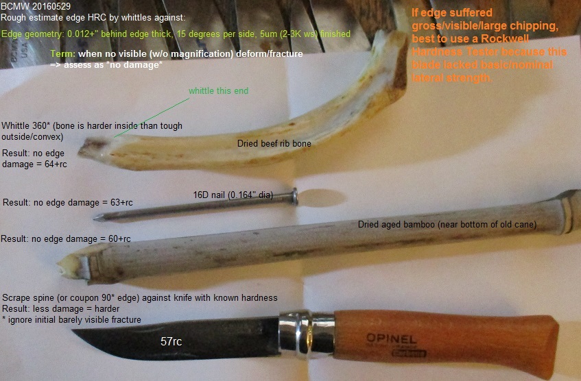

Shawn - don't fall too fast down the ht rabbit hole. Just in case, you need an idea of how your test coupons/blades rc & performance.
I usually can rough estimate hrc most of my test blades. At fatalistic time, I use 0.01"BET, 10dps edge geometry. Then I use the Rockwell to xref, if whittle result & tester reading don't matched. If actual hrc readings are lower than estimated -> my ht is going forward...

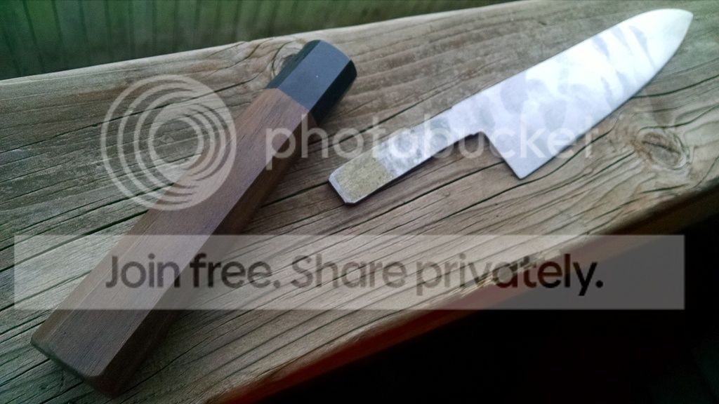

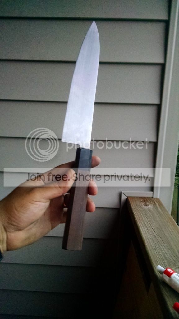

Took me two months but this I'm at currently.

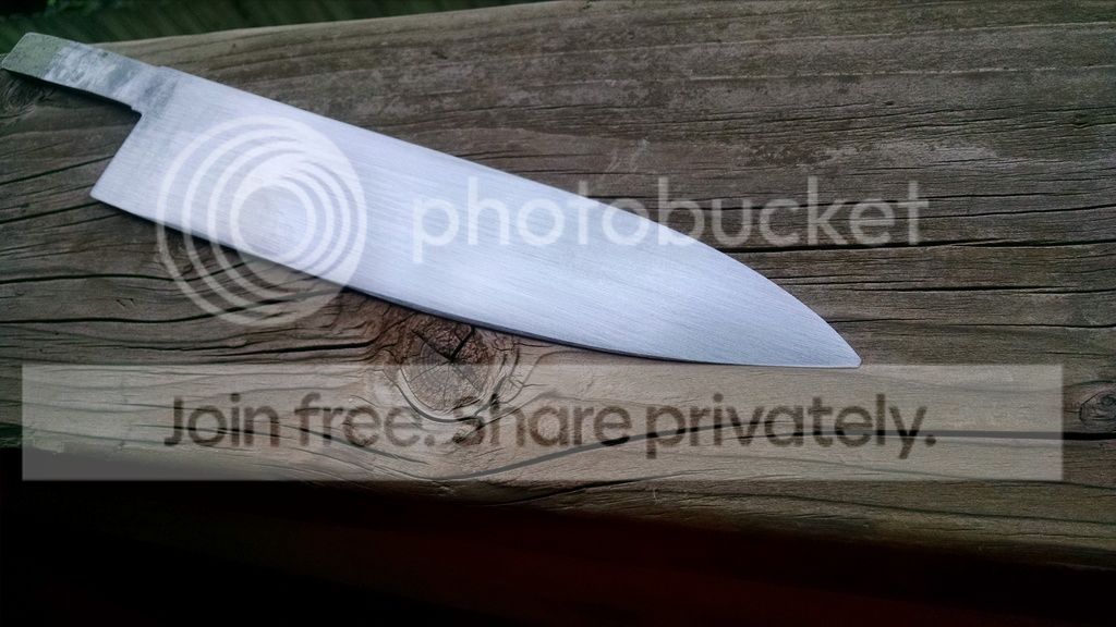

I used a piece of 80crv2 @.120 ish
Cut it out.
Heat treated it
Then started grinding
Took weeks on a 1x30 with the zirconia belts.
(Probably could have been done faster. But I'm a busy guy)
Hahaha not as easy as the thin stock. Was a total "Grind" hahaha
I still need to sharpen and finish it
