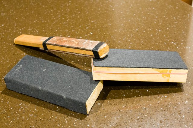

Firstly, some background. My partner has started a job travelling to LA and back which, after some struggles with a local blade, opened my eyes to the range of available items in the States. I got my money back on the heavy machete and now have access to some cheaper stuff like the Tramontina/Marbles etc. Of course, this research led me into sharpening which then led me to sharpening the kitchen knives and Leatherman, and then led me to "should I buy new knives while I have the chance?".
Now, I'm holding back from new knives at the moment (machetes will happen regardless and maybe a Small Forest Axe) but the sharpening is blowing my mind. Using Google to trawl hundreds of threads has left me dazed and confused.
I've narrowed it down to mousepad and wetdry for convex on pine blocks (what I had available and visible in photo. I made two to see how it turned out). I'll order sheets of sandpaper through Amazon as it will be cheaper than here. The mousepad is a very thin type with little give.
Then I figured, while I have access to the States, why not buy some stones that will last a good part of my life (considering the bug hasn't bit me too hard and I won't be sharpening all the time). This I narrowed down to the Atoma 140, Shapton Glass 500x2 and Glass 2000. I'll learn with the cheap Mundial kitchen knives at home.
The strop has me worried. Do I continue using the pine blocks, and buy some of the good leather from Amazon (probably the Hand American will get me two strops) or do I use balsa that I should be able to find somewhere here? I made a field strop from a belt thinking I would combine it with sandpaper, black and green compound for touchups on the potential machetes (visible in photo). The compound I will also buy from Amazon or online US-retailer.
So, the question is, balsa or leather? Chromium oxide or one of the diamond pastes or sprays? What strop(s) and compound(s) should follow a 2000 glass if I happened to possess one?

I would take balsa over leather and 1 micron diamond over any other compound.
By Shapton Glass 500x2 do you mean two stone?, if so I would recommend the double thick 500. It gives you double the stone without doubling the price.
After the 2k I usually only strop on my pant leg or on blank printer paper, I just like to remove the burr here because the 2k yields a nice toothy-polished edge. Easily stropped to insane levels of sharpness though.

Stick with the glass stones and the Atoma, it's what I use and my customers are very happy. The 2k glass produces a great edge by itself and no, a strop is not necessarily needed but it can help with softer steels that hold a burr much longer. One of my favorite strops is to take some denim and stretch it over a board then apply some Mothers Mag Polish, yes the stuff at the auto parts store. Please remember, when I strop it's only to remove remaining burr, I do not strop to polish the edge.
I would probably wait until you got your stones though, stropping can turn into a crutch real quick. Learn to get good sharpness from the stone and how to reduce the burr with light pressure. Once you can do this stropping will be beneficial and you will not rely on it for shortcomings on the stone.
I'll add a 'ditto' to Jason's recommendation for trying a denim-over-wood strop, with Mother's Mag or other aluminum oxide-based compounds (that could include many 'white rouge' stick-types, or Flitz/Simichrome polishing pastes and others). I've also had very good results using linen-over-wood, in the same manner.
As for leather, my favorite leather strop has also been the simplest: one of my leather belts used as a hanging (barber-style) strop, with some green compound applied to the inner (sueded) face of the leather. That one has worked very well on simple steels like 1095, CV and 420HC; something similar should also handle the machete's steel pretty well.
Also 'ditto' to his advice re: work on getting good edges on your stones, and using them to clean up and minimize burrs, prior to stropping. I've arrived at a place now, where I'm relying less on my strops and getting crisper and sharper edges on my hones and stones, with minimal or no stropping needed. That's a very happy and rewarding place to be... :)

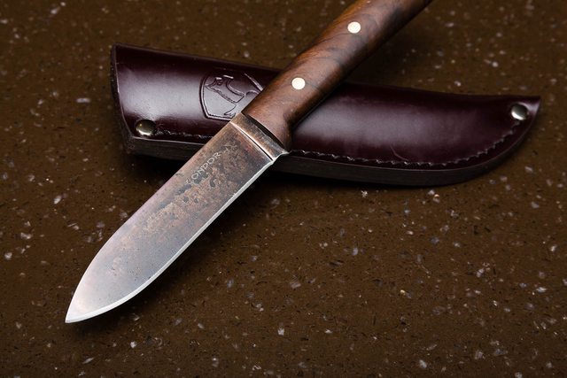

Received a Condor Kephart and ran it over a 220-2000 mouspead setup with a dry leather strop to finish and it's cutting paper reasonably nicely.
I think, knowing now, that I could have done a little better in each stage but slowly got the technique up in the 1500 to 2000 range.
Happy with the effort and I now have a very sharp, convexed Kephart and will buy some stones and attempt the kitchen knives in the future.
Thank you all very much for your guidance.
Brought in some Mother's Mag as per suggestion but don't have a pair of denim jeans for the scrap heap, nor could I find any, and went with a length of balsa. Sanded it, cut it to 9 inches, same length as the sandpaper block and gave it a crack. A 9 inch block also fits in a heavier duty resealable plastic "lunch wrap" bag so it stays out of the elements, lucky for me.
Well, I have a near mirror polish now but lost a tad sharpness due to angle/technique issues (my fault). Cut up some dinner with it for a test (it doesn't cut carrot lengthways interestingly enough, it just forces it apart), and then I put it back over the balsa and got it sharp again.
There is one part of the blade I can't get the factory scratches out of it, both sides (edge is sharp, shoulder doesn't match the rest of the blade) so I don't know what I'm doing wrong there. Just doesn't make contact with the paper enough, no matter what angle. Marker pen is removed, but doesn't get far enough back to really shine it up. About 1/3rd up from the heel, both sides.
Besides that...oooh shiny!
From what you describe it sounds like a small recurve set in by the factory. This causes a low spot in the edge and the reason you are not able to grind it out. Best way to fix it is by cutting into a stone with the edge to make sure the edge is properly shaped and has no gaps between stone and edge. Next, use a very coarse and flat stone to regrind the bevel, you will probably notice the grinding skip right over this trouble spot until enough steel is ground away that it becomes even again.
This is a very common problem in factory sharpening.
