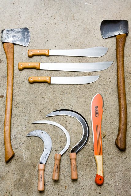

Ordered all my machetes so some new files are on order too as the Nicholson I got has already rolled the teeth. Pferd may be on order when I get around to it.

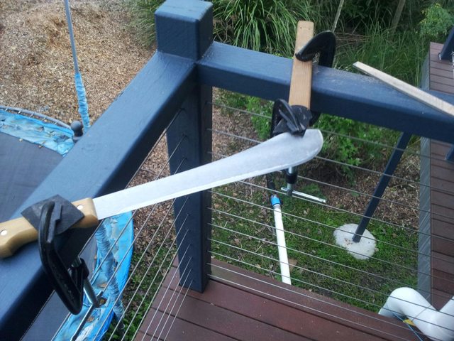

Used a 12 inch single cut smooth file to shape and rebevel, all the way to the tips on the Tramontina machetes and then tidied up with the mousepad block as I'm still waiting on the stones. Very sharp now and pleased with how good I got it with just the file. Running it over the mousepad enhanced the sharpness to a significant degree. Not too concerned with the overall sharpness with basic clearing tools (I know they will hit the dirt/stones). Also filed the scales flush and began treatment on the handles with BLO and turpentine. No mods on the machetes, bar a change to a convex style edge and sharpening the tips.
