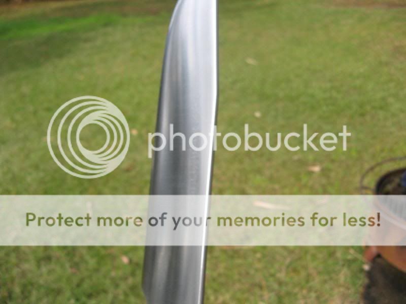

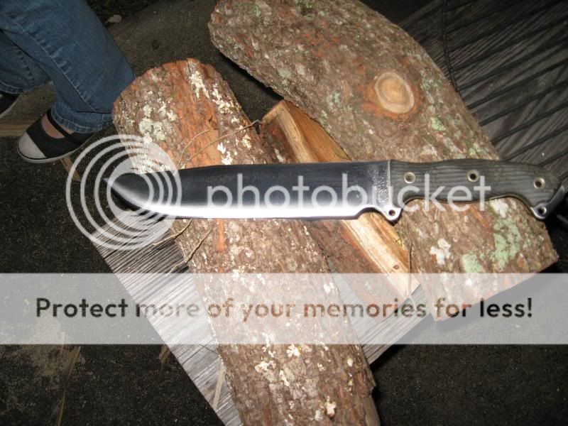

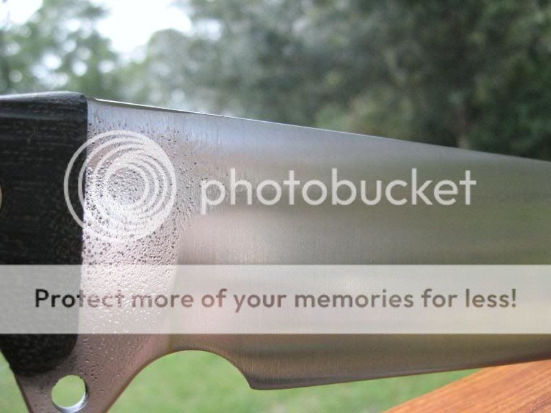

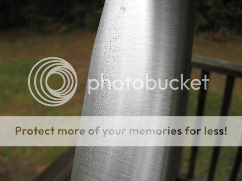

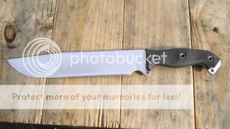

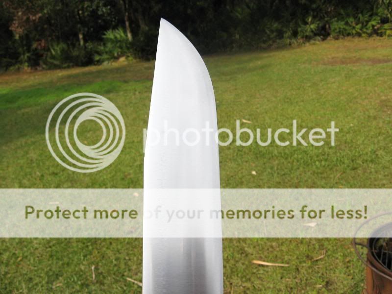

In the morning light, I did a little more sanding on the BWM. Horton says he can get a satin finish on INFI in 15 minutes on his machine. Not on mine. After 3 hrs sanding, the dimples are still visible, as is the little hole or dent.
So I just went to 180 and then 400 grit and smoothed things out and gave it the Scotchbrite wheel treatment. Ghetto satin it will remain. :D

HD, By the looks of that last picture like Lil' foo said your knife is getting smaller. Man your going to have her whittled down to nub.:D She looks fine.:thumbup:
How did you do the ricasso and butt? I know I can't do flat griding like that on my HF, it chatters badly. :mad:
I'd have to remove the scales and use the platen to sand those. I never do that on Busses. Mine are just brushed with Scotchbrite. Let those dimples shine!

I never striped a blade, a question does the blade heat up when you do that how do deal with it in order to avoid messing up the heat treatment?
Some steels heat up fast. But on a big blade in INFI, it only gets warm. No problems. My bare hands are holding the blade, so I can feel any heat build up. I keep a bucket of water nearby to cool the blade if necessary. Smaller blades will heat up faster. Some other steels tend to heat up fast, too, but not INFI.
+1. You can get some heat build-up while working near the tip, otherwise the mass of metal absorbs the heat. The only time I have had a blade get really hot is when I was using the disc sander to grind a clip point onto a SARSquatch, and really pushing it against the disc. Then the water bucket was needed.

Nice work Horn Dog. Those last pictures looks to be a great balance of satinning and refraining from removing too much stock. The remaining INFImples give it a nice rustic look.
